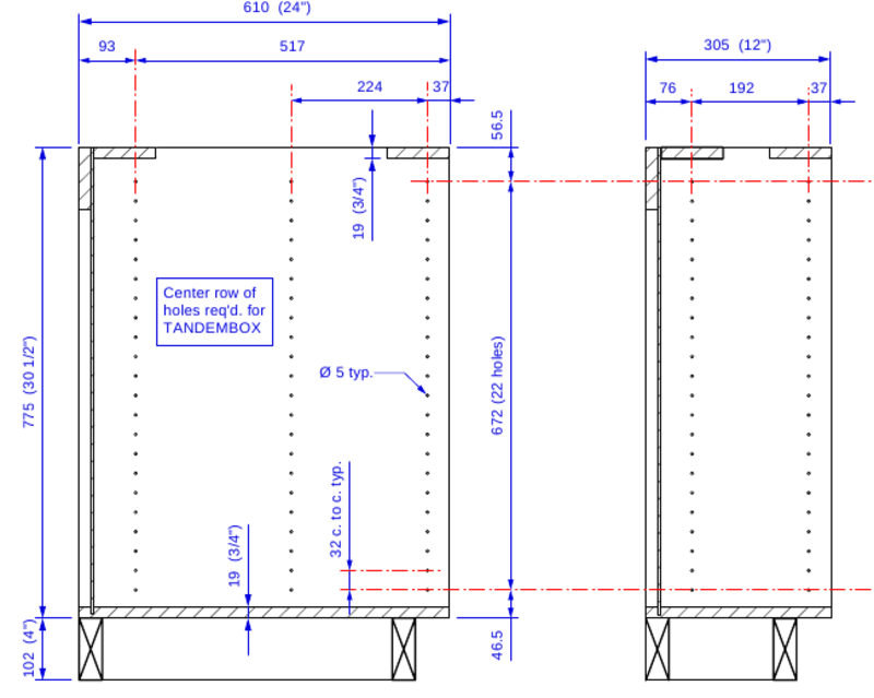

We are just getting underway with manufacturing our own cabinet boxes. Where can I find dimension details for dowel frameless construction for all standard size cabinet boxes? I'm having trouble finding that information without getting into software that is way more than we need at this point. Any help would be appreciated.
5/5/18       #2: Dimension Drawings ...
There's a Blum book that has all the standard dimensions of classic Euro boxes.
True 32 has a American version with a few minor modifications.

Either buy software, or google Blum Pearls booklet and figure it out. I really dont think there is a book written that spells it all out, but I could be wrong.

on another note i use a simple box generation program called cabinetpartspro cost 250.00 and generates decent code once dialed in with parameters needed.
5/7/18       #10: Dimension Drawings ...
james e mcgrew Member
then again you can always just google it !!
https://davelers.com/32mm/Systems/3872.html
View higher quality, full size image (800 X 639)
http://https://www.google.com/search?q=32mm+cabinet+dimensions&source=lnms&tbm=isch&sa=X&ved=0ahUKEwiF0Zya4_PaAhWOdd8KHWiqDtoQ_AUICygC&biw=1920&bih=949
