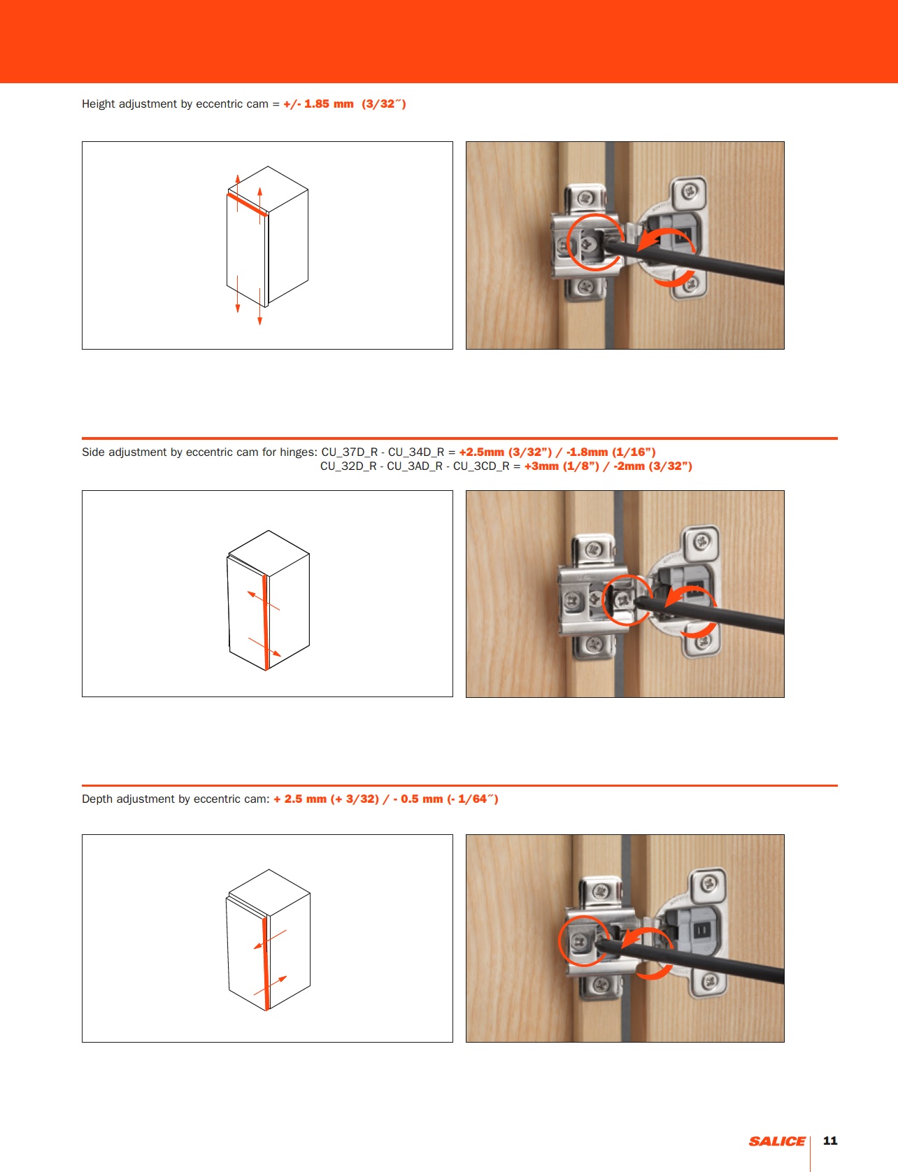

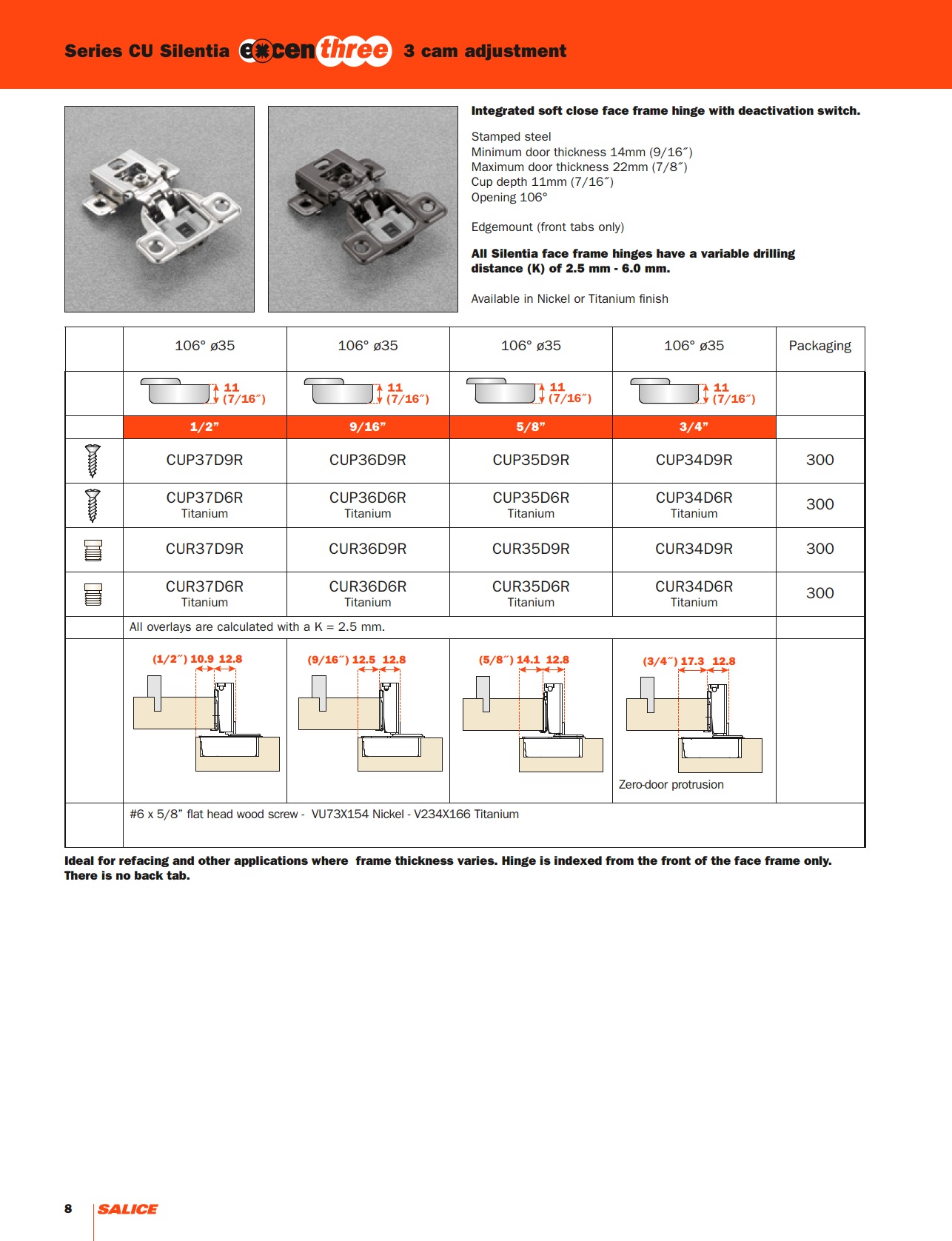

Hello Daniel,
I may be a little bias on this topic since I have worked for Salice for 24 years. Here are a few of the important features of our soft close face frame hinge that make a technical innovation and a value product.
I believe you will be very happy with our soft close face frame hinges as well. If you would like a few samples to try, please send me your address.
Thank you for using our other products.
• Available in overlays from ½” to1-3/8” overlays
• Available with 2 or 3 automatic cam adjustments
• Available with 1 screw option (With2 cams).
• Available with 2 screw option (With 3 cams)
• Available in nickel or Titanium plating (Similar to ORB finish)
• Side-to-side adjustment (+3mm, -2mm)
• Variable edge bore distance (TAB) from 3mm to 6mm
• Eliminates butt door gapping issues.
• Height adjustment 2mm
• Depth adjustment
• Easy to operate soft close adjustment switch
• Increase or decrease the speed of closure.
• Soft close always remains even when both hinges are turned “off”
• Silentia mechanism eliminates “door bounce”
• Consistent closing speed from one door to the next
• Cup depth of 11mm (7/16”) allows for use in heavily profiled doors.
• Tight turning radius for ALL overlays permits smaller gaps between doors.
• Suitable for doors up to 7/8” thick.
• Impervious to temperature extremes.
• Zero door protrusion.
• Lifetime warranty

View higher quality, full size image (1286 X 1676)
View higher quality, full size image (1284 X 1676)
