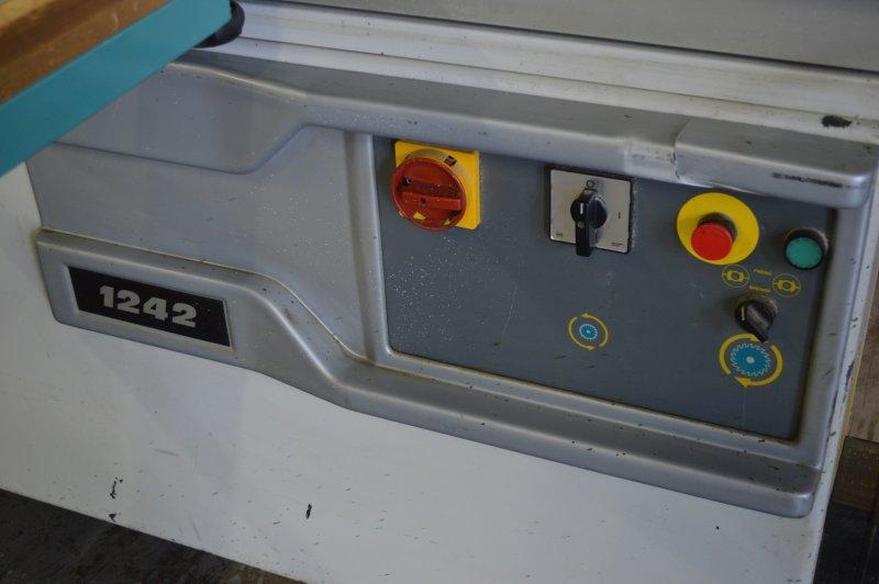

I just purchased a sliding table saw and when I have the switch turned to the run position there is a lot of resistance if you turn the blade by hand but it does run. If I put it in what appears to be the brake position it turns freely by hand but doesn't run.
When it is running it is only pulling 13 amps which isn't a lot so I am just seeking information as to whether it is normal to have the resistance when the motor isn't running.
The picture shows the control panel and the position that I have the control set when it's running.

check all electric leads for a loose lug sounds like not getting full electrical contact

That sounds normal to me. I have a SCMI shaper that works the same way. In the run position, the brake turns on when the machine is shut off, thus stopping the cutter quickly. In the brake position, the brake is actually off, so you can spin the blade easily. It makes set ups easier. I assume it's the same for a table saw.
