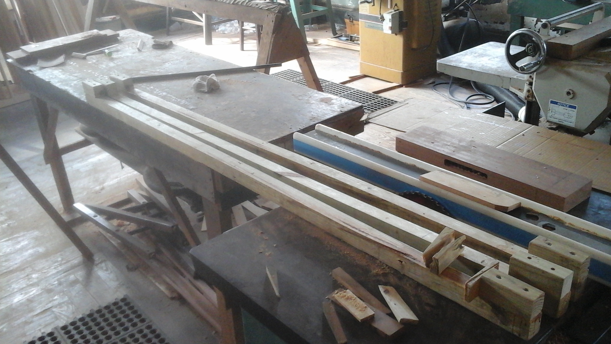

i use homemade clamps on every thing . make them as needed.
cabinet doors i use 1x2 flat to door . easy to stack a batch of doors and light weight.
entry doors i make as needed usually 2x2 or 2x4. blocks glued and screwed. make wedges a bucket full at a time.
wax them on surfaces that touch wood before use.

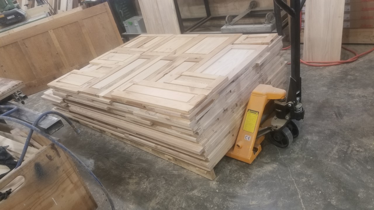

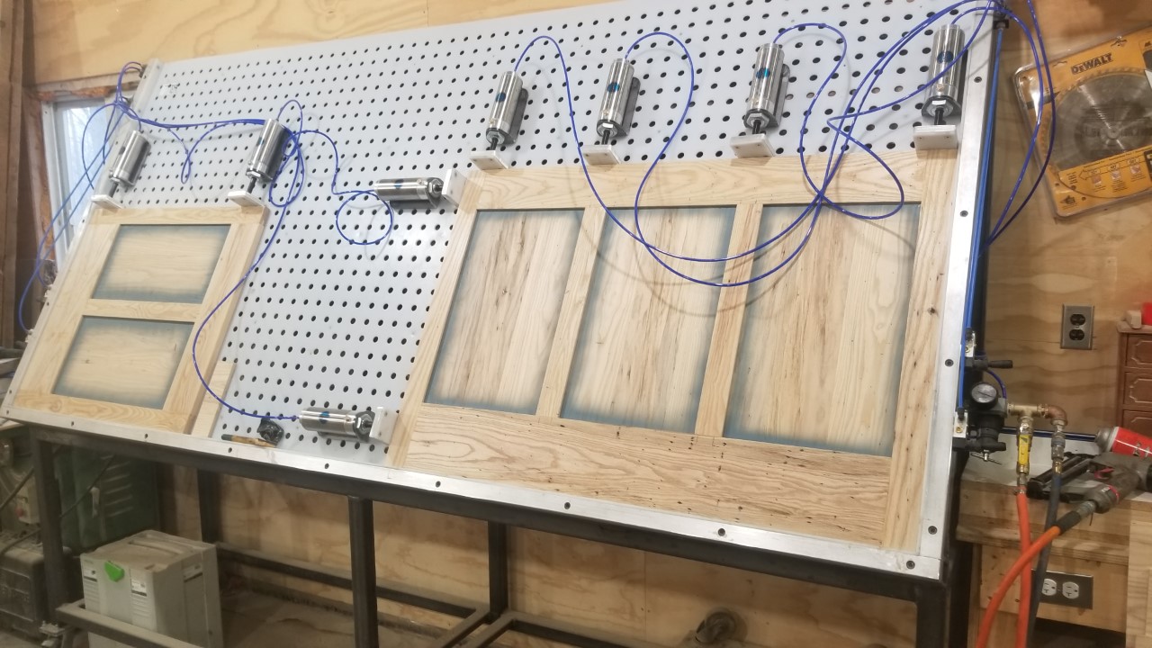

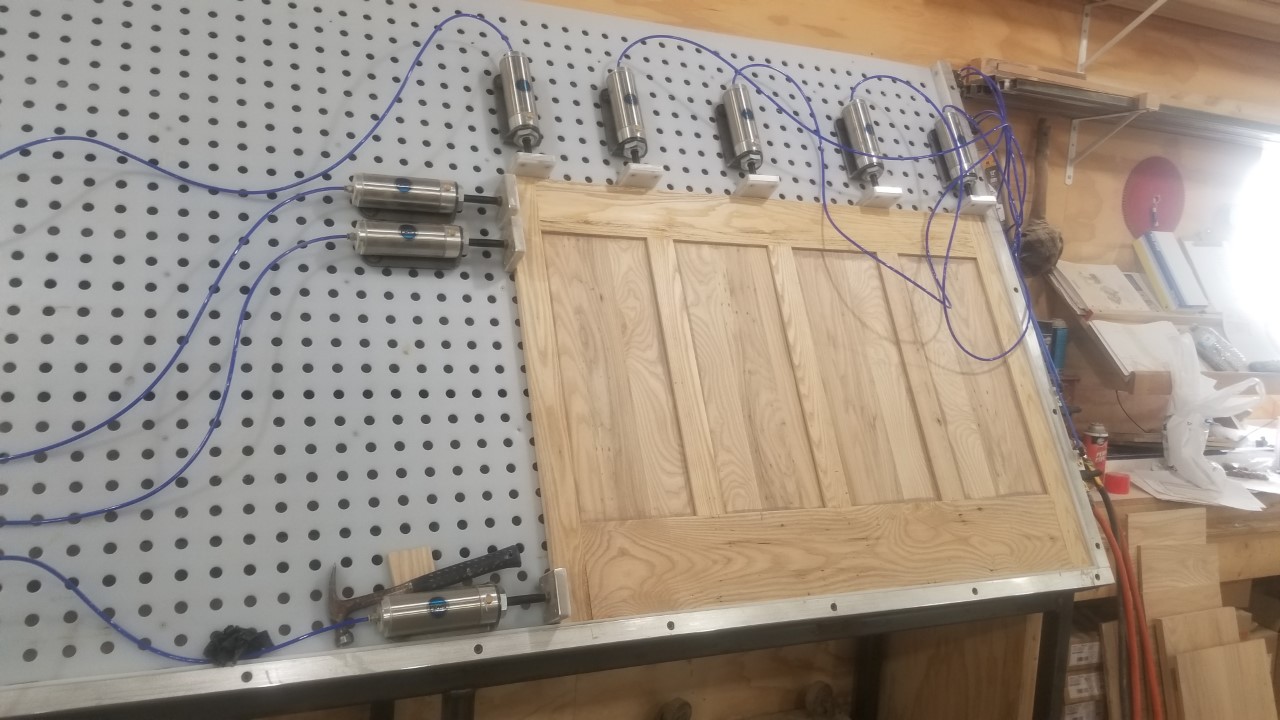

Built my own clamp last winter. Its similar to a ritter but has a few other options that I liked put into it. Eventually I may do the faceframe bar on it but after playing with the idea I still think I can save money by doing them flat on the table like I have for years. Cost me about 2500cdn to build including everything. Takes just 10.5' in length and sticks out from the wall 28". I have no built shelving and drawers on the bottom for storage as well as a racking on the back side for jig figures I don't use very often! Its on casters so it rolls around the shop easily if I need it too. The first run of doors was 278pcs and previously it would have taken me at least 6 days to glue up...I did all these in 2 days! so it pretty well paid for its self in the first job!!!

its all steel construction. Table its self is 1/4" with over 1500 3/4" holes! unfortunately I have way to many hours in research and design to just give my cad files away...Sorry!

even with the 1/4" steel + 1/8" uhmw (for easy glue clean up) the table still flexes in between the bridging areas when the clamps are under pressure...I honestly don't know how one would go about using a composite material that's thin enough, yet strong enough to make the cylinder locking mechanism work so they stay flat and parallel to the table when under pressure....Without the lock they want to lift up and out of the table.
