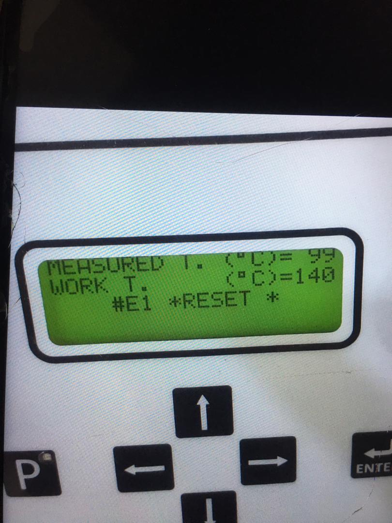

Mimo55 Member
Hey guys , I have bought brand new minimax me 35t , and i install everything based on the manual, the machine turned on , display but when i press the start button it doesn't actually turn on. i have checked all wiring it seems fine, i switched the terminals as i was suggested and still the same.
i live in Africa so i can not get the support team from my ITALIAN dealer easily i need to deal with it first. its brand new machine.
so i connected a1 a2 a3 and N , in the manual its says something about grounding. does anyone tell me if grounding is a must on edgebanders otherwise it doesn't turn ON. ?

Roy Cameron
Do you have the air line plugged in?
