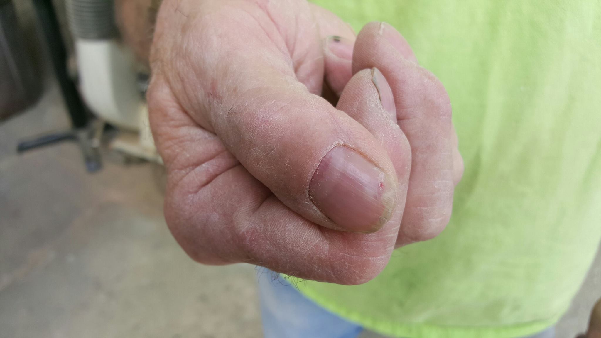

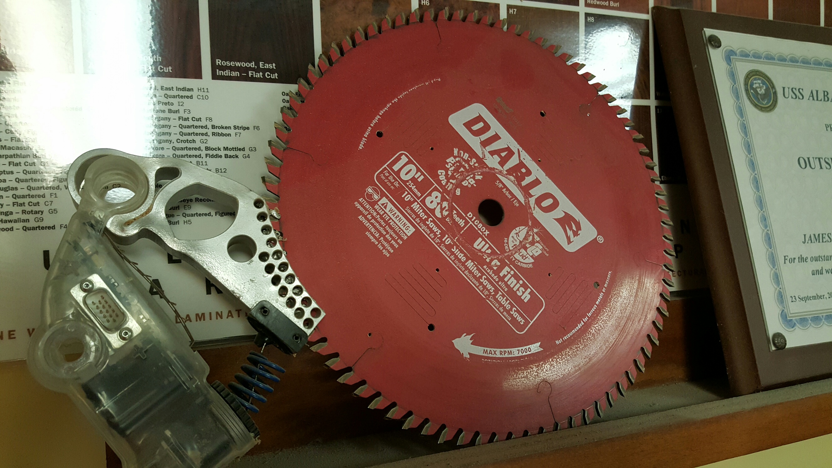

james e mcgrew Member
Curt is a 30 year Veteran of some of the best woodwork done over many years with Southern Architectural, Specialty, Peralta, along with hundreds and thousands of First Class Best quality work jobs in his Career,
But the Best day with Him I will ever remember is the day he looked up at me with a big (Rare) Sh!t Eating Grin and said "Man thanks for buying that saw"
Not sure i would exclude myself from "It will not happen to me" But i will keep those who do in my Prayers.
Mind you I split my thumb in half twice over 364 days, It was at that point I bought a CNC and went to Saw Stop.
