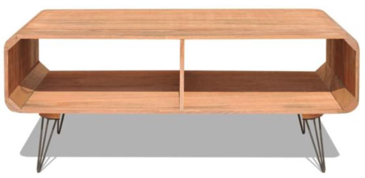

An upcoming project is a coffee table. Design is basically a box. Top, sides and a bottom ca. 8" under the top. The four corners are 3 inch 1/4 rounds,like one would use on kitchen cabinets. My 'headscratcher' is how to clamp the thing.If the corners were square, no problem, but rounded? Any tips or suggestions much appreciated. Thank you

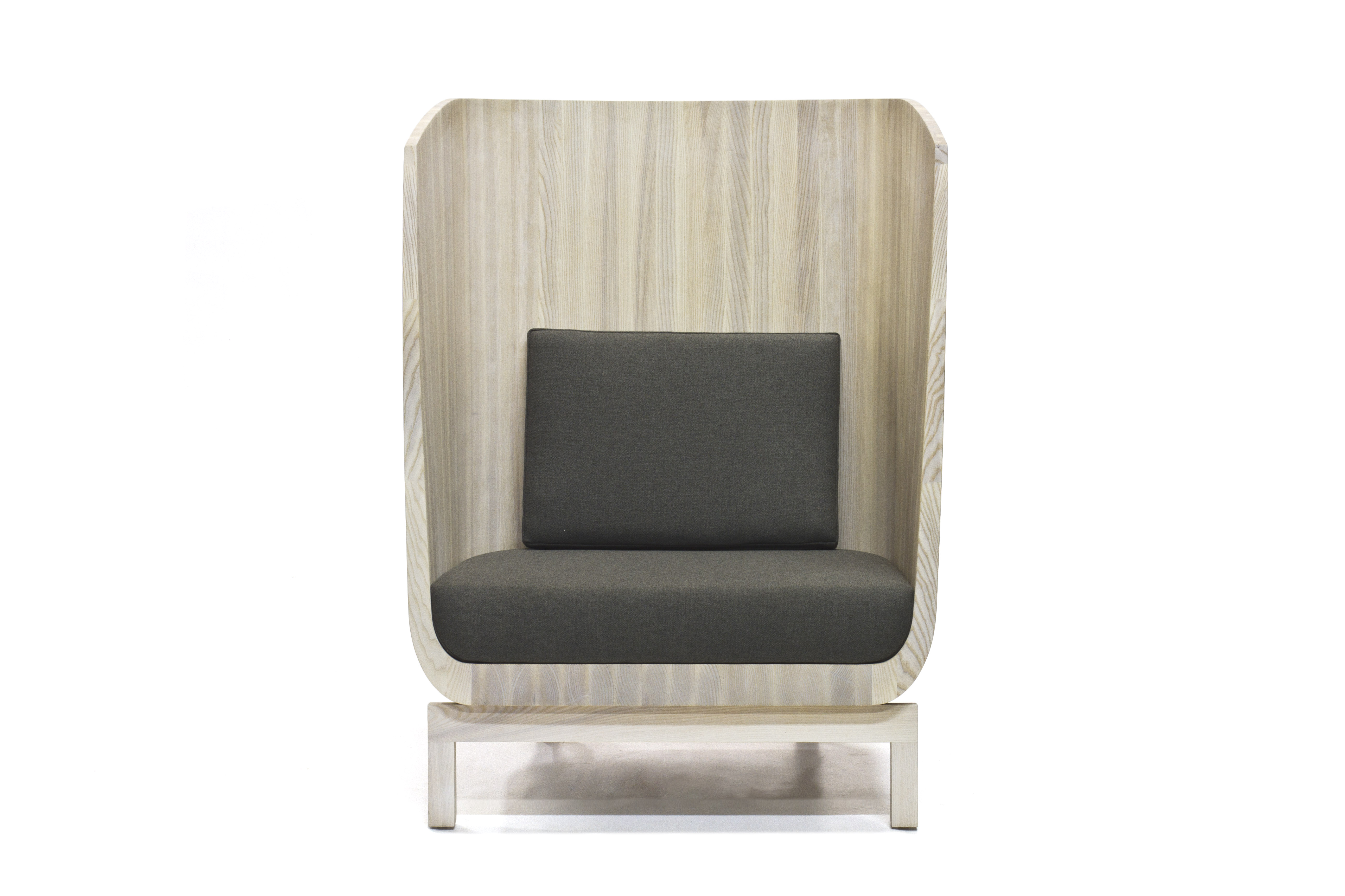

I'll throw this alternative out there for consideration if this will be more than a one-off project, or if you clamp miters/bevels on other applications regularly (column wraps, waterfall counters, etc). We have plenty of customers using Lamello P-System connectors to effectively clamp components in any angle. The pics below are from a customer of mine in Wisconsin who glued up this staved-construction chair using Tenso P-14 connectors. They clamp with 35lbs of pressure (plenty for glue squeeze out), so traditional clamps or straps are unnecessary.

Henk Cusveller
Dear responders
Thanks so much for your suggestions. Seems that for me the straps are the way to go. Will make a test piece tomorrow to see how it comes together. Biscuits for alignment and panels to keep it square. Exciting times ahead.
