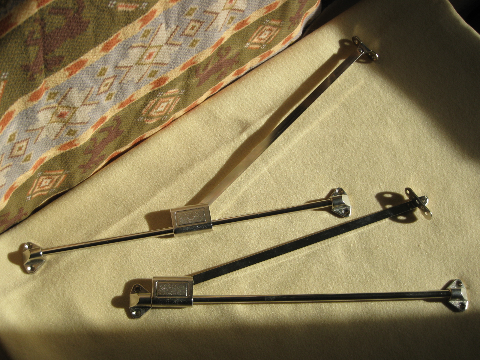

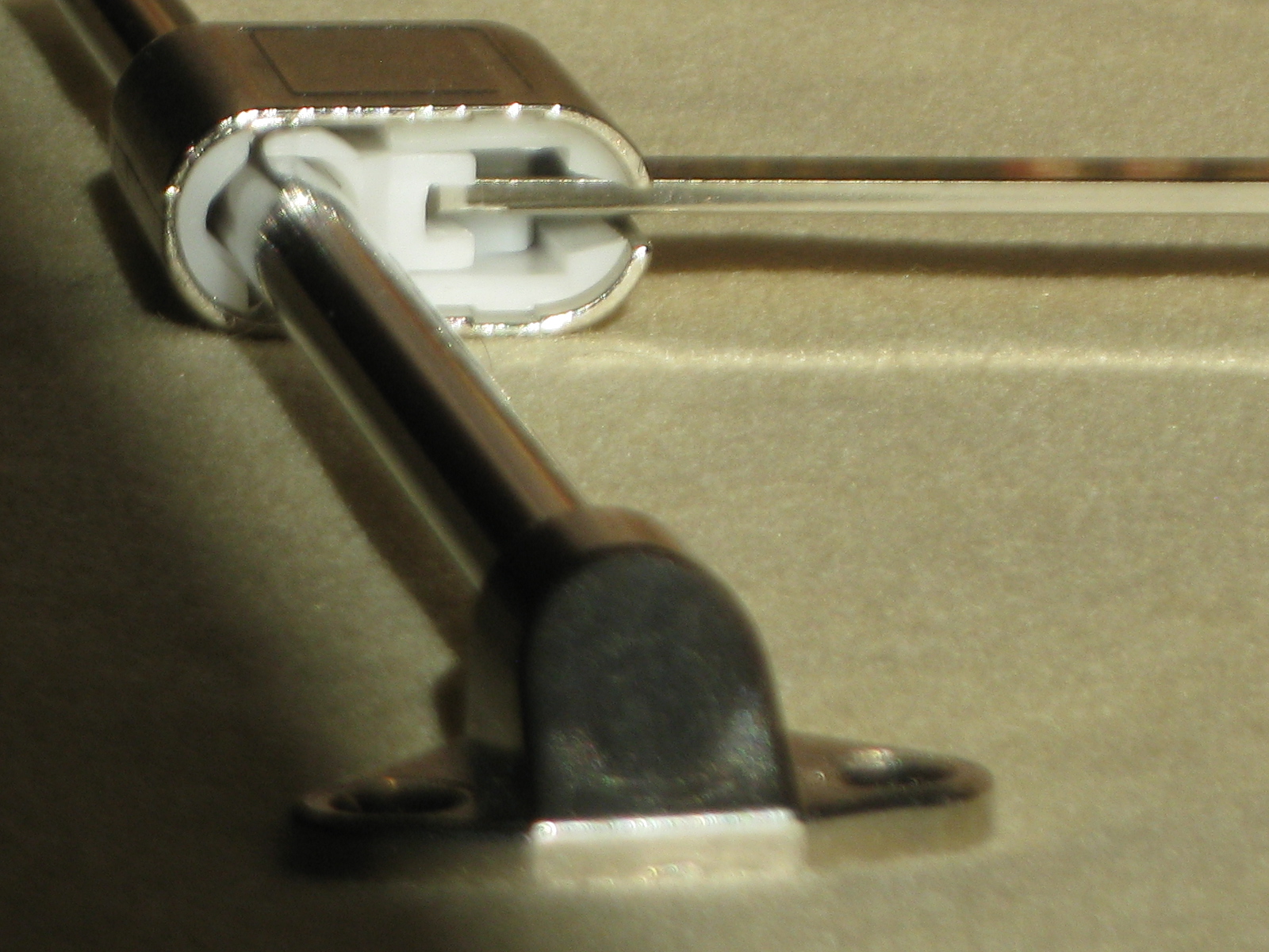

Anyone recognize these 2 identical pieces of mystery hardware. Found them while cleaning out my Dad’s house. Feel like they might be useful to someone, but don’t even know what to call them. All metal appears to be stainless steel, good quality material and manufacture. A 12 inch cylindrical rod between two brackets has a sliding arm whose position on the rod can be adjusted with a screw that presses a plastic bushing tight against the rod. The sliding arm is flat, not cylindrical, with its own bracket. Hard to imagine what configuration of surfaces these brackets would screw into other than a corner. Hoping someone will recognize them and say “That’s an adjustable cabinet door hinge to fit a variety of situations.” Whatever the case, I would appreciate any thoughts.

It's a lid stay, like this ...

Thanks Mark B for your prompt, succinct, and informative response. Mystery solved!

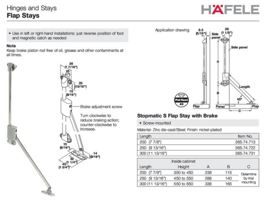

Mark B is correct, though he linked to a Chinese knock-off of the original part. What you have is a Häfele flap stay, meaning that it supported a drop-down door that was likely a writing or work surface. The photo is a screenshot of the item from the Complete Häfele catalog. I mention this for the benefit of future viewers of the thread.

WAY helpful Scott. The Hafele catalogue page downloaded via your link makes the use of this hardware much more clear to me. Rather than donate or sell them, I will likely retain these for my future use. I also prefer to support US vendors when able. Many thanks.
