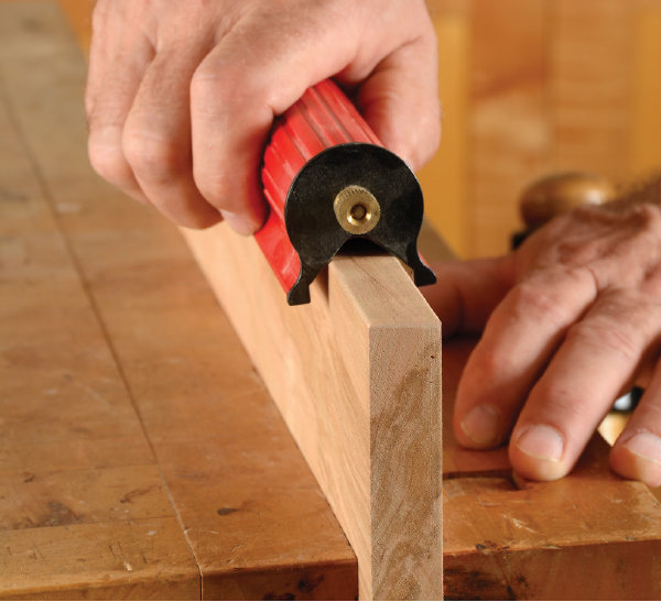

These work pretty well. Quick and easy. Not sure the name of it, but can be bought at woodcraft or online. If that thing is not handy, I just use a piece of 180 in my hand. Probably quicker than a sander.
View higher quality, full size image (600 X 547)
