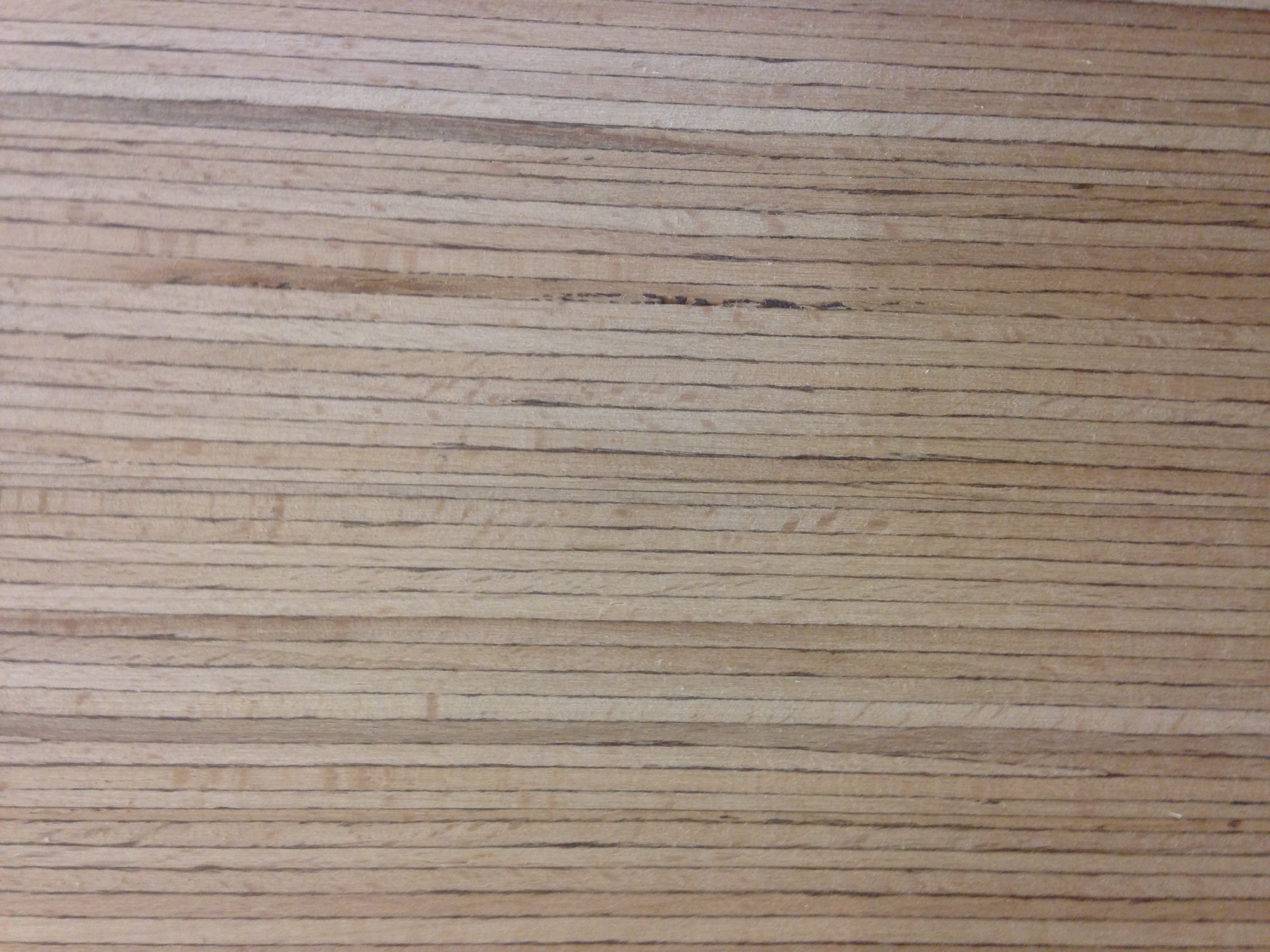

I've used a material called BauBuche for garage, kitchen, and commercial countertops. It's a laminated beech product from Germany that comes in 25" x 130" panels, 1.25, 1.75, & 2.25" thick.
Very stable and hard. It's cheaper than the maple butcher blocks too. My lumber distributor, Intermountian Wood Products carries it, not sure if it's available in your area.
