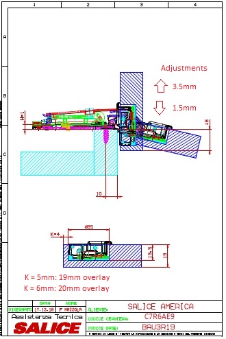

This is an easy application for Salice soft close hinges.
The attached drawing shows an 18mm overlay with an edge bore distance of 4mm. You could do this and adjust out 1mm or you could use a 5mm edge bore and have a resulting 19mm (3/4”) overlay. If you chose option 2, you will still have 1.5mm of outward adjustment for fine-tuning in the field.
Also, with Salice, you could also use a 6mm bore distance and have a 20mm overlay (13/16") with all adjustments still available. (Adjustments: +1.5mm, - 3.5mm)
Items:
C7R6AE9 110 degree, full overlay, soft close with dowels
BAU3R19 1mm face frame mounting plate (with 2 cam adjustments)
Let me know if you would like samples for a mock-up.
Best of luck,
Dennis
