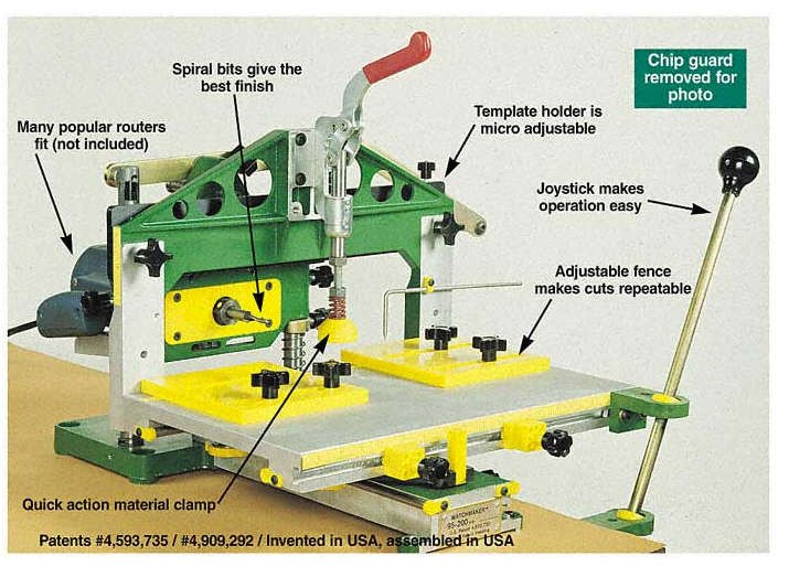

Scott
How about a matchmaker from woodoworkers supply.
View higher quality, full size image (715 X 523)

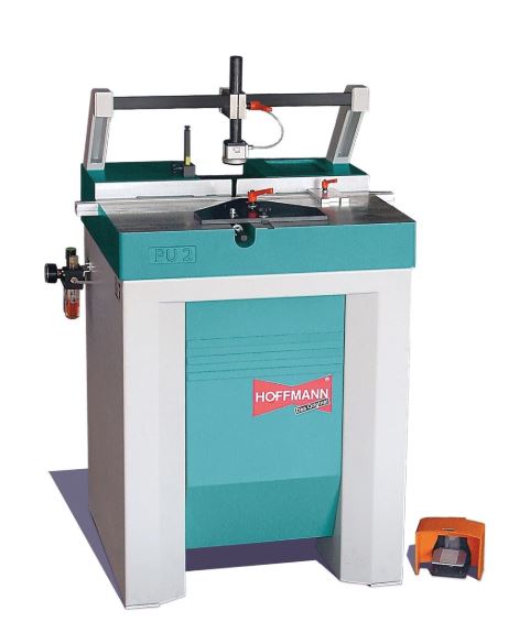

james e mcgrew  Member
I have a Hoffman
View higher quality, full size image (481 X 575)
