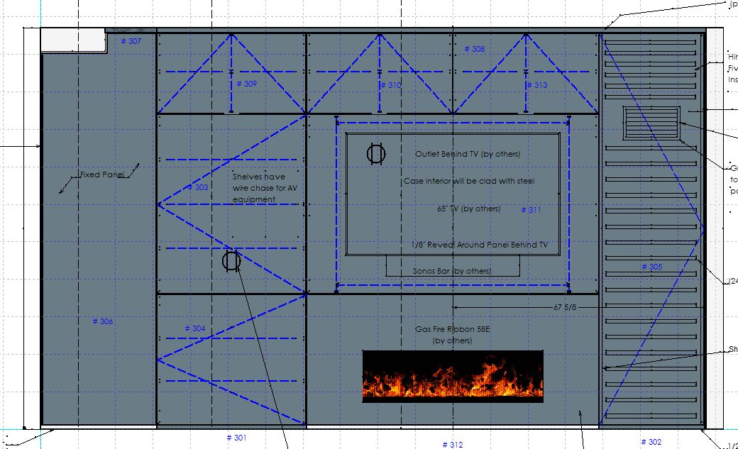

Hey All,
These doors have 5/8" melamine backs that are clad in 16 ga steel. The cabinets will be used for storage of AV equipment adjacent to a fireplace

5/31/19       #13: Wide Heavy Doors ...
MarkB Member
As long as the melamine is not suspect I wouldnt be concerned about warping and even at the weight your talking, with Dennis' response I'd say your fine with the appropriate number of hinges.
Checked back wondering what the door material was to have that weight for such a thin door.
