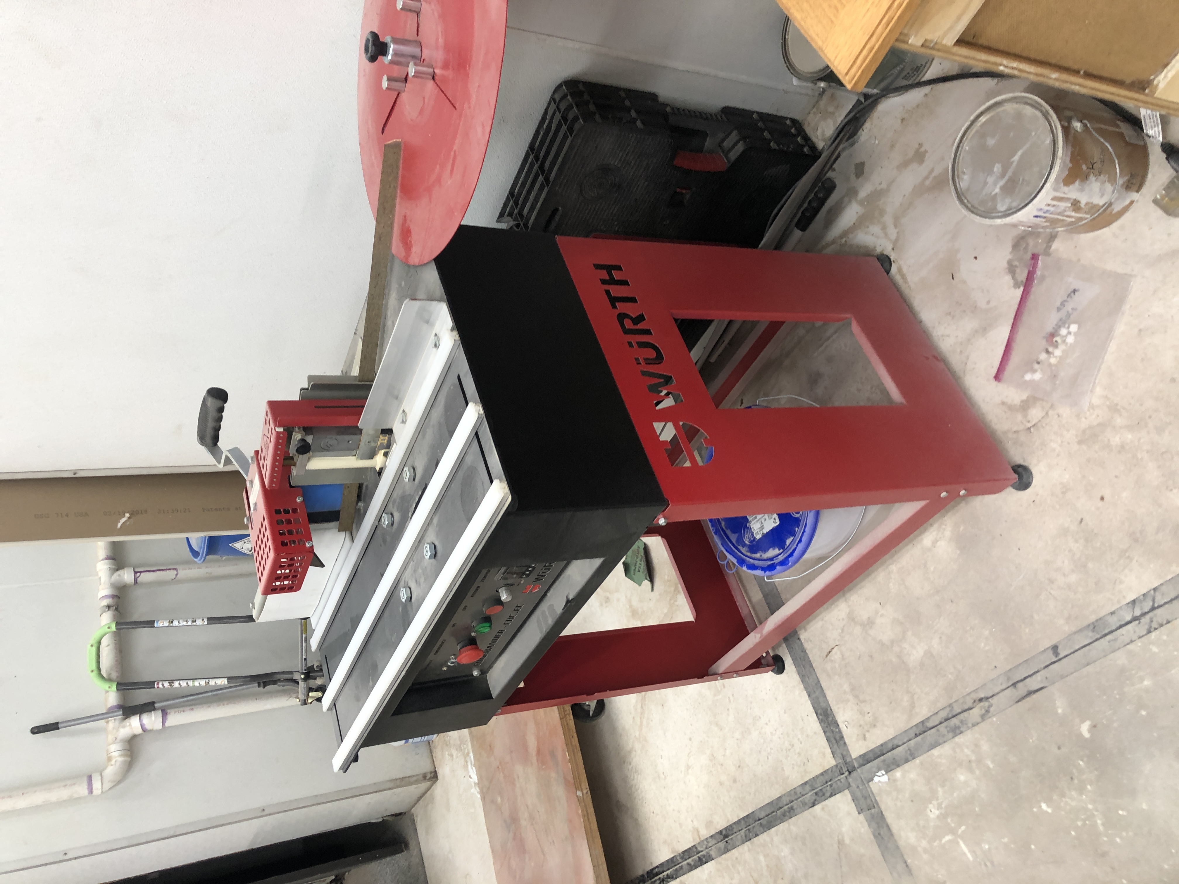

I have the “Wurth Baer” edge bander

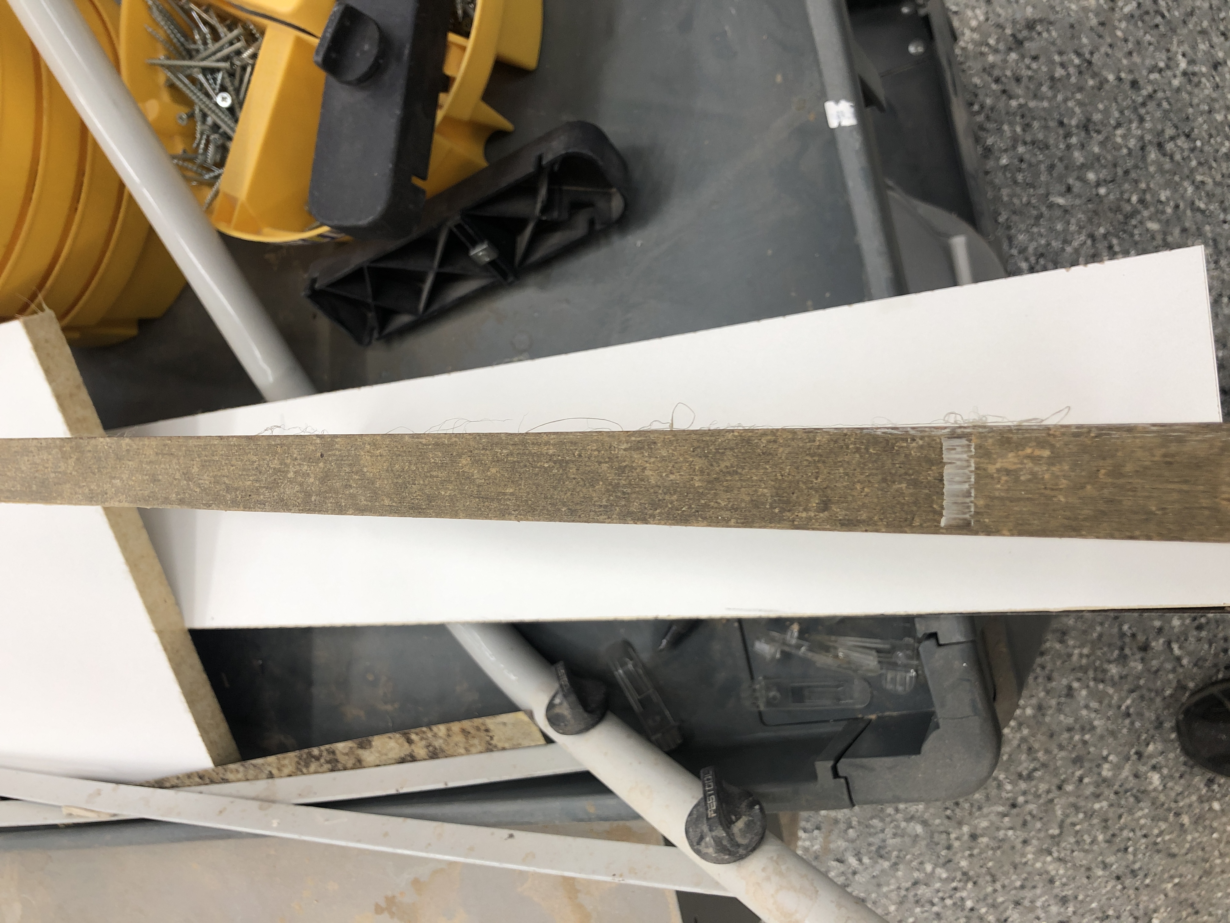

I finally got the PVC edge correct, but now I cannot get formica to stick to PB or MDF core. im getting full coverage on the board, but it’s not sticking to the Formica and peels off. Anyone know what type of glue i need and what temperature I should be running it at? It’s currently set to 320 degrees.

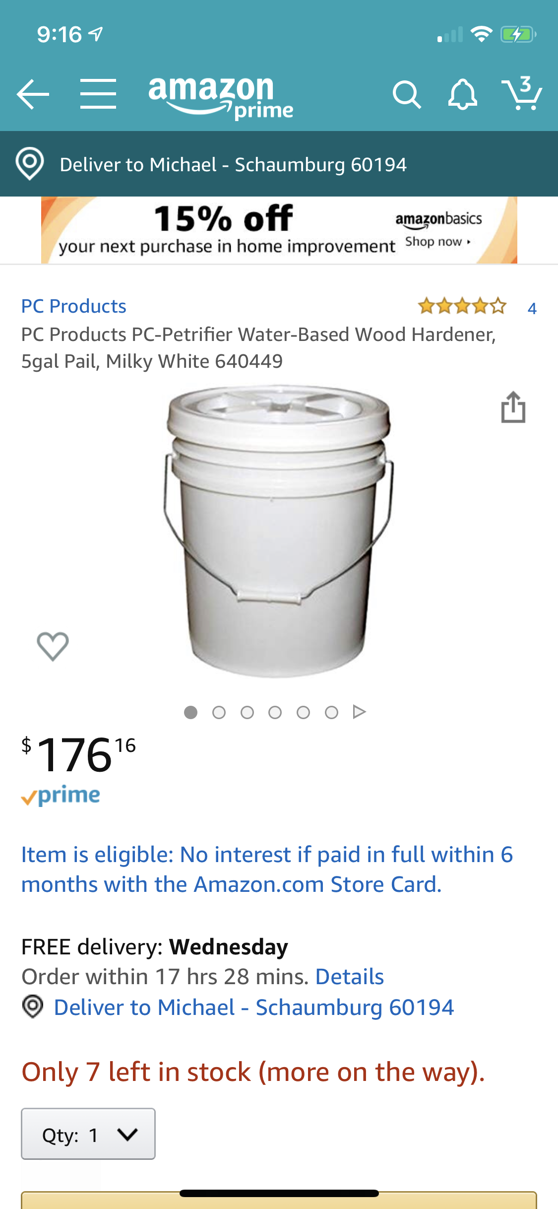

I bought it from Amazon, PC Products PC-Petrifier Water-Based Wood Hardener, Milky White 84441

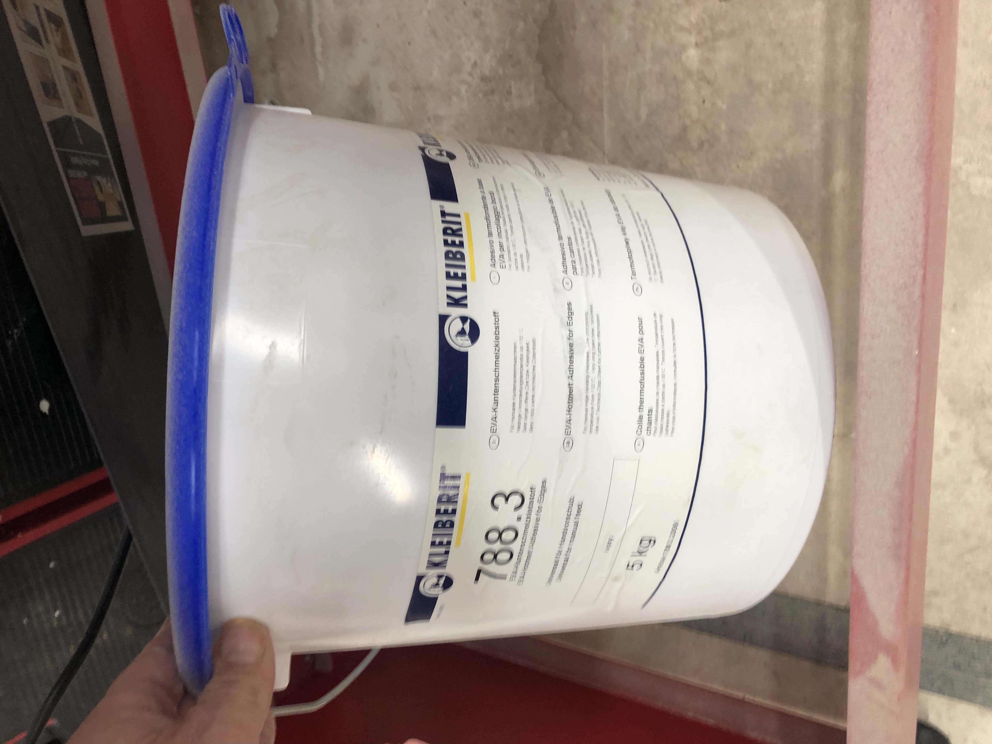

Do you happen to have the same or a similar one to mine?
6/16/19       #6: Looking for right pellet glue for f ...
Is that it?

What is reccomended heat, I thought kleibert was 200-220 is glue to thin ?
