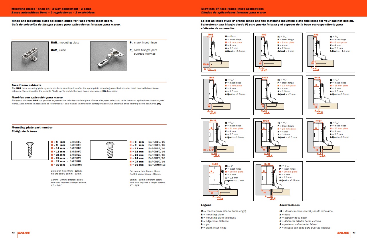

How wide do you guys make your inset face frames? I've used 1 1/2" wide stiles and rails in the past, but I was thinking 2" might be better for hinge installation. I will be using Blum brackets that attach to the back edge of the stile. Thanks!

The important measurement to use the mounting plate you describe is the space behind the face frame. You will need a minimum of 5/8" to install the "bracket". More is better to make an easier installation. The measurement of this space is, of course determined by both the width of the face frame and the positioning and thickness of the cabinet side.
Here is another method that many shops prefer. Salice offers a selection of mounting plates that match up to the space behind the frame and attach directly to the cabinet side. This is a much easier assembly and a very secure attachment.
I do agree with Eddie that 1-1/2 " is pretty much the norm and building the side flush with the frame is best for both appearance and function (You will never see this at Big Box store cabinets). It's a very nice custom look.
