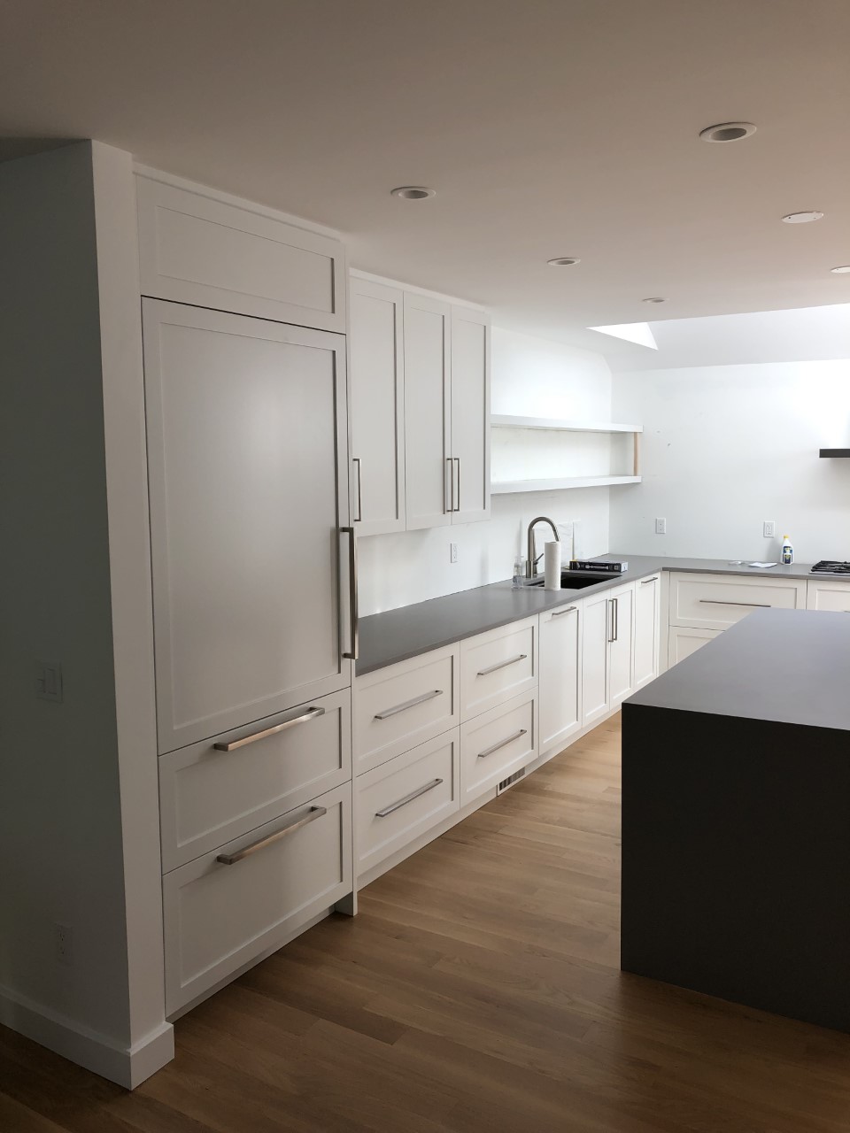

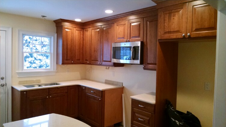

Tom c
Pics of Frameless Kitchens to ceiling.
That's all we have been doing the last 30 years.
Our Doors are a 1/4" shorter than the cabinet on top, Soffit board, usually 4-6" high, does not go to the ceiling. Enough for the crown to catch.A strip is pocket screwed behind the soffit,screwed up to from inside the cabinet-NO Face nailing. Pin-tape mitres.
Ones like the hood are done in the shop before hand. Crown -I push for painted on site by others when I can. Sometimes a bunch of planing on the crown is a given.
I do the VIF with a laser and check when I see something wacked..Most houses pretty good . Old Plaster ceilings -Double check and Uncharge ++$$

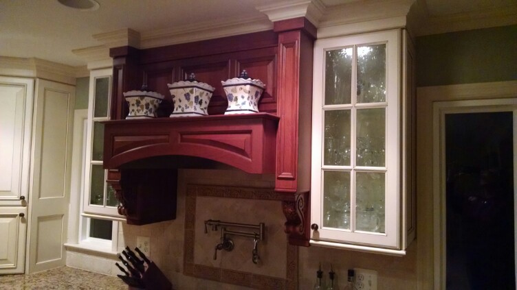

Tom c
Pin Nailer ...
Re read -I missed writing that the soffit board overlays the top of the cabinet 1/8" -
So I get a 1/8" Door gap to soffit.
Profile on soffit edge is same as doors.
Most of the time ...

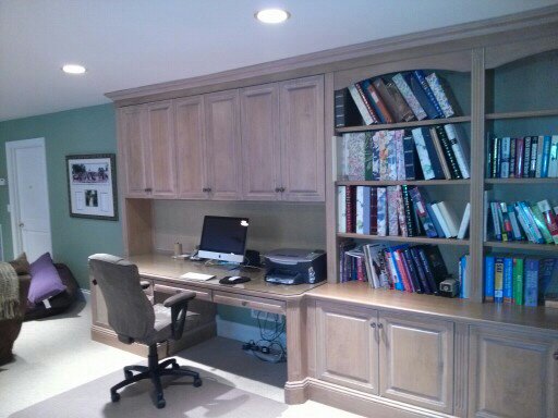

Eddie
We make a "L" shape fascia, install flush with the door and scribe to the ceiling, the last kitchen we did, the designer wants the fascia set back the thickness of the doors (flush with the box), follow pic.

Eddie
that's correct Rob, and always making the pieces with scribe.
