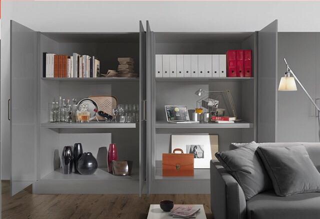

Gentlemen,
The time for magnetics is here. The new (revised) Salice Exedra Pocket door system utilizes magnets as the damping technique.
This revolutionary device is a linear magnetic damper, used in the furniture field for the first time, which ensures the perfect decelerating movement of the door.
The damper is directly attached to the main track and it guarantees a perfect and silent soft closing.
The damper is made up of 40 neodymium magnets (the strongest type of magnet commercially available), which, when it slides over an aluminum profile, generate a resistant magnetic field thereby slowing down the movement of the track.
Maybe your slides will be next.
View higher quality, full size image (640 X 439)
9/24 #9: up and down play on undermount slid ...
Dennis - so, this Salice pocket door mechanism will self/soft retract when the door is pushed into the cabinet?
9/24 #10: up and down play on undermount slid ...
Yes, it retracts softly into the cabinet. This is our same pocket door that we have had for a few years with the addition of the magnetic dampers.
