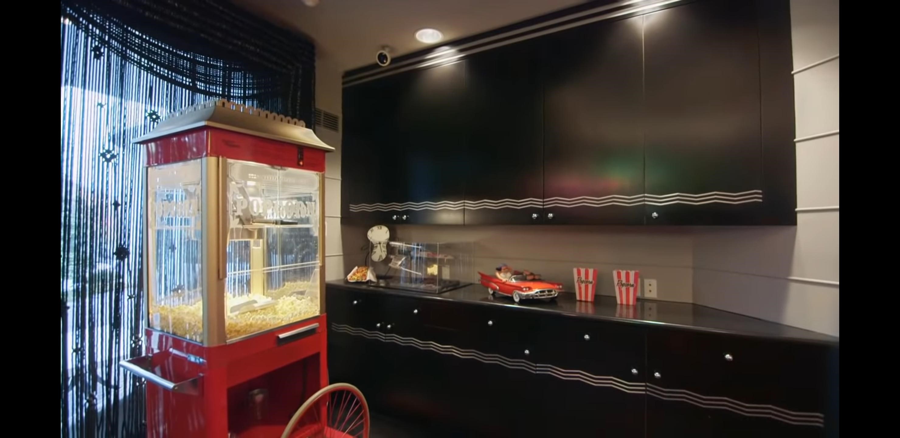

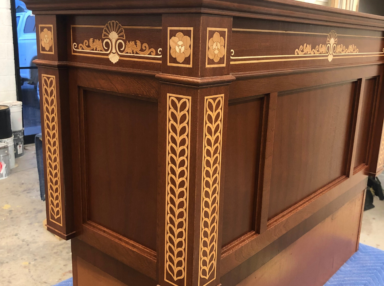

I have request from customer to do cabinets and top as shown on picture. Is anybody familiar how to make cabinets like that or point me to some direction.?
View higher quality, full size image (2960 X 1440)
11/22/19       #2: Building custom cabinets ...
What specifically are you asking about? The laminate, the inlay, or frameless?
11/23/19       #3: Building custom cabinets ...
james e mcgrew  Member

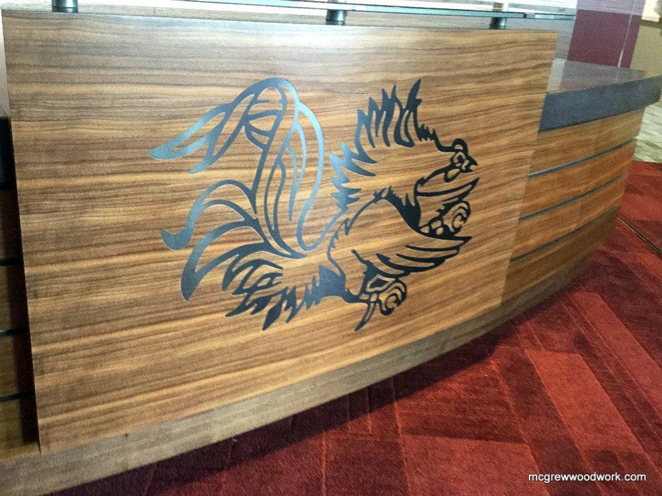

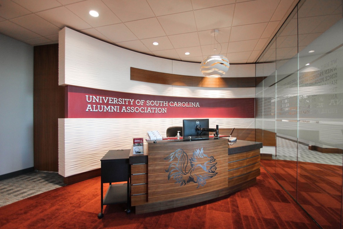

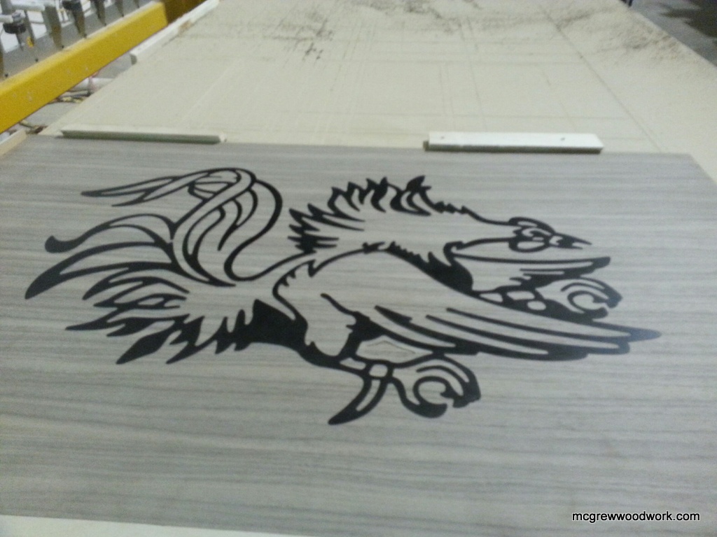

Inlay Laminate work,, easy enough with some talent, easier with a CNC and some talent,, some day I am gonna get some !!

Is is laminate or Acyllic? If its arcyllic ask Richlieu or Premier Eurocase if the can do the inlay

We occasionally use laminates with the "inlay" printed on them. Wilsonart makes them for me. Yu can buy them is sizes up to 5X12. The brand is Wilsonart BY YOU.
http://www.wilsonart.com/digital-print-studio

We have been building similar cabinets with several veneers. I would be happy to see if we can help out.

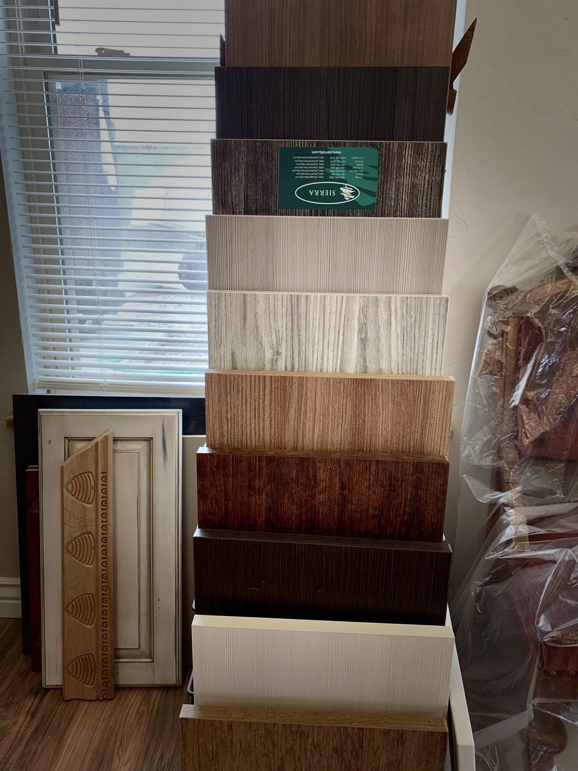

View higher quality, full size image (1936 X 2581)
View higher quality, full size image (1250 X 930)

We have done very ornate corporate seals or Indian tribe seals on solid surface by sending out a 30" x 30" square section to be laser cut then inlaying with pourable inlay material. Not that expensive for the inlay, tough to figure out how much to order but $150.00 would do several large seals.
You need an orbital sander to get the bubbles out of the inlay and some heat lamps really help speed the cure. Let it set overnight and sand it flat with a belt sander and an orbital sander or Festool sander. Far more intricate work than is possible by cutting inlays.
