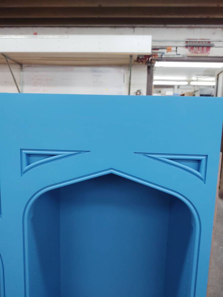

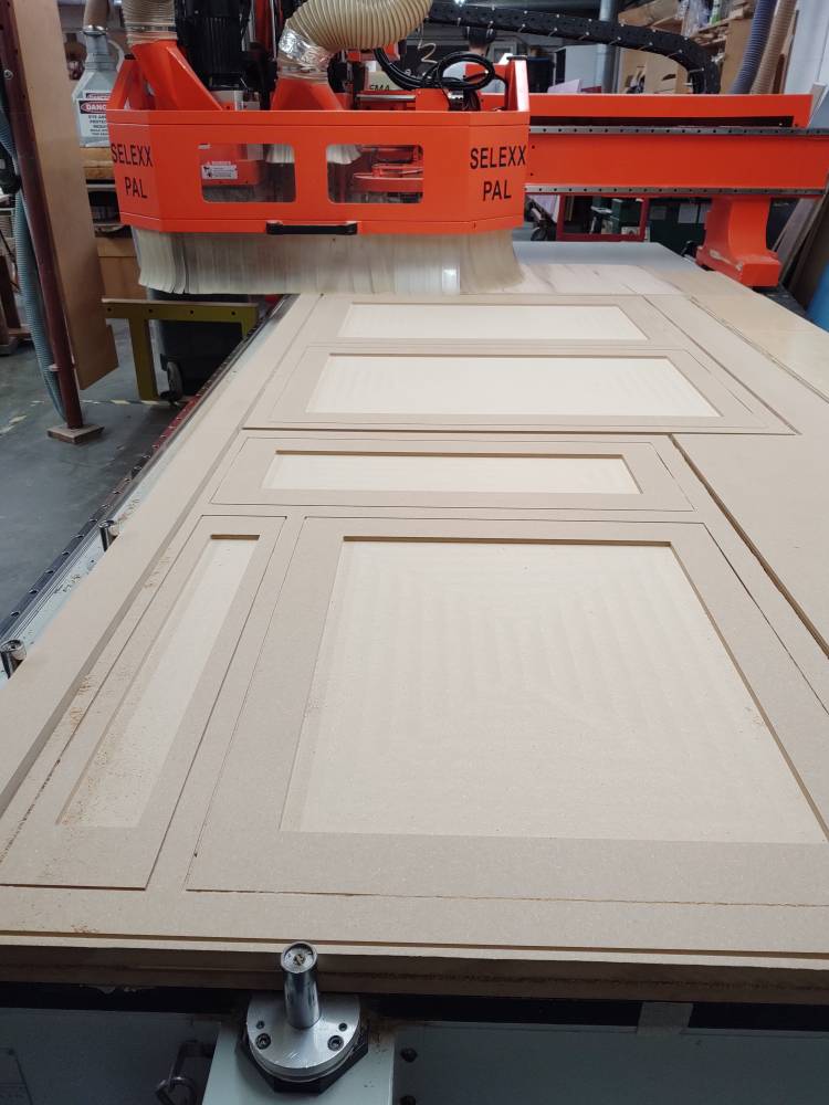

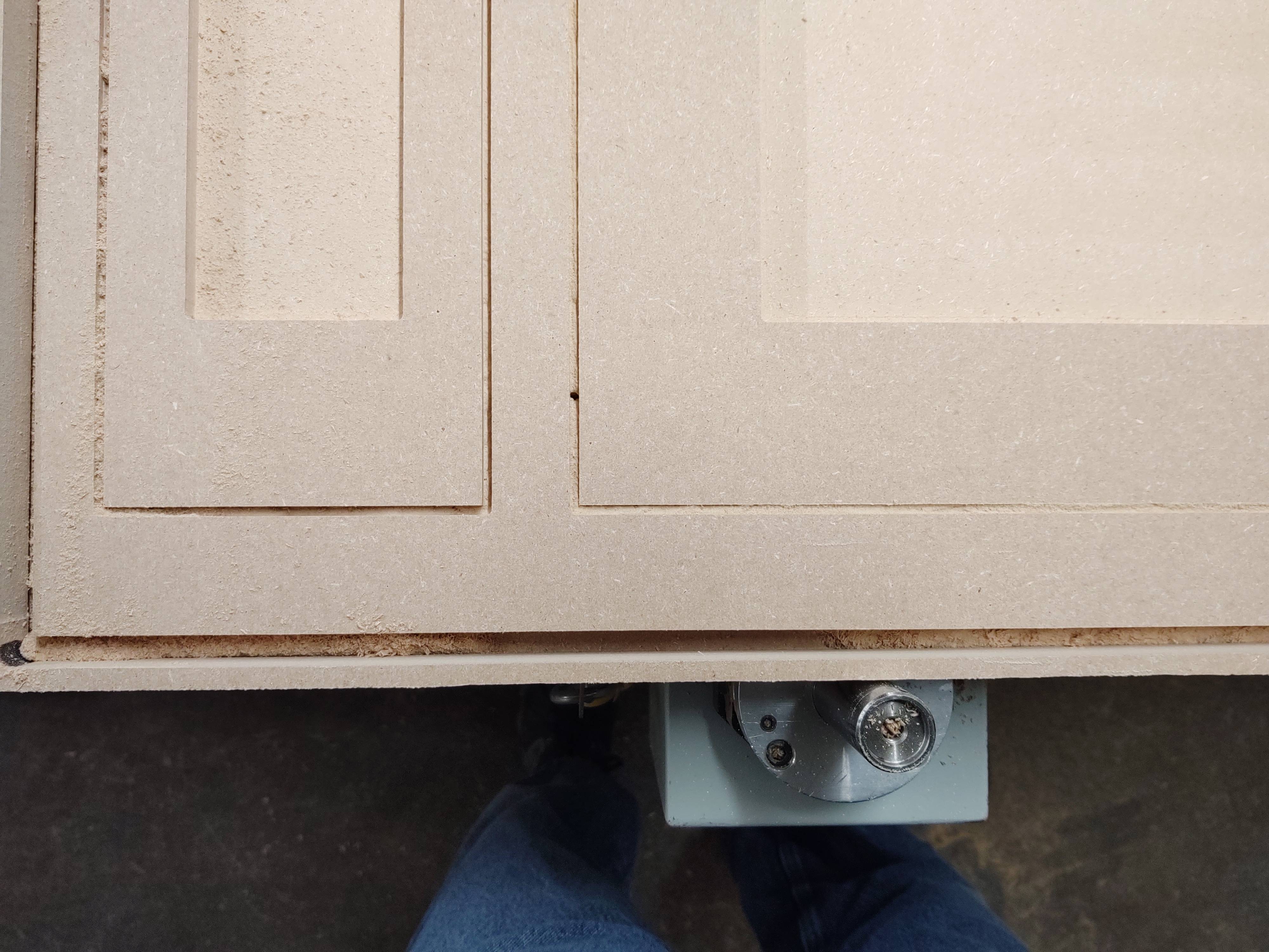

We started doing this and our test job was our showroom so far so good one piece nested door and frame

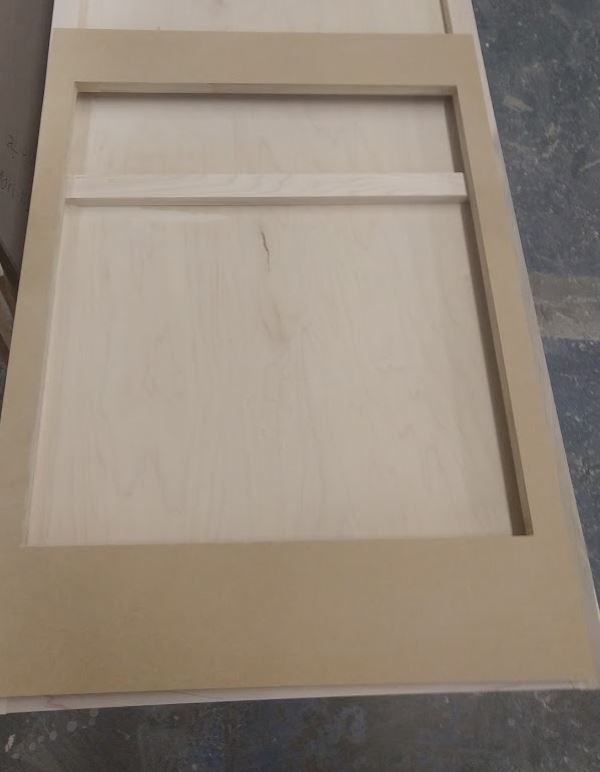

attached is an end panel frame i cut today overlaying over typical 4/4 maple mortise and tenon frame.

We use Medex which machines and finishes nice. We use both Cabinet Vision and V-Carve pro. You can approach this two ways,
1. Send elevation to drawing in Cabinet Vision, then export dxf and load this in V-
Carve pro and tool path. First is the pocket for the recessed shaker panel, second cut the door outline with 1/8" compression bit and finally cut the outside outline of the face frame and 1/8" tool. This could be done with a larger tool but you may start to distort narrow stiles or rails if you are too aggressive with the cut.
2. Totally in Cabinet vision use your tool set for a shaker panel mdf door and create another door that is actually your face frame, this door would have no panel just stiles and rails. This process is in testing on my end. The plus would be just one software and it all happens in the nest

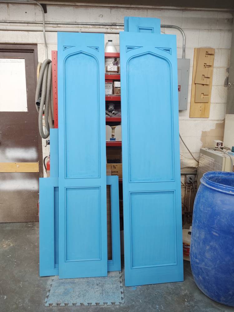

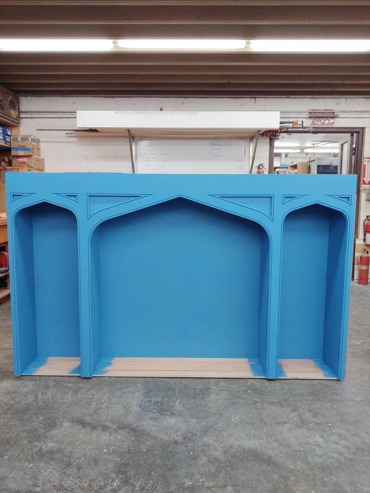

Hi Paul we are still using V11 everyday I am experimenting with V12 especially the connection manager which is a real game changer. I posted some beaded face frames that we did for a customer that requested MDF frames for a very $$$ mansion in Boston. Please excuse the primer color

Yeah the customer/builder specified it they wanted it seamless which it is. We used clamex and tenso fasteners which work great and you can remove them if you are working on a cabinet with doors and pre-finished maple interior
