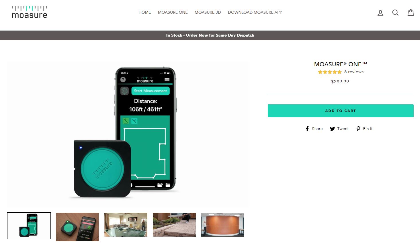

Anyone tried this yet ?
It is a matter of time until technology eventually gets less expensive and more available, I have always tried to keep my eye on this and lately most tech seems to rehash previous tech
This looks Interesting and I may order it just to check initially, it requires a subscription so keep that in mind
View higher quality, full size image (1465 X 864)
http://https://www.moasure.com/products/moasure-one

Ive been looking into these lately as well. What is the tolerance on this particular app? All of the others ive seen similar to this are +-1/2". Then you step up to the Leica which looks like a total pain in the butt to use and carry around...

They might be being conservative on the tollerance,, looks like is for carpet guys !

Might be okay for getting close before shops or something, tolerance seems to much for anything other than rough measurements.
How accurate is Moasure?
99.5% for single dimension measurements, for example +/- ¾ inch for a 12ft length
97-98% for area and volume measurements, dependant upon shape, for example +/- 3 to 4.5 ft2 for a 150ft2 area
98-99% for 2D and 3D linear measurements, dependant upon shape, for example +/- 1½ inch in each dimension for a 12ft x 12ft room
