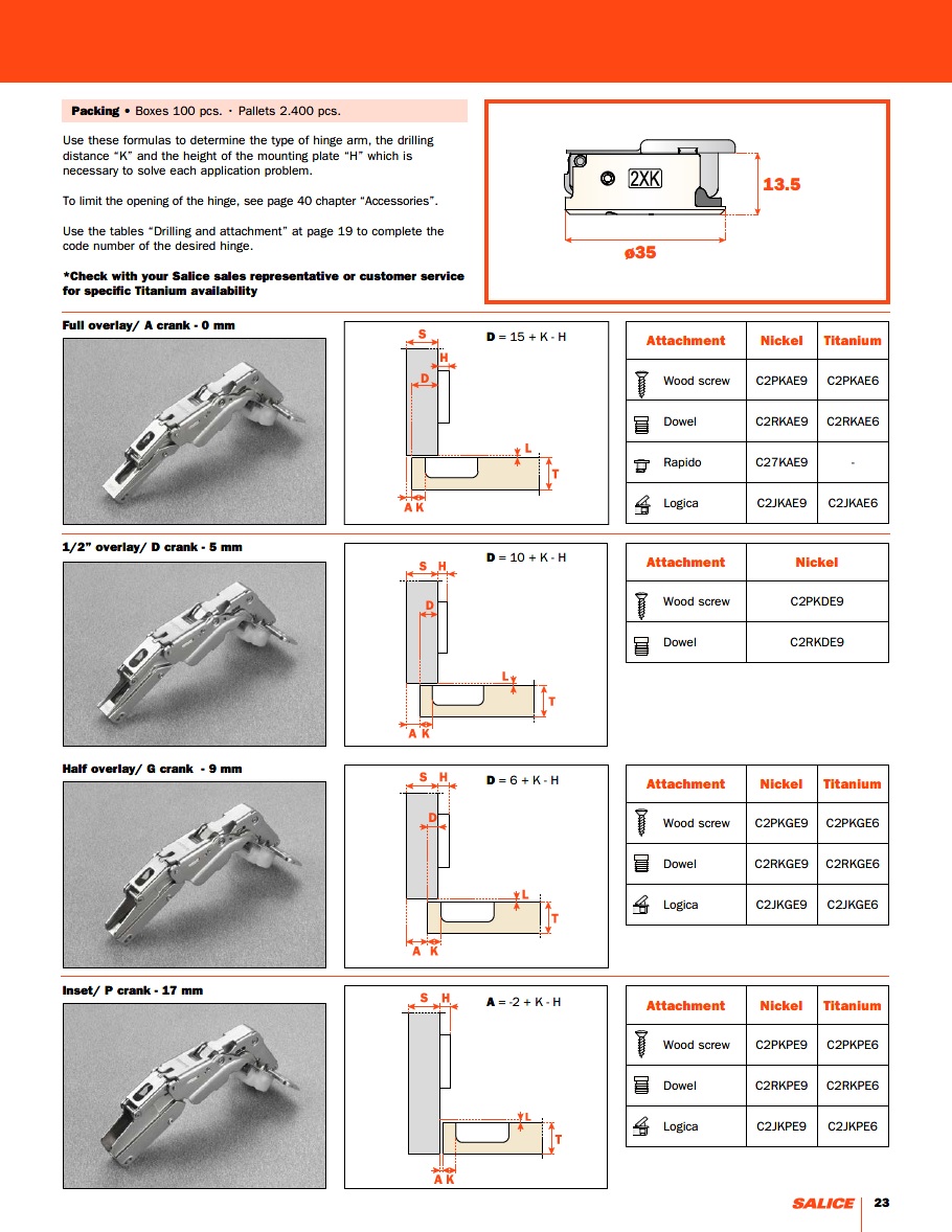

Hi Dennis,
My usual Salice hinge is 110 soft close. Have some tall doors (84”) x 22” wide that I am thinking I will order 1” thick and hopefully this thickness controls some of the warp issues that normally comes with 3/4” thick doors. I would like either 155 or 165 opening angle soft close. Will either of these work with 1” thick doors?
Thanks,
Al
2/21/20       #2: Question for Dennis ...
Dennis Bean
Hi Al,
Our soft close, wide angle hinge is the 155 degree hinge. It is good for doors up to 28mm.
For 1" thick doors you would need less than 1mm gap to turn the door without rubbing. The hinge is also zero protrusion should you plan to use roll-outs.
Here are the details and part numbers for each version.
Thanks,
Dennis
