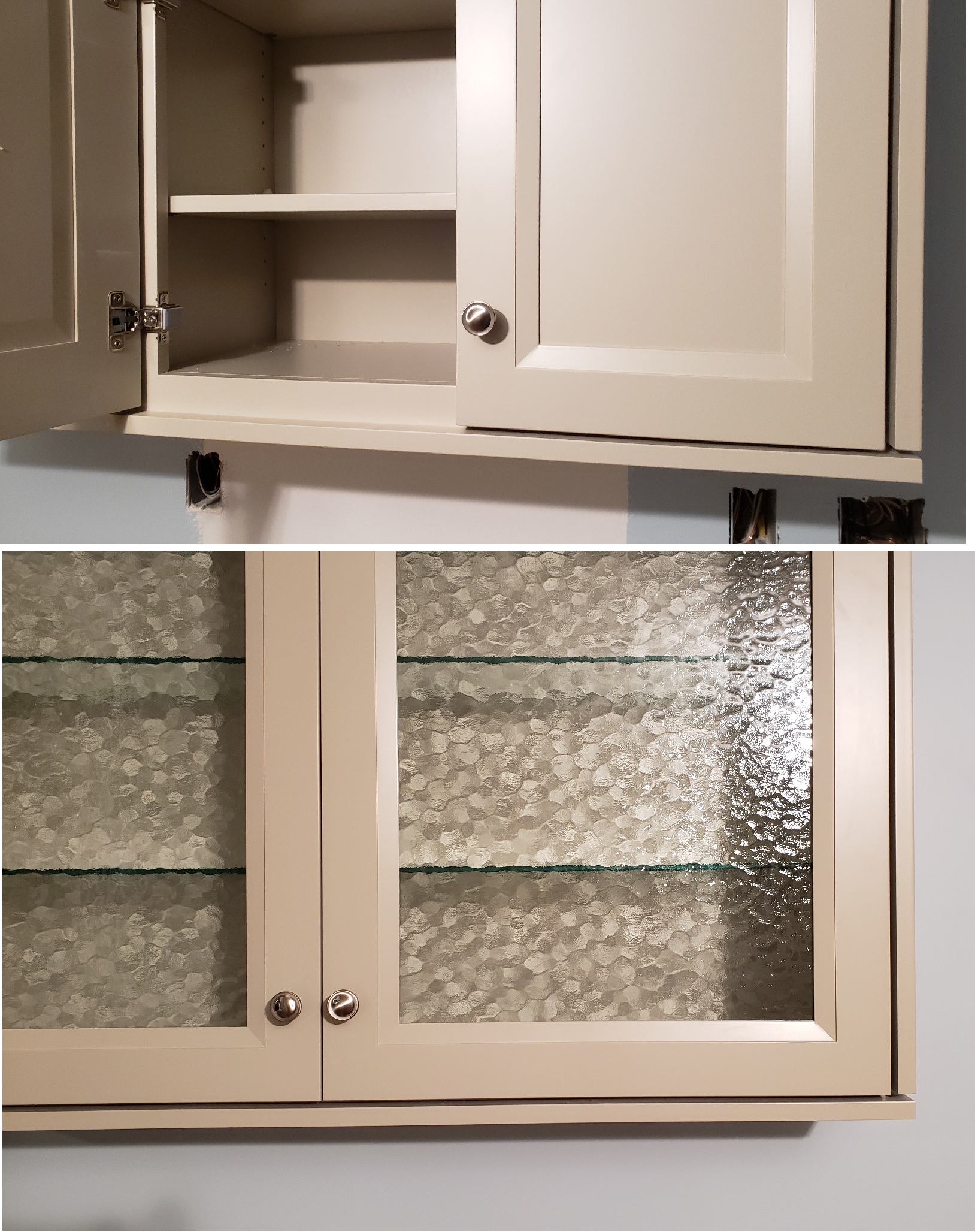

Greetings,
I am having our own kitchen built right now and we have done something similar. Although our cabinets are face frame I asked our cabinet maker to add the finished end to extend forward flush with the door face. Likewise, the light rail is positioned similarly.
Actually our kitchen job is on hold due to COVID19. One day from templating the counter tops.
Has the virus affected your work?
Stay safe everyone.
Dennis
