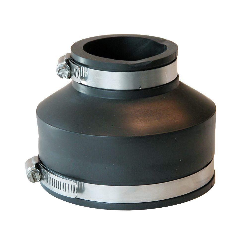

Dan Cook:
Try one of these fittings, available at Home Depot, and probably Lowes as well. You can probably find a size you need, and they do compress and expand more than the stated size.
Hope this helps.

All of the suggestions above are good. Thanks guys. I did find an adapter at Rockler, but I will use the other ideas as well for future needs.
