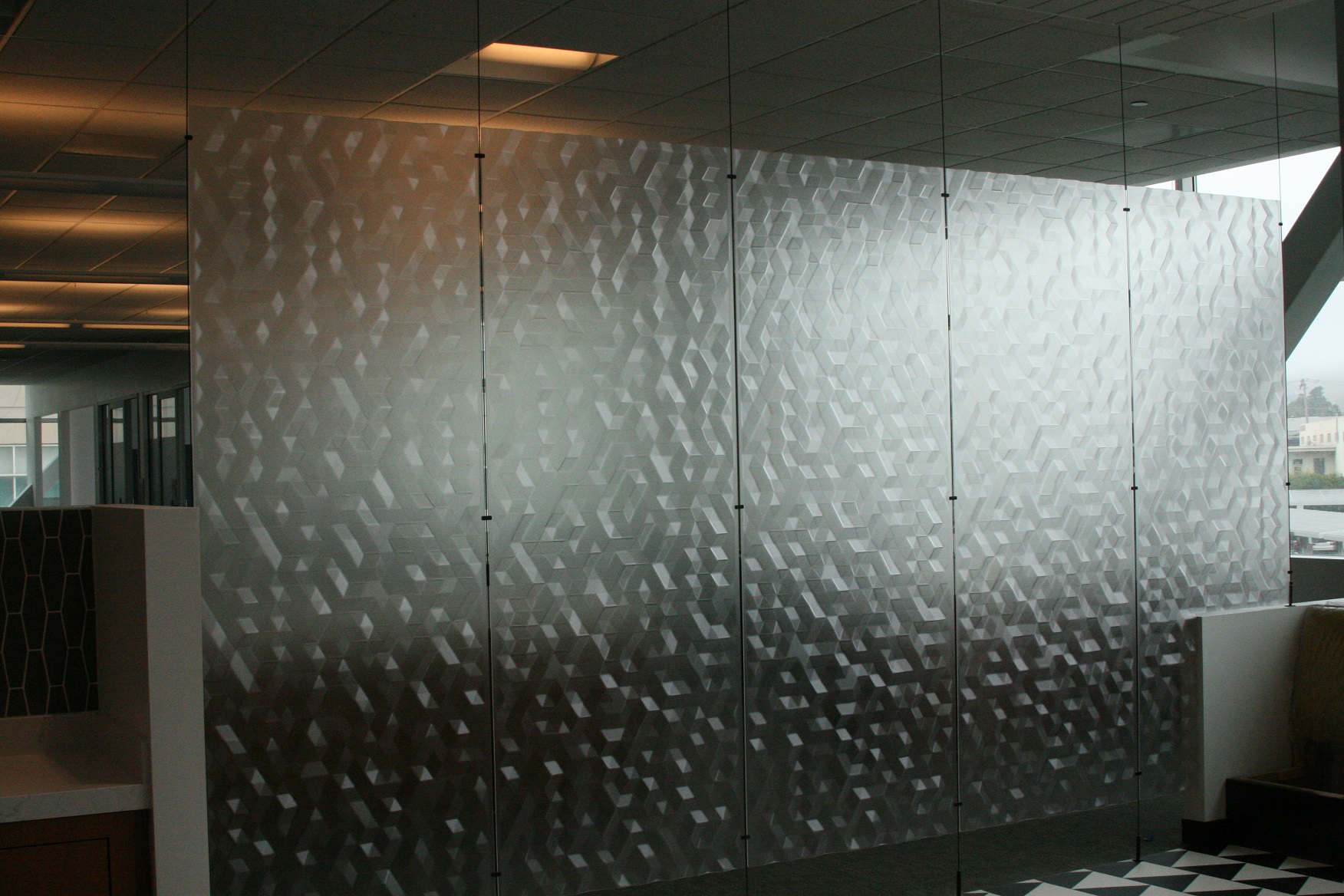

We use standoffs if its something like 3Form.
Have also used cables

Alan,
By the way, nice render. What cable fastener system did you wind up using on those panels and how were they affixed to the diewalls? Do they have a means of leveling up above the grid?
5/13/20       #6: Hanging Acrylic Panels with no nail ...
Alan F. Member
Mark,
Those are 3Form systems, we are attached to dry wall walls and the cables go up about 10' above the ceiling to the deck above.
