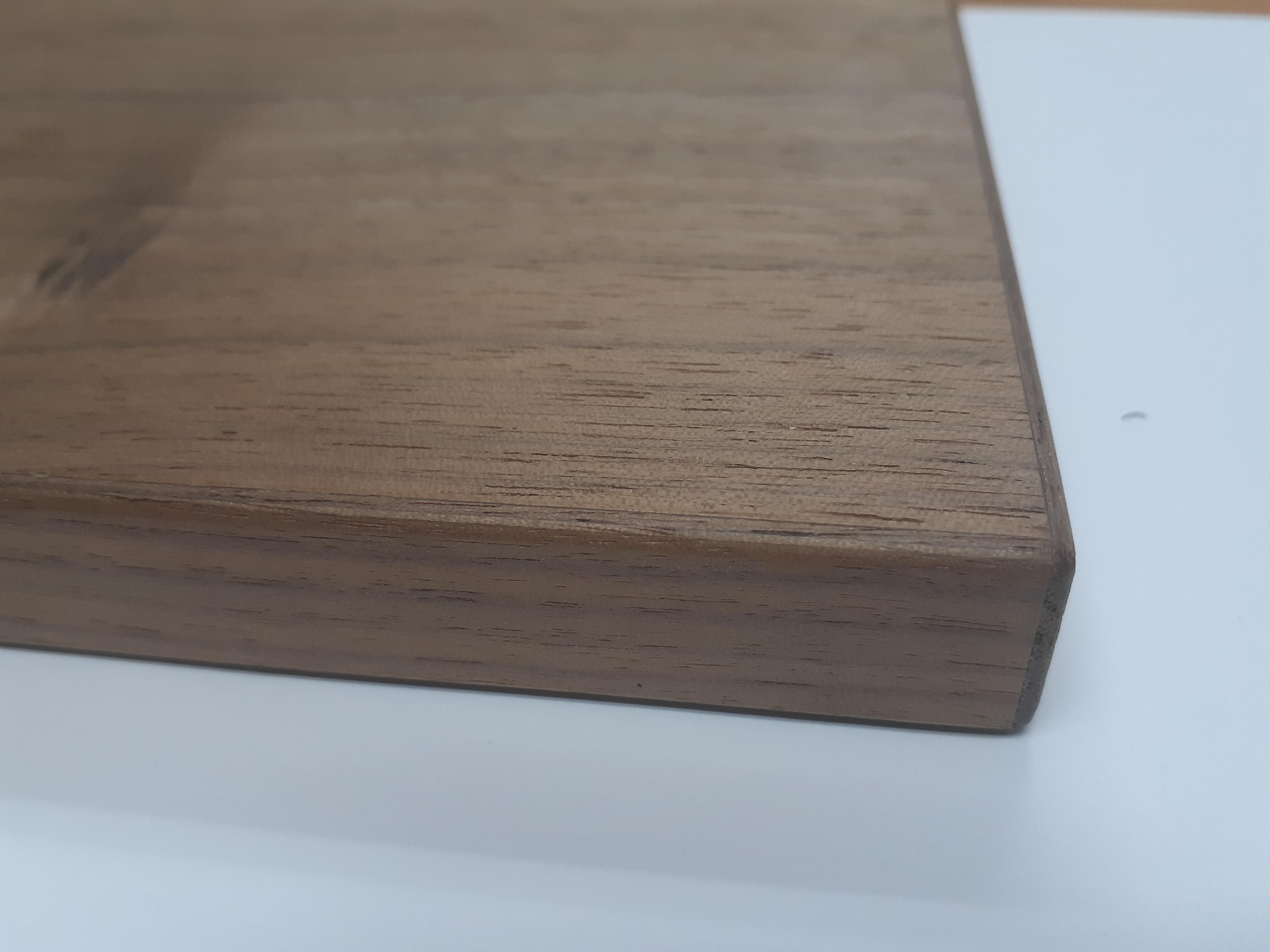

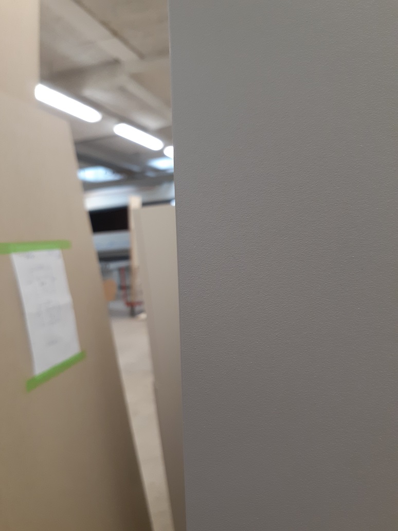

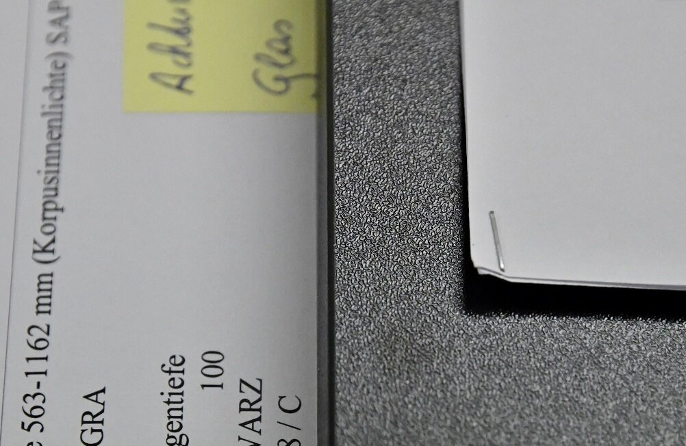

There are multiple ways to achieve a seamless edge. Some machine manufacturers are pushing laser and hot air. You’ve already identified one of the limitations of those systems. They are limited to co-extruded edgebanding. PUR can produce a seamless joint, provided it’s the right PUR system, with veneer, ABS, PVC, HPL, and solid wood edges. The attached pictures are panels that were run in a production shop in Austria on an Ott edgebander. The patented Combimelt glue system utilizes stepper motor control to precision adjust the glue dosage. The Combimelt glue roller is driven from above. This means no leaking seals in the bottom of the pot to run down the glue roller drive shaft.
Much of what people have heard about PUR and maintaining a PUR glue pot is based on outdated procedures from the mid-90s. The Combimelt pot is easier to maintain than an EVA glue system and doesn't require daily, weekly, or even monthly cleaning. Part of the technical training we received at Ott was glue pot maintenance. We pulled the glue pot and hopper (took about 30 seconds), placed it on the service station, filled the pot with Jowat 930.60 (a reusable cleaning agent), heated the pot, went to lunch, emptied the liquid when we returned, wiped the pot out with a cloth rag and it was ready for use.
Along with the proper glue system you need to present a properly machined edge. A set of diamond premill units is invaluable in achieving this.
View higher quality, full size image (4128 X 3096)
View higher quality, full size image (774 X 1032)
View higher quality, full size image (1002 X 652)
