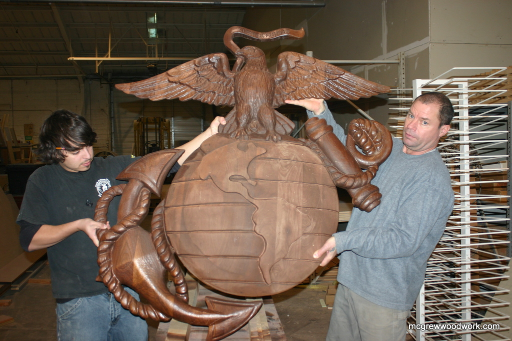

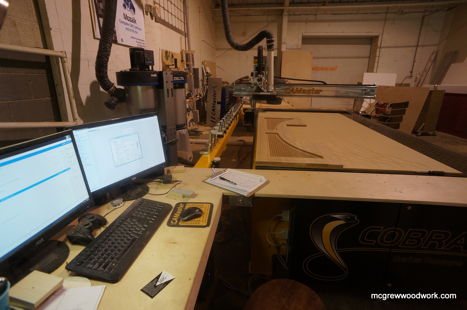

james e mcgrew  Member
You have picked 3 good performers, yet one with free lifetime tech support and others you pay for. With all the info available build your self an excell type spread sheet With the three machines across three columns then all the info features you need and want down the side. make sure you put resale value and how many years it holds, ease of upgrading (I had to step up 3 machines yet never lost a dime)
As you go thru this process you will develop the info you need , Due diligence is everything to sucess.
If i can show you mine I will. after a wild step up i bought my current CAmaster Cobra (ATC 5x8 No drill bank) in 2012. it has led us to compete to levels we never expected, the machine is working today with no shutdowns in 8 years.
loof for forums and ease of those using them. on CAMheads (Camaster machine forum the Slogan is "When We elevate others, We elevate ourselves"
Am I biased Yes, I have a great machine, world class free support and a no glitch cnc operation with 3-6 guys.
I also Admin the CAMheads forum. My info is well published so feel free to call.
Once done Lets Go make some Money, One is only as limited as Thier fear
