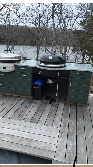

Hi all, I am making some outdoor cabinets for a customer to hold his grill(Weber Summit), and it needs a countertop. I have had a custom steel frame made to hold the grill, but due to these cabinets needing to be portable, I don’t think a stone top is a good idea as it might be flexed to much during setup and storage transportation. Would a wood top made out of a wood like Ipe stand up to high temperatures of being close to a charcoal grill? Or any other thoughts or ideas? I thought about stainless steel wrapped around a marine plywood core, but the heat is still there. The top is roughly 74” by 32”, with a hole in the middle for the grill. I’ll attach a picture for reference. Thanks

I'd contact the Weber company and ask about skin temperature. I though ipe can get splintery after a few years. Depends on the budget, I would go with stainless.
6/3/20       #3: Outdoor countertops ...
Alan F. Member
Solid phenolic or compact laminate if you can separate the heat.
Trespa, Wilsonart. Formica, Pionite, Nevamar and I don't know how many others make the materiel.
