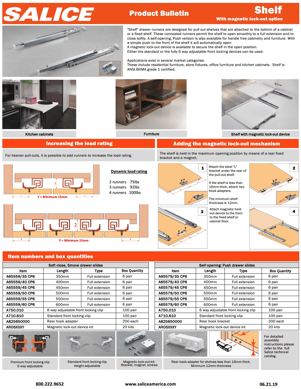

Greetings Jack,
The Salice "Shelf" drawer slide is designed for exactly what you describe. It installs much the same as a typical undermount but due to the design, additional slides can be added for wider pull-outs.
The Shelf slide is available in soft close or Push to open. There is also an optional "lock out" piece if that would be of interest. This might be used for a keyboard tray or retail showcases, for example. The Shelf slide is available in many lengths.
Here is a product bulletin for Shelf and a link for more information.
Shelf is available through any Salice distributor.
Best of luck,
Dennis
View higher quality, full size image (1047 X 1356)
Salice Shelf

Hey Dennis,
The shelf slide sounds like something I'd like to use for a kitchen pullout countertop I need to create for a client in her kitchen.
The plan is to use 2 cm granite (~13/16") and it will be about 22" x 36" which will make it weigh about 72 lbs. I know if I throw enough of the shelf slides at it it can easily handle the weight.
What I'd like to know is how bouncy will it end up being? The plan for this for the most part is a dough making station. It'll be 30" off the floor for nice downward action when "pounding" dough out. Do you think this will be stable enough to use for this function?
Also interested in the lockout function so the shelf doesn't move while she's using it. Can't seem to find it on the web - found the slides though.

Hey Leo,
The weight would not be a problem but pounding on it to make bread would likely be an issue. It essentially has the same flex/stability properties as a quality undermount drawer slide. Would a good undermount be acceptable? I would have concerns.
I would be hesitant to recommend this even with an extra slide. They would likely pull the screws out of the wood with continued pounding.
I know there are actual counter/table extensions out there from Hafele and Richelieu. One of these may be a better choice.

I've looked at the options at Richelieu and didn't really see anything. Most were for a countertop that would pull up to be level with the existing counter, more of a countertop extension.
I have no issue putting 6 of these under the countertop and using machine screws that go through the "deck" of the cabinet with a nut on the opposite side to make sure there cannot be a pullout.
Make any difference?

Is this a trick question? :)
I can send you 2 pair and build a mock-up. I think if you pound on it you will find the bounce unsettling
Let me know what length and I will send them right away.
