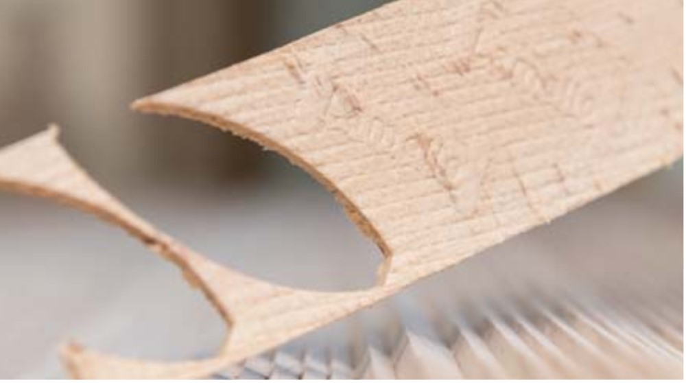

Scott Markwood
Website: http://www.Hafele.com/US
Lamello brand biscuits are made from solid beech. There was an interesting article and video on this earlier this year. (See link)
View higher quality, full size image (1000 X 558)
50 years biscuit joinery
