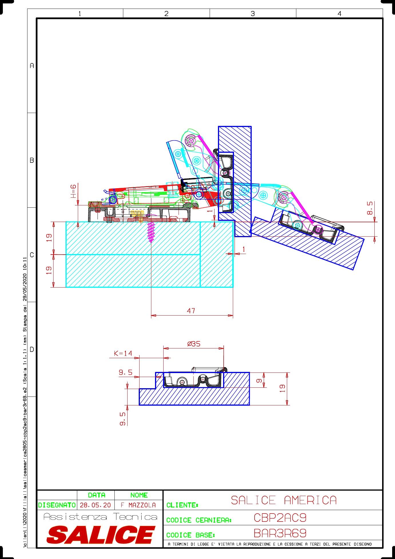

I have been having a 'hard time' getting Salice 3d models of their products. Blum seems to set a very good example of what we need to spec their hardware in our designs. Does anyone know of a good resource of hardware? I prefer parasolid models, but at this point anything would be sufficient. Even decent drawings of Salice would be a start.
8/13/20       #10: salice hinges/grass hinges/blum hin ...
Greetings all,
I see two topics I can address.
Let me answer Louis first.
Louis, if you would send me the list of Items that require the 3D CADs I would be happy to provide them. We keep a library of thousands of CADs that are for most of our hinges, slides and other products.
For 3D modeling we would typically provide these in the .stp format. I have the .stp files in the library and can email them to you immediately.
If you require another format (3D/.dwg, 3D/.dxf, 3D/.X_T), this can be done as well.
