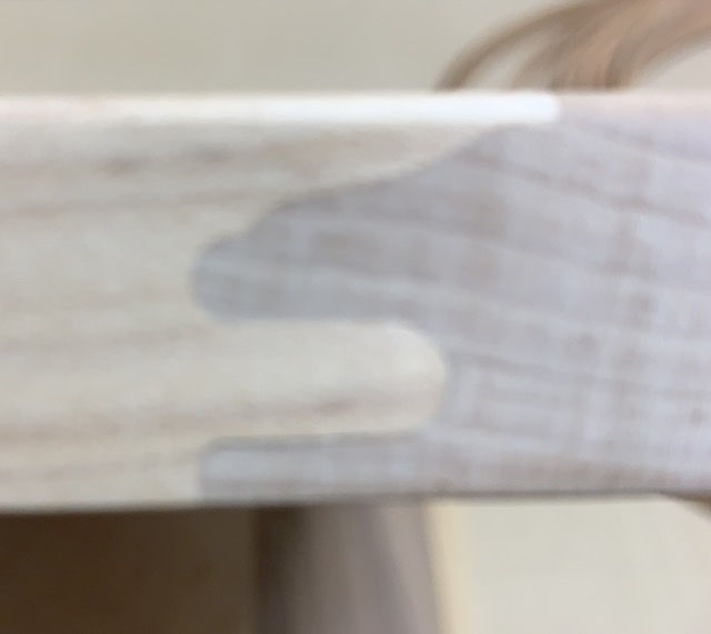

Dose anyone know who sells these cope and stick cutters with this profile?? My door supplier sells these doors and the joints are supper strong. The tenons are tapered and rounded so the glue pushes trough the joint.

You just have talk to your tooling guy and order them that way, it may cost a little more, but you have what you want.

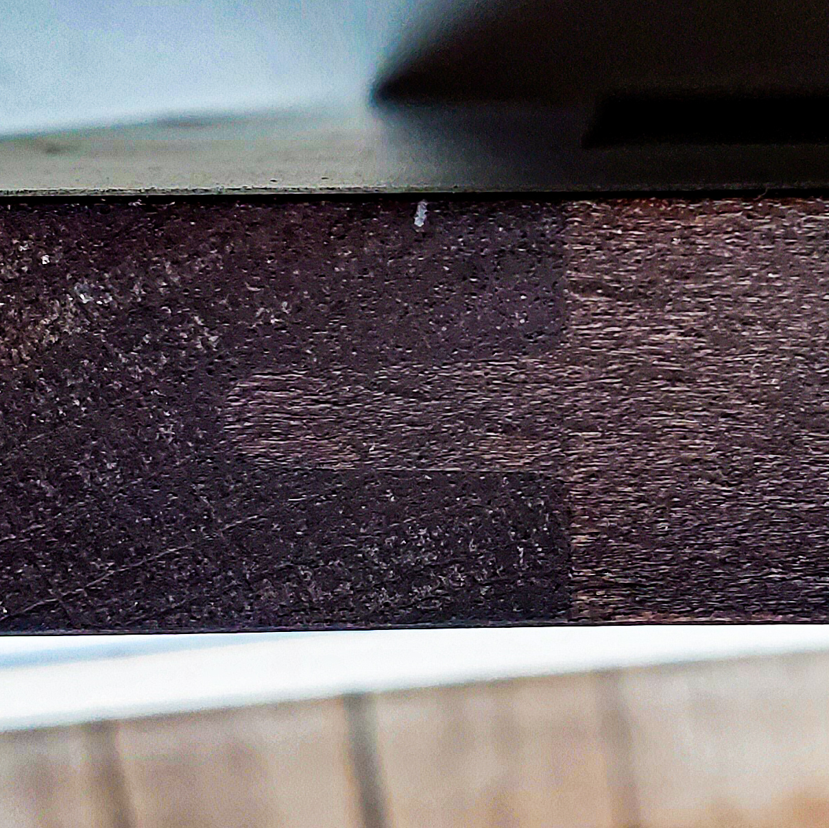

I have a bunch of rounded ones all made by FS tool.

I just wanted to mention that it is all insert tooling so you can get them to pretty much do any shape you need.
I got thinking and I also have some Royce as well.

Thanks! Royce Air has some profiles! I will check out FS tool as well!

I had a set made a few months ago to match a profile from the door supplier. Well worth the $

Byrd tools will fix you up
