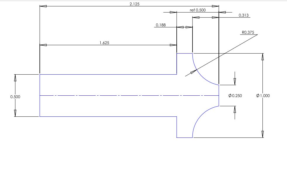

I am needing a router bit for some cabinet doors I am trying to match some existing doors. My question is where can I find some unique cutters I have gotten some magazines in the mail before with several different style bits in them but didn’t need at the time. But now I can’t remember which company that was. Do you know where I can find some boys like these?

Well I use a lot of whiteside router bits but they don't make any bits like I need.

You might want to include a picture of what you seek.

I would check with your tooling supplier like Rich mentioned and a picture like Matt mentioned would be helpful.
My advice would be to stay away from a lot of suppliers who randomly advertise in woodworking magazines, there is a huge span of quality in router bits. Some decent bit suppliers that you might want to check are Dimar, Amana, Freud , Lee Valley tool, and CMT . I don’t do a ton of router bit stuff as most of my machining is done by a shaper, but I have used these bits in the past and they seemed fine.

Chris Payne:
In the past, I have taken the inexpensive steel rabbeting bits with the steel pilot and ground the profile that I needed onto the bit with a bench grinder. Similar to grinding a shaper cutter, if that skill set is available in your shop. For matching short runs, it works very well.
If you don't know someone who can do that, you may consider having a shaper cutter made for your profile by a custom cutter manufacturer. Probably not that expensive for a router-sized profile.

We really don't know if you are looking for cope and stick cutters, panel bits, or outside profiles. With a general comment about Whiteside, you are either just getting started in business, or are a hobbiest. It doesn't take much of a Google search to find custom router bit manufacturers.

We can handle the custom router bits and also over 6000 different stock ones as well

Have your saw sharpener person take a bit that is close to what you need and modify the profile. Not out of line cost wise.
