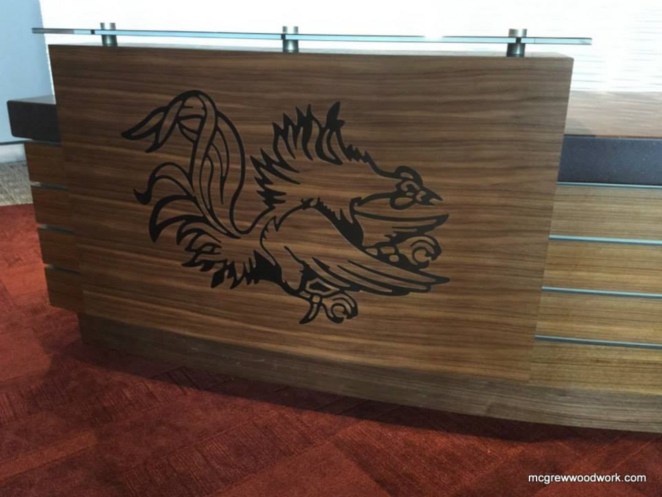

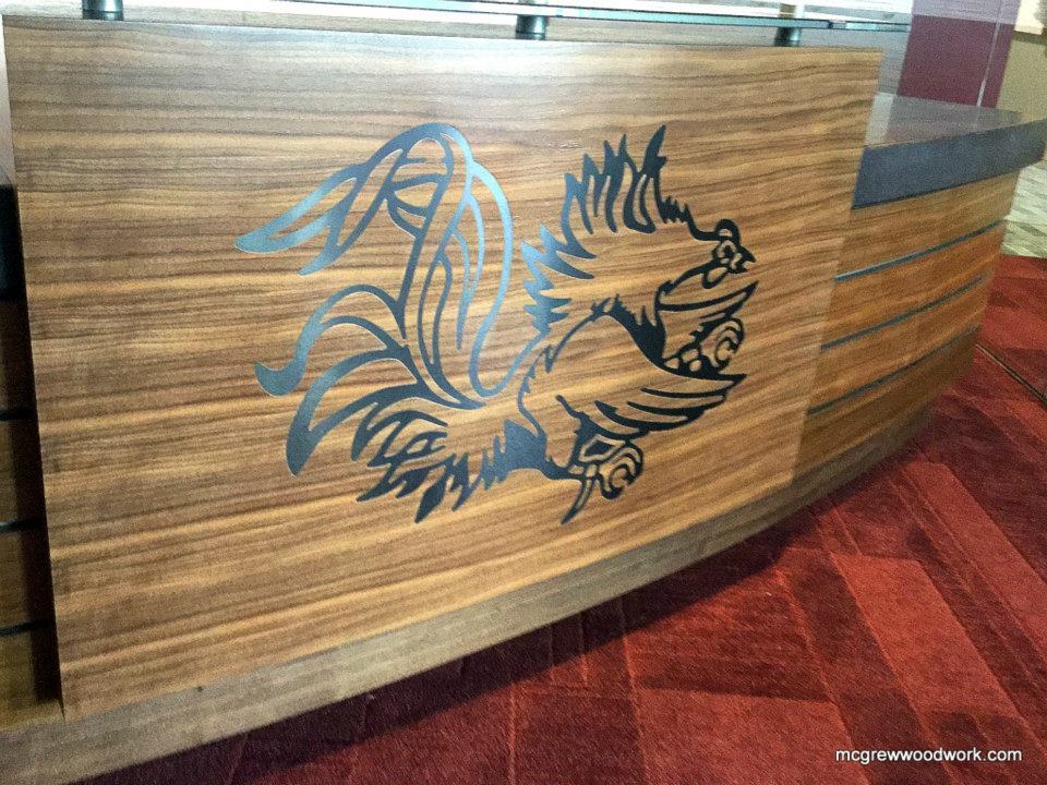

Use Stainless steel laminate cut to size, Think of using deco metals laminates.
I did this bronze (laminate) inlay in a curved walnut desk to credit Specialty Woodworks (lexington SC) built the desk this is thier Job, MY role was the inlay only
View higher quality, full size image (1170 X 780)

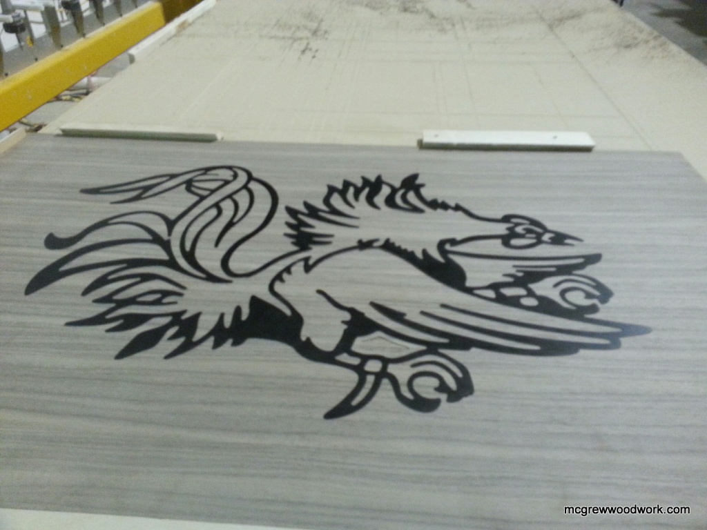

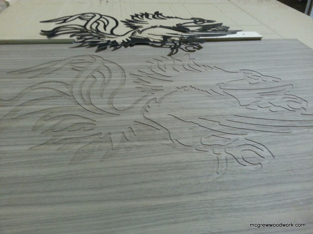

I always cut the male first, then the female using Vectrics Inlay toolpathing, this can be done with regular cad as well
do a test fit on another piece for thickness and fit
View higher quality, full size image (960 X 720)

James that inlay is pretty sweet. Did you program the to CNC mill the female on the radius like that or is it flat and the curvature is gentle enough to make it work? We have had to mill curvatures like that it can be complicated especially if the surface is not a good consistent curvature. Nice work man!

The work was done flat with the walnut Veneer on .25" the adhered to the radius, Yes it was soft enough to make the bend.
