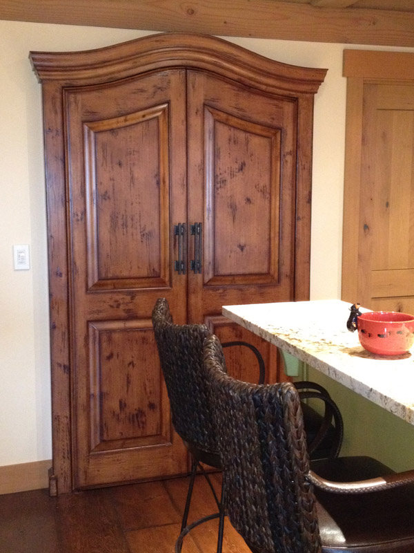

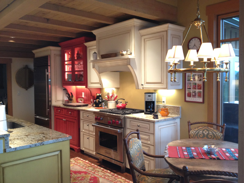

I had a similar project, but with the climate conditions reversed. I built and finished a houseful of cabinets at my shop in the high desert climate of central Idaho and shipped them to a rain forest on hood canal in western Washington. It was a mix of painted and stained cabinets and some millwork. The contractor agreed to take delivery shortly before they were needed and would take care of the installation. I finished my work and sent everything over on time.
However, the the job fell behind schedule, and the cabinets ended up being stored in an unheated garage through a typically damp and rainy winter.
After installation, things began to dry out in the now climate controlled house. The stained and lacquered pieces were fine, but the kitchen, which was a combination of gesso, paint, glazes, and lacquer began crack and flake. The homeowner ended up hiring a finishing crew from Seattle to repair and refinish the damage. I wasn't held responsible, but I felt bad about the situation.
In your case Scott, I would be concerned about shrinkage from solid wood panels (if you're using them) leaving gaps in the finish around frames. Mdf or veneered panels shouldn't be a problem.
