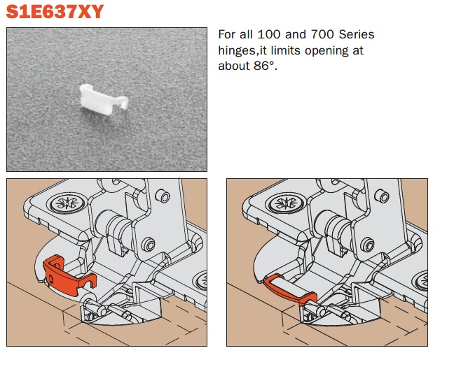

Does the restricter clip work on any of these?
1/27/21       #6: Inset blind corner 94* soft close S ...
Al,
I have not seen it used with the blind corner hinges before so an experiment was necessary.
To answer your question; Yes. The restrictor does work with the blind corner hinge however, it's a little tricky getting it installed due to the nature of the shape of this hinge. I would suggest installing the restrictor clip before you put the hinge in the door. That seemed to work best.
Here is an illustration and the item number for the restrictor you should order.
Thanks,
Dennis
