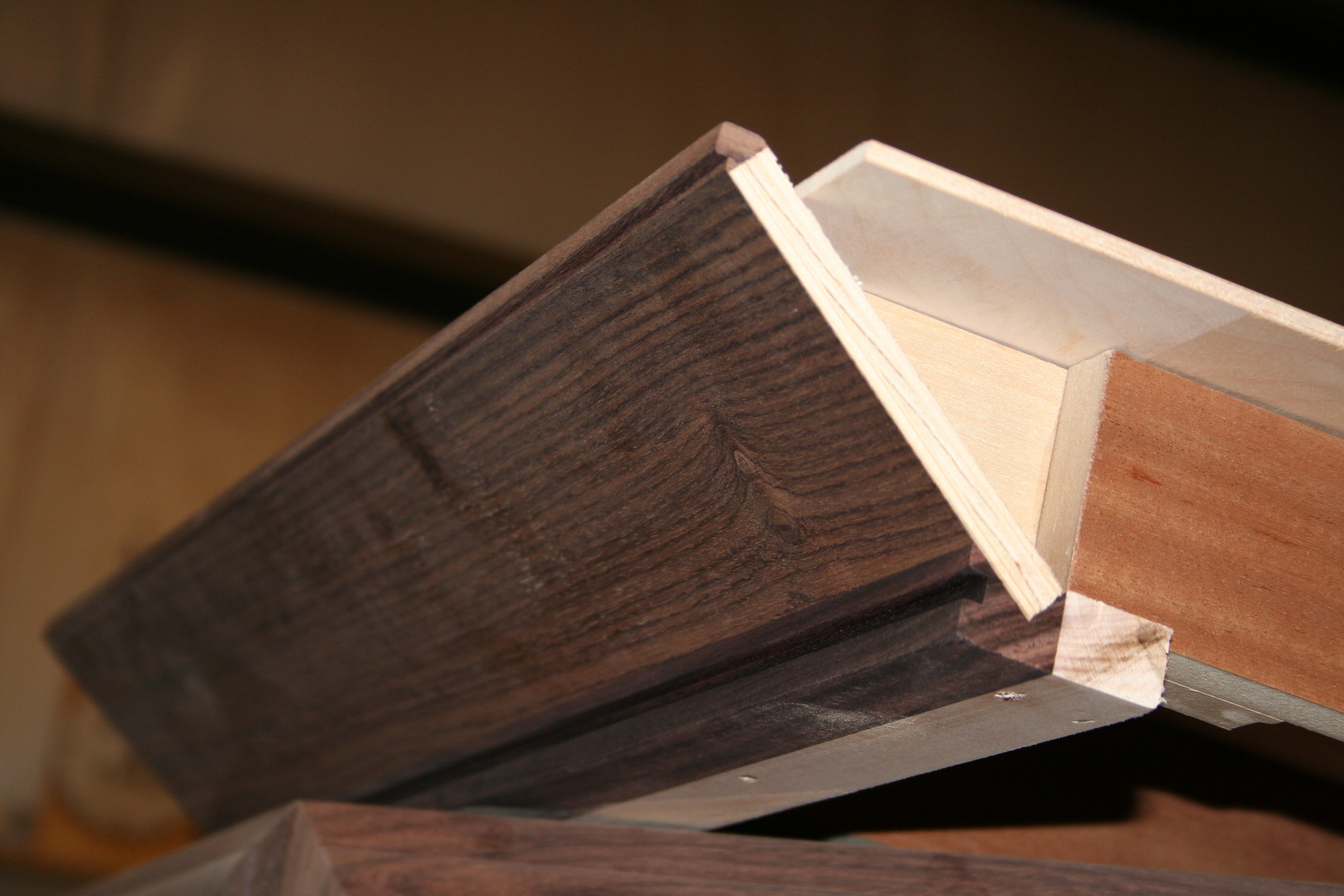

This is Shaker crown. Essentially a flat crown.
Sorry about the low res picture, it's a crop of a much larger picture.

2/3/21       #15: Panel Thickness ...
D Brown
So, since the Shakers did not embellish furniture and cabinet works, personally I have never seen an example of a Period Shaker crown molding. The flat crown Leo shows is what has become known as a Shaker crown in modern day times.

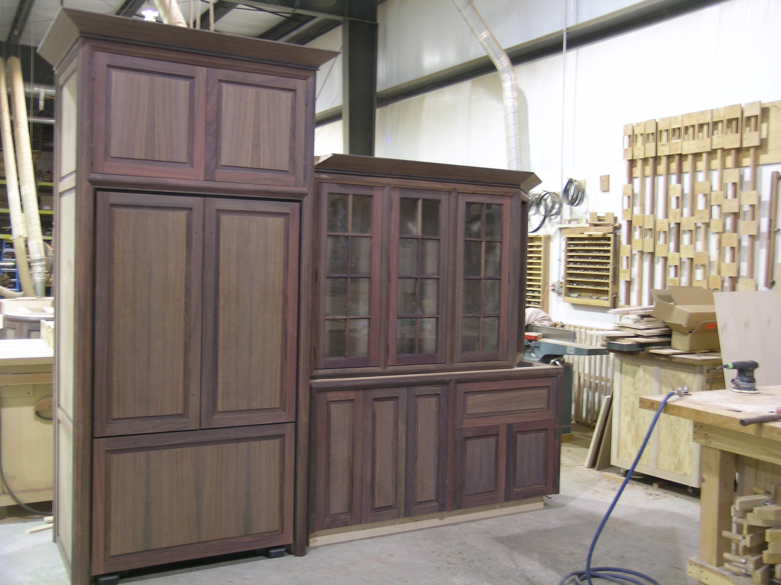

The photos attached are of some crown we made out of Martin Guitar scrap for a sort of Arts and Crafts kitchen. Not enough solids to make much, but we used the hell out of the veneer.
