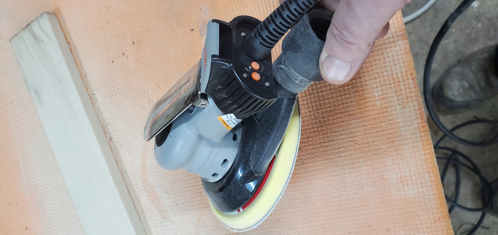

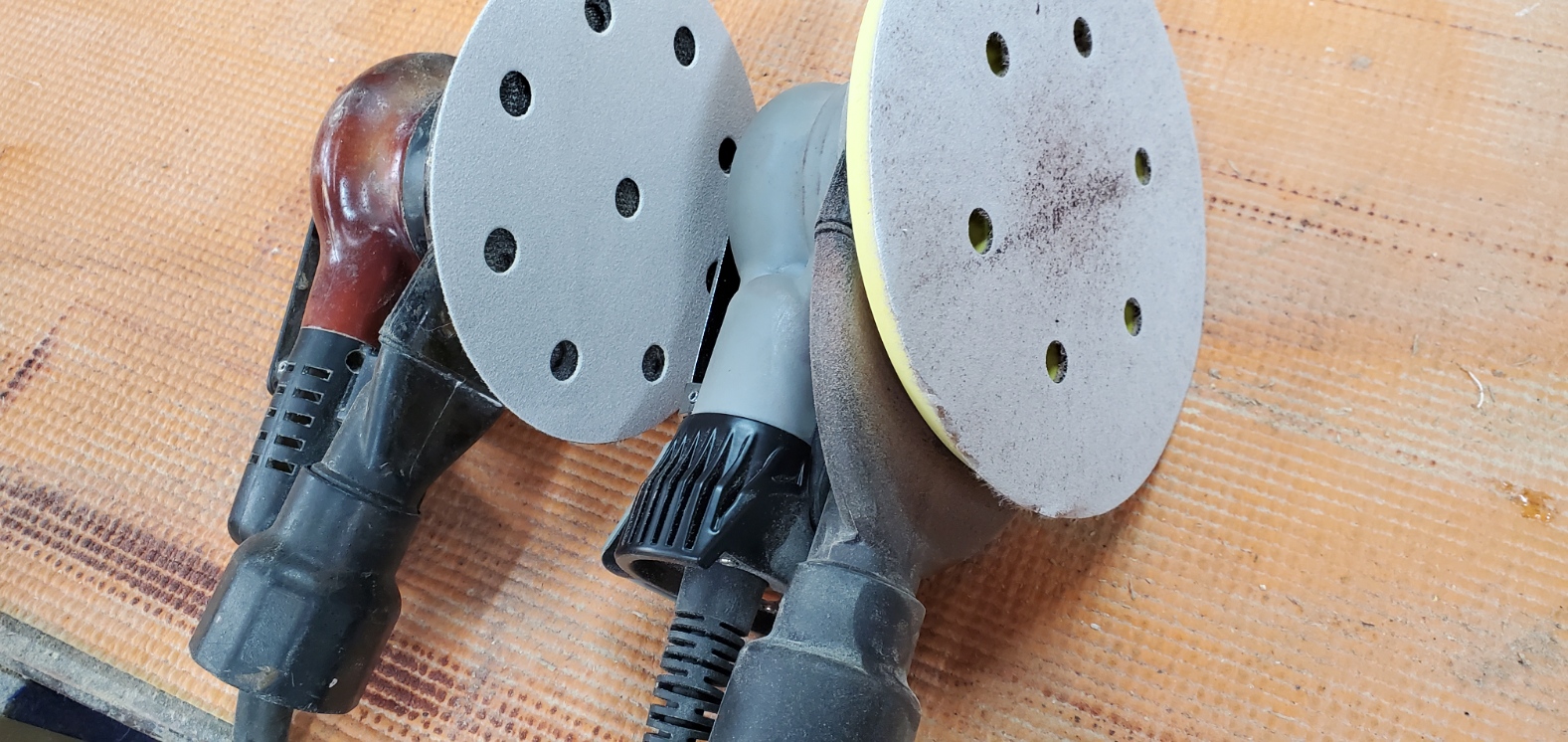

Mark B Member
We have two Ceros' that have been working hard and never had a problem (fingers crossed but likely just jinxed myself). I dont know if Im just stubborn or what but I am still refusing to move to the Deros envelope and we just pulled in two 6" Airvantage sanders. There are issues that are not quite the quality of the Ceros sanders (transformer is a bit smaller physically but what does that have to do with anything, cord and plug to transformer not as nice as the Ceros, speed control perhaps not as smooth down to the low end though we never use it) but at $319 its not the same cost as the Ceros either. I think we paid well in excess of 400 each for the Ceros.
I wish Mirka would re-offer the Ceros instead of walking away from that envelope but Im sure they have their reasons. Same with Surfprep. We will probably order a couple 5" Airvantage sanders here shortly.

3/2/21       #14: Mirka Ceros repair? ...
Dave Edgerton  Member
I agree with you. If I could find used ceros I would buy 2 more.
The advantage, does it act like the ceros like from slow to high speed as you push on the trigger?
3/2/21       #15: Mirka Ceros repair? ...
Mark B Member
Yes, it has the same paddle control. It has one function we will have to get use that it has a "safety" mode. When the sander is turned on its in safety mode which is if the paddle is inadvertently depressed (sander is flipped over by accident or something lands on the paddle) it will kick on, then off. You hit either of the speed control buttons on the back of the sander to kick it out of safety. I will admit I was personally lazy about this but guys in the shop always shut the ceros off on the tool when done because of it getting bumped or flopped on its back and it will run off wildly. I have to remind myself to kick the airvantage out of safety when I pick it up. It also return back to that safety mode after 5 minutes of no use.
The other thing is there is no way to kick it out of paddle control and just to full on/off which again doesnt bother me.
Last, the airvantage has 3 max speed settings. 7K, 9K, and 10K. So the paddle is variable through those ranges (I rarely ever throttle the Mirka) but the extreme low end on the paddle with the Airvantage does seem to be a bit higher than the Mirka before it cuts to zero.
We are rarely ever trying to feather the sander down in the 1k-2k ranges so I dont know that that would ever be a real issue but its there none the less. My notion is I will deal with some functionality to have that envelope especially as 99% of the time Im running wide open or perhaps very slight feathering on some parts.
They are super smooth. One finger holding a 6" Airvantage with 150 grit 5 hole on it is perfectly fine by me.

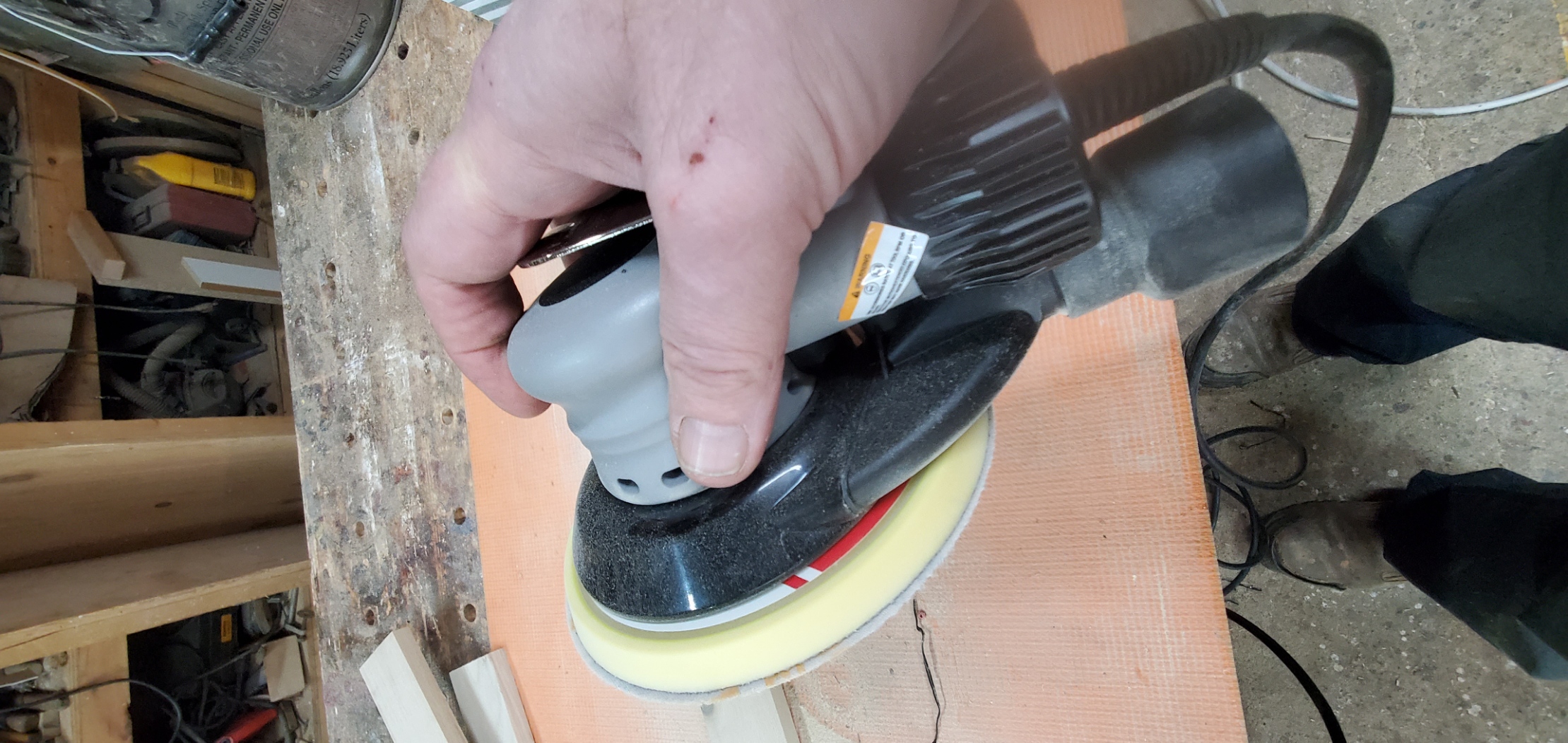

3/2/21       #16: Mirka Ceros repair? ...
Mark B Member
Additionally, The AirVantage has a super wide funnel type DC connection to the sander which seems to be making a massive difference in pickup.
View higher quality, full size image (1577 X 746)
