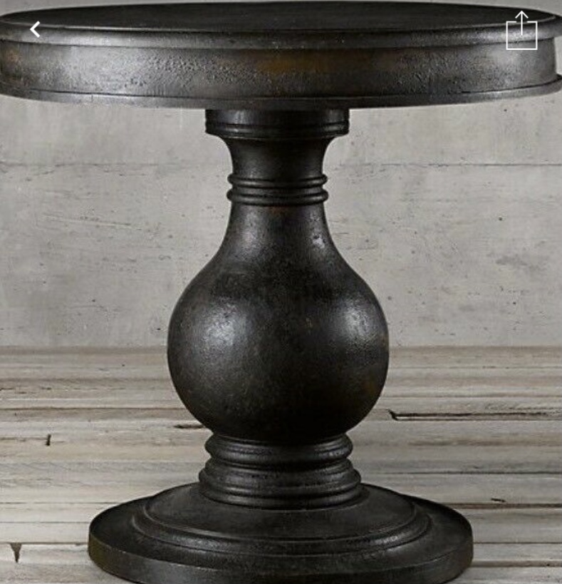

I am learning how to turn wood and I am trying to understand the movement of wood in a turning. It was mentioned by others to glue up segments and then turn the piece, having the inside hollow.
So my question is how would you build this table?
View higher quality, full size image (789 X 819)

Three section. Top, center and base. The center will be the skinny section of the turning. The base will be the lower sections that comes up to the center, looks to be 3-4" tall.
Probably be easier to make it solid, just laminate a long square wood section, miter off the corners before you put it on the lathe. Let the wood sit for at least three days after you glue it up to let the moisture from the glue evaporate out, or use a non water based glue such as an epoxy if you need to turn it more quickly.
3/30/21       #3: How would you build this? ...
The larger the solid, the more likely it will open a crack later.
Three pcs: the top (conventional methods), the Base - turn on a face plate with a mortise for the vase, and the Vase, stave built.
Draw the major diameter of the vase, and draw the minor diameter. Then draw the inside of the vase (arbitrary). Make your staves from that. The top will be solid, but the lower end will likely be open. Glue the staves up and turn 'em, leaving a tenon at the bottom and top.

Thanks for the input, I am not planning on building this , I was just wondering how for some other projects I have planned. I really appreciate your knowledge of wood and wood construction and movement David.
I have built cabinets for around 30 years, I can build a kitchen to perfection, I have done a ton of veneer and miles of cabinets built out of plastic laminate for commercial projects.
I however will be the first to admit I haven’t done much solid wood work other than cabinet doors and mouldings. I am trying to learn more about the movement of wood and the different construction methods for things like turnings, tables and front entry doors and frames for a really dry cold climate. I would like to build a new door for my house, but I have no idea on where to even start. So I really appreciate others input:

Wood movement is not a concern for turnings generally speaking. The traditional, and correct, way of building that would be solid for the center section turned on the bed. The base and the top would be turned outbound and all joined with tenons. You could use solid for everything.
