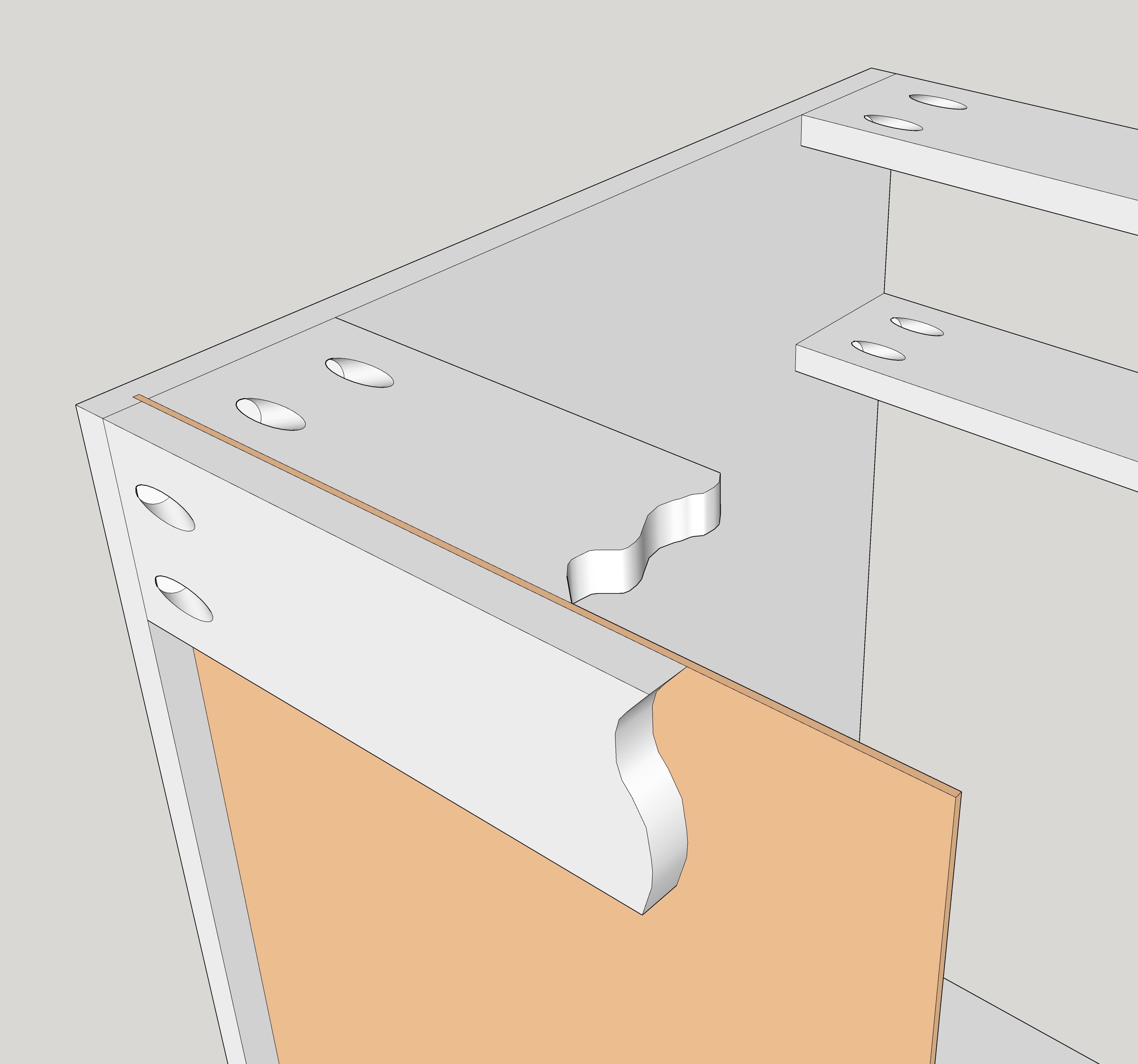

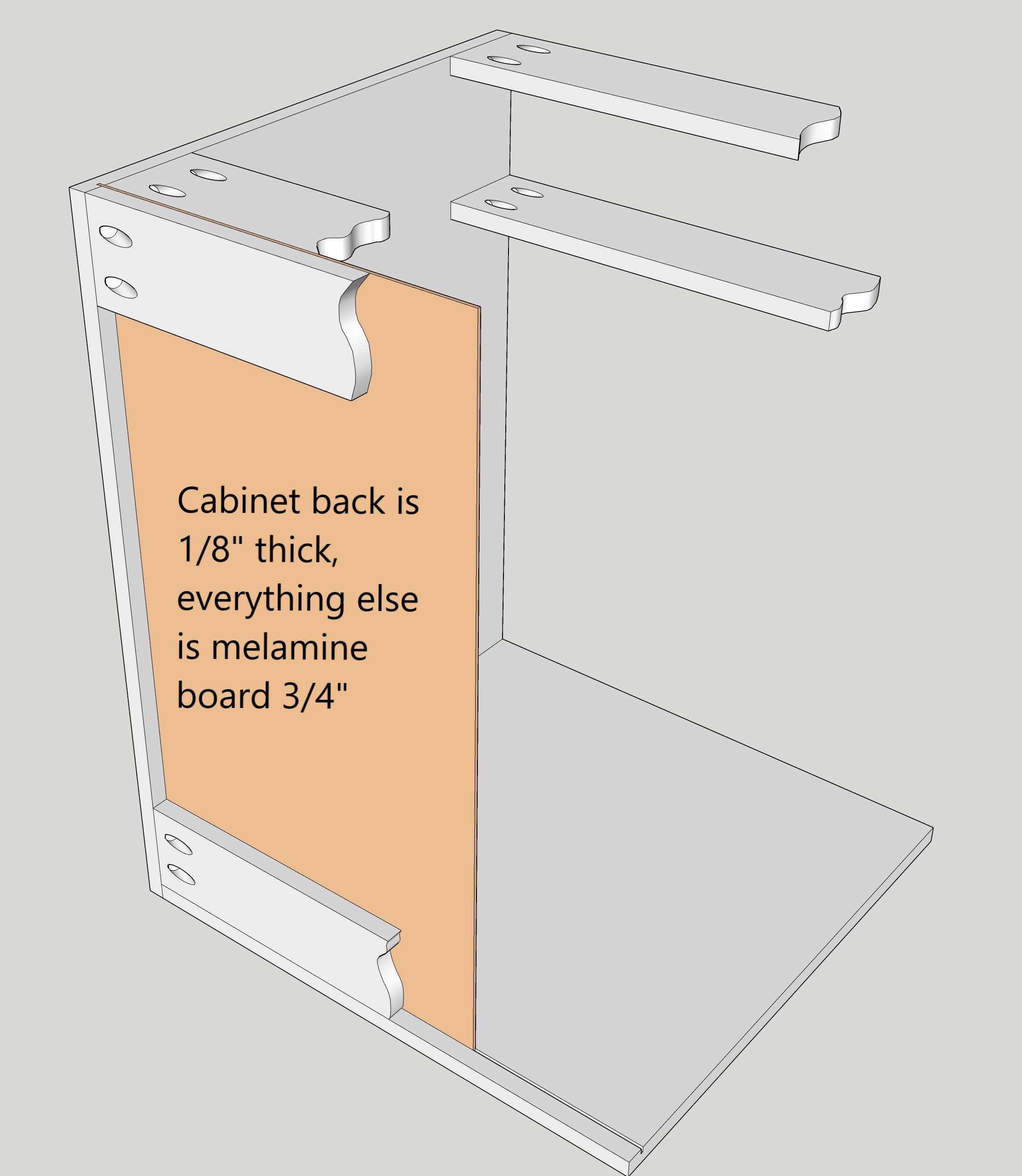

The way my current cabinet cases are made can be seen on the attached pictures 1 and 2 (example of a base cabinet with one drawer).
It is somewhere in the middle of where I started some time ago and where I would like to arrive soon.
I use pocket holes on the nailers only if the side of the cabinet is visible after the installation, otherwise I just run the screws from cabinet sides.
I always use pocket holes at the front spacers, since I've made a jig to position them quickly and hold firmly in space while driving the pocket hole screws into them, so it's faster then driving regular screws from the "outside".
So, the goal is to avoid screws and to be able to assemble everything with only dowels and glue and than put it into case clamp. Maybe a nail gun for the cabinet back, but if possible would like to avoid that too.
Boring dowel holes for tops and bottoms and even spacers on the front of the cabinet is not a problem since the machine is made to do that in the first place. To accommodate it for drilling holes for front spacers at different heights I can move the vertical boring fence on construction boring machine to the back, and than use different spacer blocks to position cabinet sides for drilling the dowel holes where cabinet tops, bottoms and spacers need to be, without a need to actually adjust the machine's fence all the time.
But the challenge are holes for the nailers at the back of the cabinet. They need holes going in vertical direction.

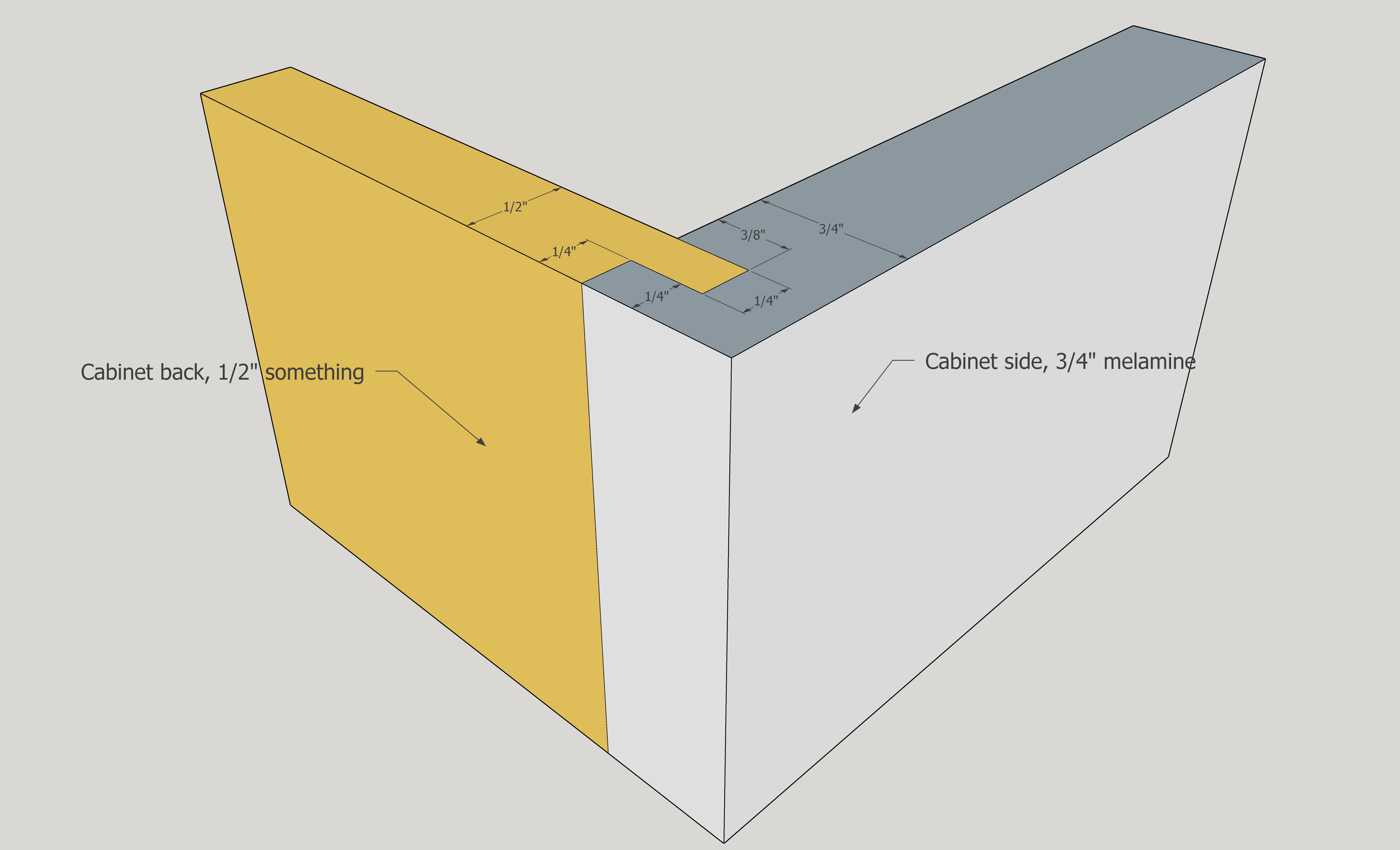

I'm thinking of using 1/2" thick backs and avoid nailers all together. The joinery would be a combination of dado on cabinet sides and bottom and rabbet on back piece. The illustration of this is on the picture 3.
If you think this is ok, what kind of sheet material for the back would you recommend? It needs to be white to match the rest of the cabinet interior made of white melamine.

I was leaning towards 1/2" back without nailers, but you just hit the nail on the head with that dado set 1/2" from the back. That way there's no need to cut rabbets on the backs and the possibility of using wall hangers is a huge benefit. I had that thing on my ToDo list for a long time, but somehow just forgot about it. Thank you for remanding me and providing the elegant solution at the same time.

Without nailers at the back, everything seems much simpler.
So, the current plan is:
1. Cut everything on a slider.
2. Cut all dadoes on cabinet table saw. This will be much faster than using my small CNC for that one piece at a time.
3. Edgeband.
4. Drill dowel holes on construction bohring machine, both vertical and horizontal.
5. Drill two lines of 32mm holes for hardware.
6. Assemble.
7. Put in a case clamp.
For start I can use CNC to drill 32mm hardware holes in cabinet sides, but most likely I'll get a dedicated two head line boring machine just for that.
If anybody has any objections or knows of something better than speak now (i.e. within next few days) or hold your peace for at least year and a half :)
