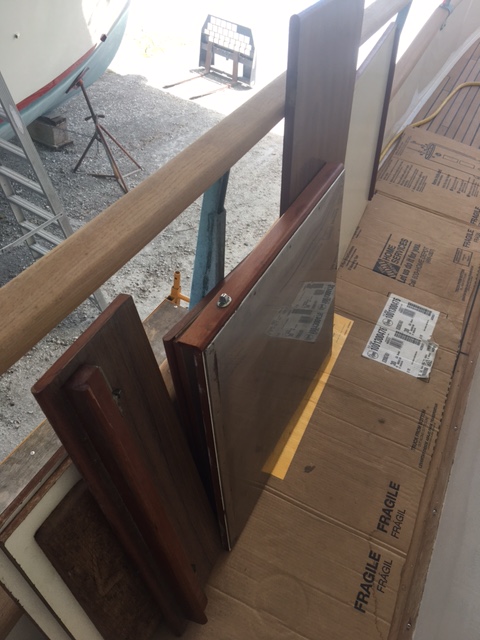

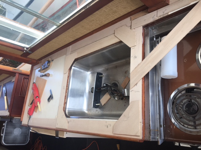

A tops (horizontal surfaces) are getting covered over, a lot of pattern making. What i normally do is make a stick pattern, from that make a 1/4" ply pattern ( and check it for fit) and overlay an oversized rough cut laminate to it (using double sided tape) rin the flush cut bit around with the trimmer.
The tops can not come out and there is a fiddle those, some are hinged and lift up so I removed them and take them to the shop.
The choice by the owner is not available with peel coat, there is also a problem that it can't squeeze up the sides where it meets either.
The ones with the fiddle (which can't be removed) are the problem. The laminate has to fit exactly down between and fiddles and around other things with no addtional trim. No chance to be taken trying to use contact, it's a one shot deal, if off by 1/32" when starts to go down it's satrting over with a mess.
Now the thought once i find the right adhesive is to use the 1/4" ply pattern on top and weight it down all over with ??

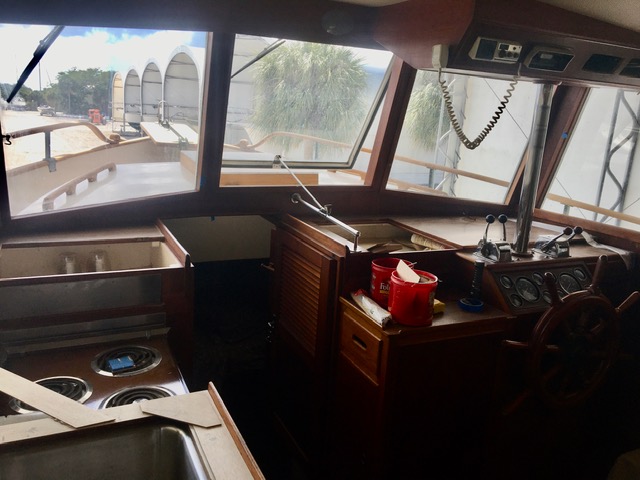

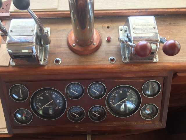

Need to also fit around all those guages...I know how to pattern around them for an exact fit ( they can't come out without a lot of time and work.)
Maybe somebody has a better idea that I. I figure it would take me 4 hours to make the piece to go in there. 12 to remove them all and get the piece in and put it all back together.

Your last post, with the photo of all the fittings that the HPL has to 'fit over' did it for me.
That simply is not reasonable to ask of any craftsman. If it is a lot of work to remove the fittings, so be it. It is a lot of work.
He is asking you to jump into a job that cannot be done well or even satisfactorily, and is hoping you will save him some money by sweating details that cannot be resolved.
