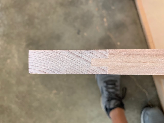

edge sanded shaker door

Rodney,
How are you cutting or sizing your doors?
The picture you posted, to me there appears to be tear out, or at least that’s what it looks like to me.
I would maybe try making your doors a little long and cut them down to size on a sliding table saw if you have one.
You could put a coat of filler on before you edge sand, maybe something quick drying. I am not a fan of edge banding solid wood, especially the end grain like that, all your movement in your wood is parallel to your edge tape.

TonyF
Rodney:
I agree with Scott, it appears that there is tearout on the rail component, almost as though the rails were left alone after machining, where some tearout occured, and the stiles were flush trimmed to the rails, with none of the rail being removed in the process.
The result appears such that while having been sanded, it is not necessarily smooth, as any paint would not fill those tearout areas, and they would stand out once everything was the same color.
As Scott mentions, you may consider making the doors a bit larger in all directions, and trim the doors on a panel saw, or a table saw with a sled, such that the excess stile and a bit of the rail are sawn off, and then sand the edge smooth after that.

RODNEY BLACKERBY Member
We run all edge's with a shelix cutter head and then edgesand with 120 grit.

Jim H
From the picture you posted, you've still got some end grain edge sanding to do.
I build doors 1/4" oversize, trim 1/8" off all sides on panel saw, then edge sand with 80 grit on four all four edges.
After that, it's on the finisher.
