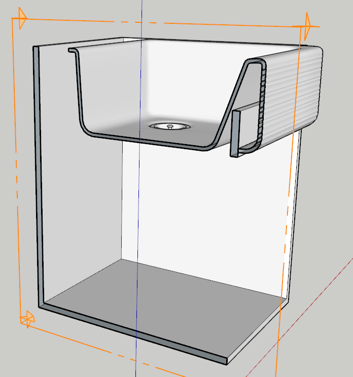

Gene Davis
Well, it's looking as if I can put a stretcher with a finished outboard face across the front, 4" high, and the sink is such that the clearance will be there for the stretcher to reach up in the space between bowl and apron.
At 4", we can do a lock tenon joint and zipscrew this thing in and give nice bracing to the cab sides. The sink glues down onto 2x4 framing that is screwed into the cabinet insides, and the whole thing will be battleship-tight.
Thanks for looking and commenting, and thanks to Kohler for providing accurate 3D for this product, downloadable as a Sketchup file.

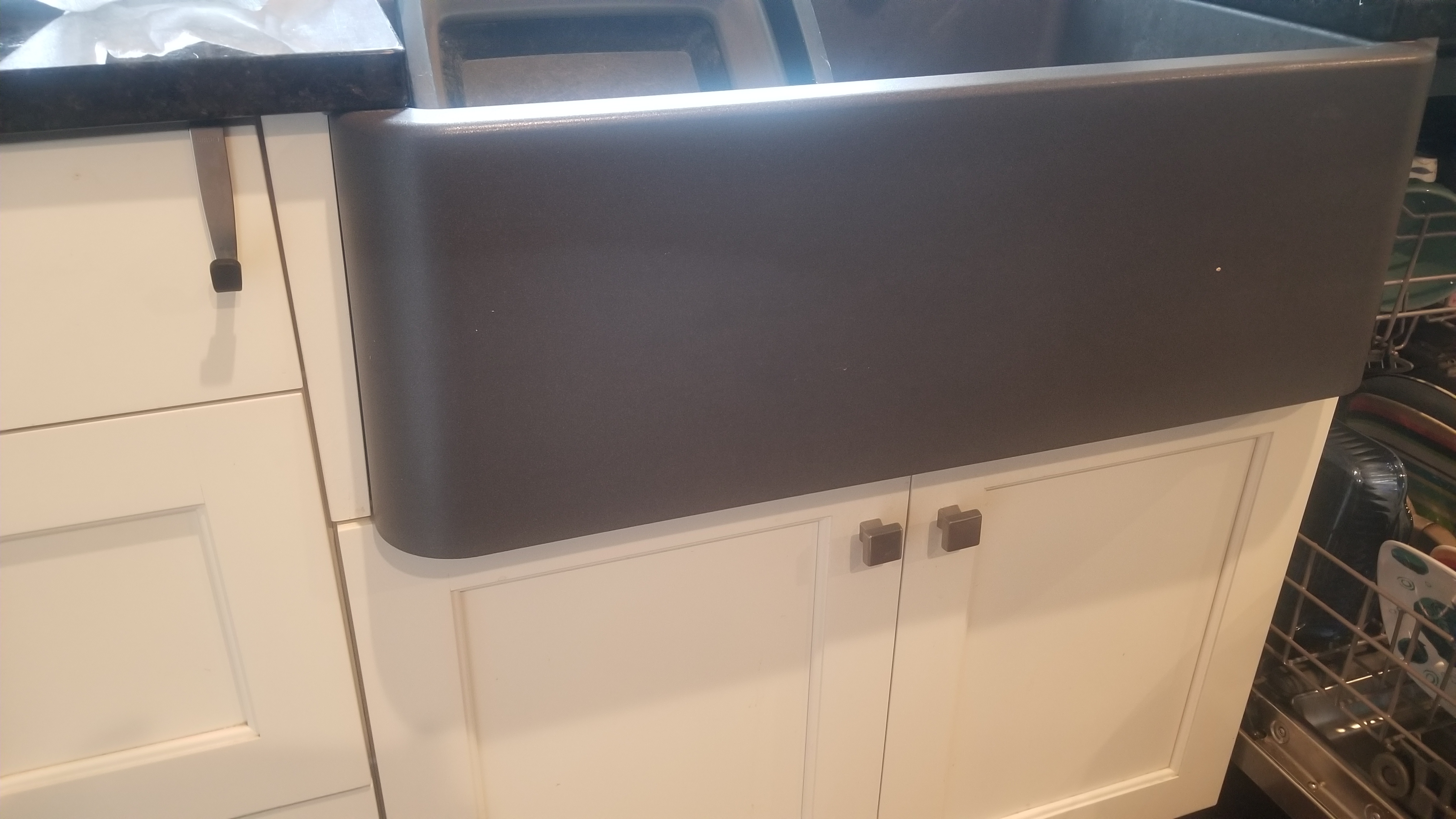

Mark B
I hate to sound like a purist but does "farmhouse sink" and "frameless" make anyone else snicker an laugh inside? So unbelievably odd... But, full agreement, take the cash and make what they want.

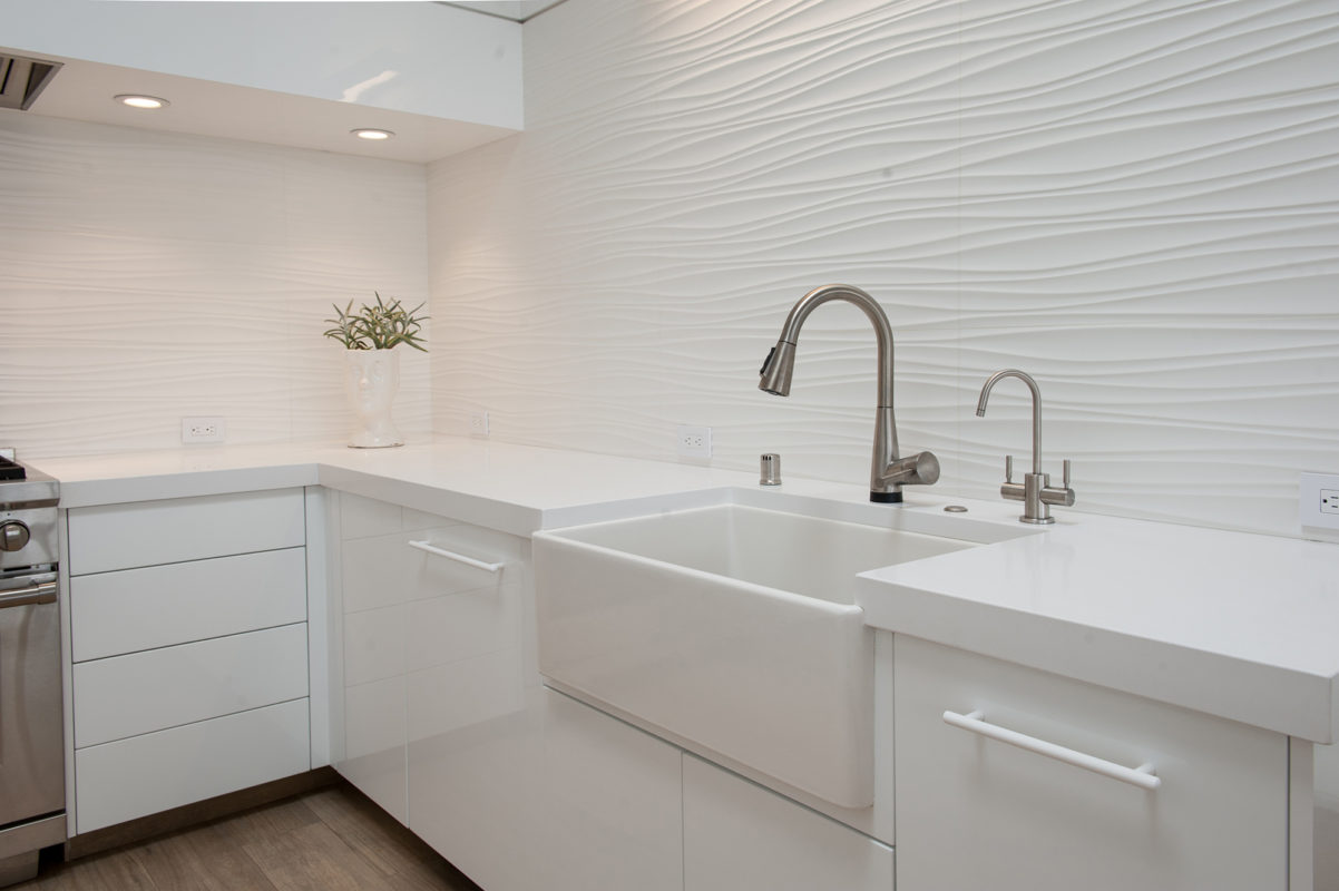

Adam Spees
I'm a face frame guy, unless someone needs something within a house I'm already working on.
I thought with frameless you simply build a short lower cabinet and the farm sink sits on top of it. Obviously you build some structure to support it as the manufacturer specs.
I'm thinking of it like an appliance except you give it a few mm of room to get it into the opening. So the adjacent cabinet doors have their typical gap up against the sink.

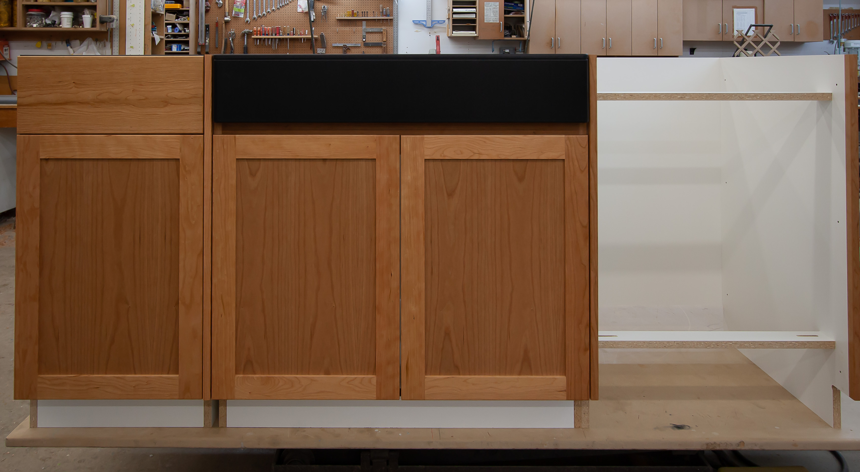

I think we'll widen the cabinet and bring the sink out 13/16" so it's surround is a false drawerfront. Like this.

Bruce H
I do these often enough to have come up with simple construction that works with my frame-less construction. I make a short cabinet that the sink sits on with a top rail that the doors will close on. I make it wide enough so there is clearance under the sink. Some sinks have a lip down and others are flush. There is an appliance trim on each side, or in this case a dishwasher cabinet on the right.
