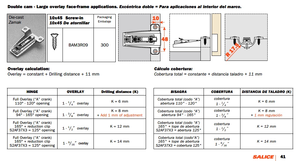

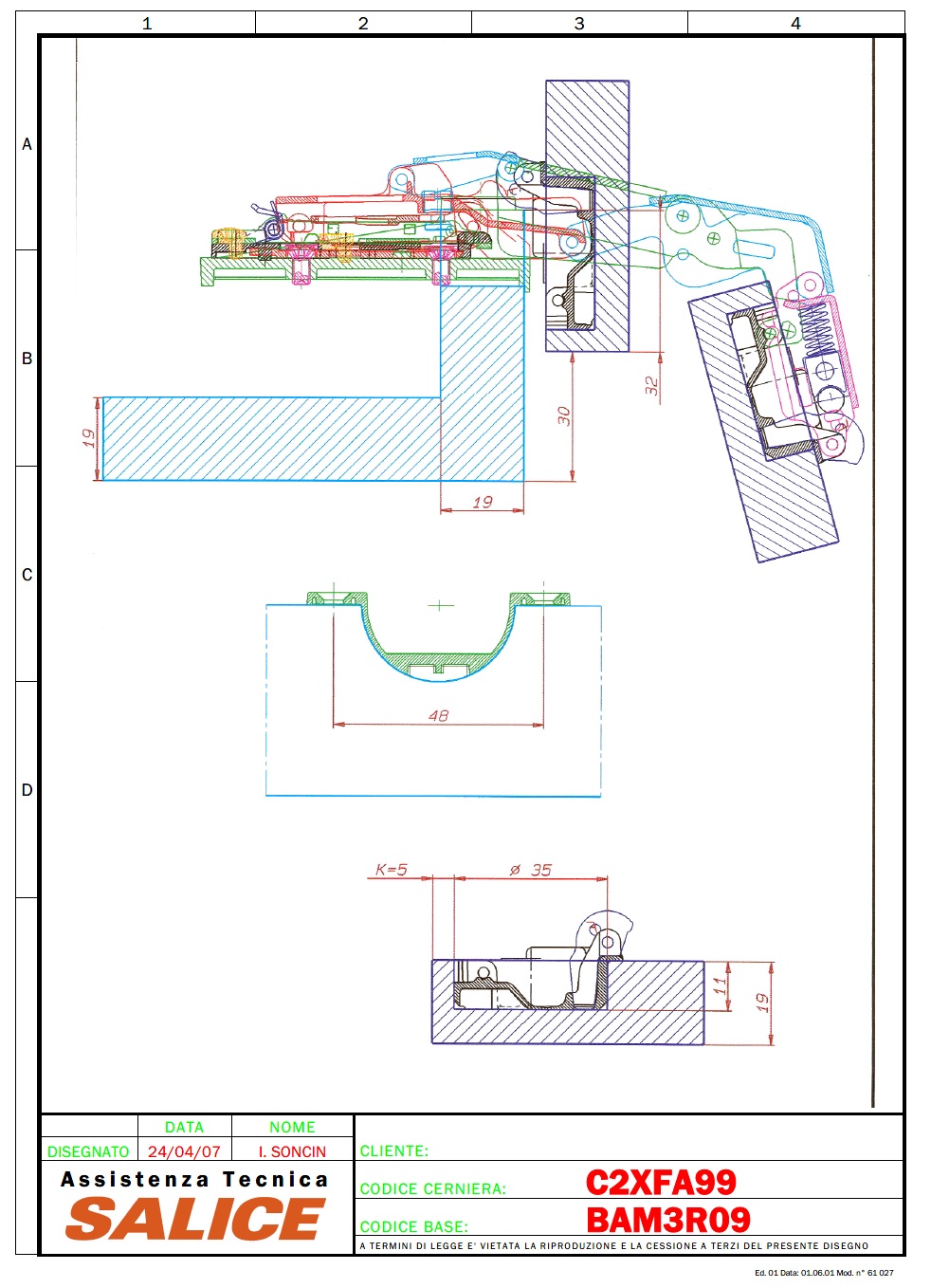

Hey MB,
If you are speaking about a face frame cabinet, the only solution is to scoop-out the frame and recess the mounting plate.
Salice offers a mounting plate perfect for this. With this plate you first bore into the frame 17,5mm ( half a hinge bit diameter). You would use your hinge machine for this operation.
You then put the plate into this half-moon cut-out and attach which ever, full overlay soft close hinge you like. 110 or 155 degree.
C2RKAE9 – 155 degree soft close
C7R6AE9 – 110 degree soft close
Your hinge bore from the edge 0f the door would be 6mm. You can easily maintain your 1/8" gaps.
Of course, this operation is best done prior to assembly of the face frame. I know many shops that use this method for the pie corner cabinet.
Here are some details.
Best of luck,
Dennis
View higher quality, full size image (953 X 516)
View higher quality, full size image (982 X 1358)
