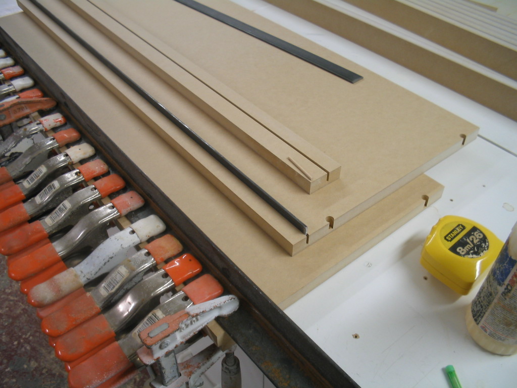

I'll have to disagree with Mark, a trapped/glued 1/8x1" steel bar on edge will add significant stiffness to any shelf. Making the slots 9/16" deep and using 3pcs of 1/8" dowel (top/cntr, bott/ends) during glue-up will add a bit of camber (think tractor trailer flat bed).

If I had the machinery and the budget, I'd use solid hardwood shelves. With my equipment, a stacked and banded or painted edge is the easiest and most aesthetic. Adding steel reinforcement on long spans is easier, more aesthetic and effective than an applied 1x2 hardwood edge.
The problem with the Sagulator is that it doesn't account for time. Heavily loaded shelves will gradually sag more and more over time (particleboard and MDF in particular). It has taken over seven years for my heavily loaded and unsupported 48 x 12 x 1-3/4" MDF torsion box shelf to sag 3.5mm. A similar (1.5" stacked edge, lighter load) steel reinforced particleboard shelf that is at least twice as old hasn't gone past 2mm for over seven years. The later was probably before I started pretensioning the steel and was a lot easier to make. The labor costs on the former were probably the equivalent of using plain hardwood.

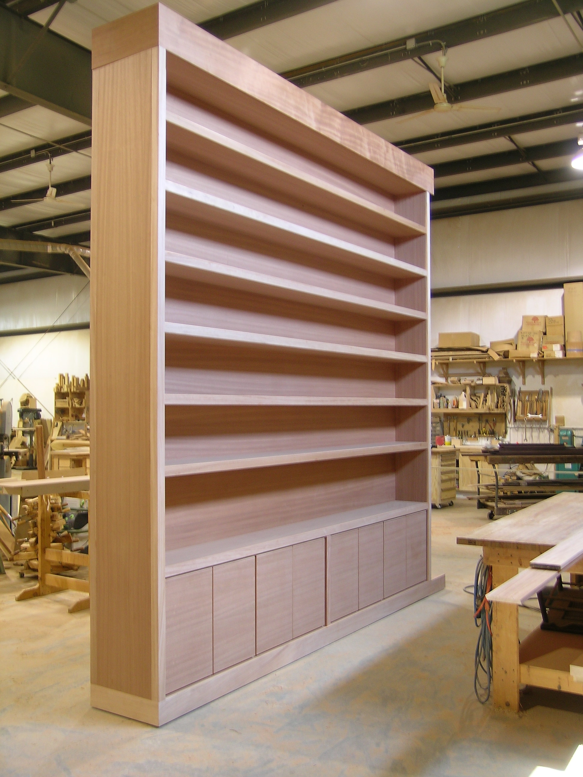

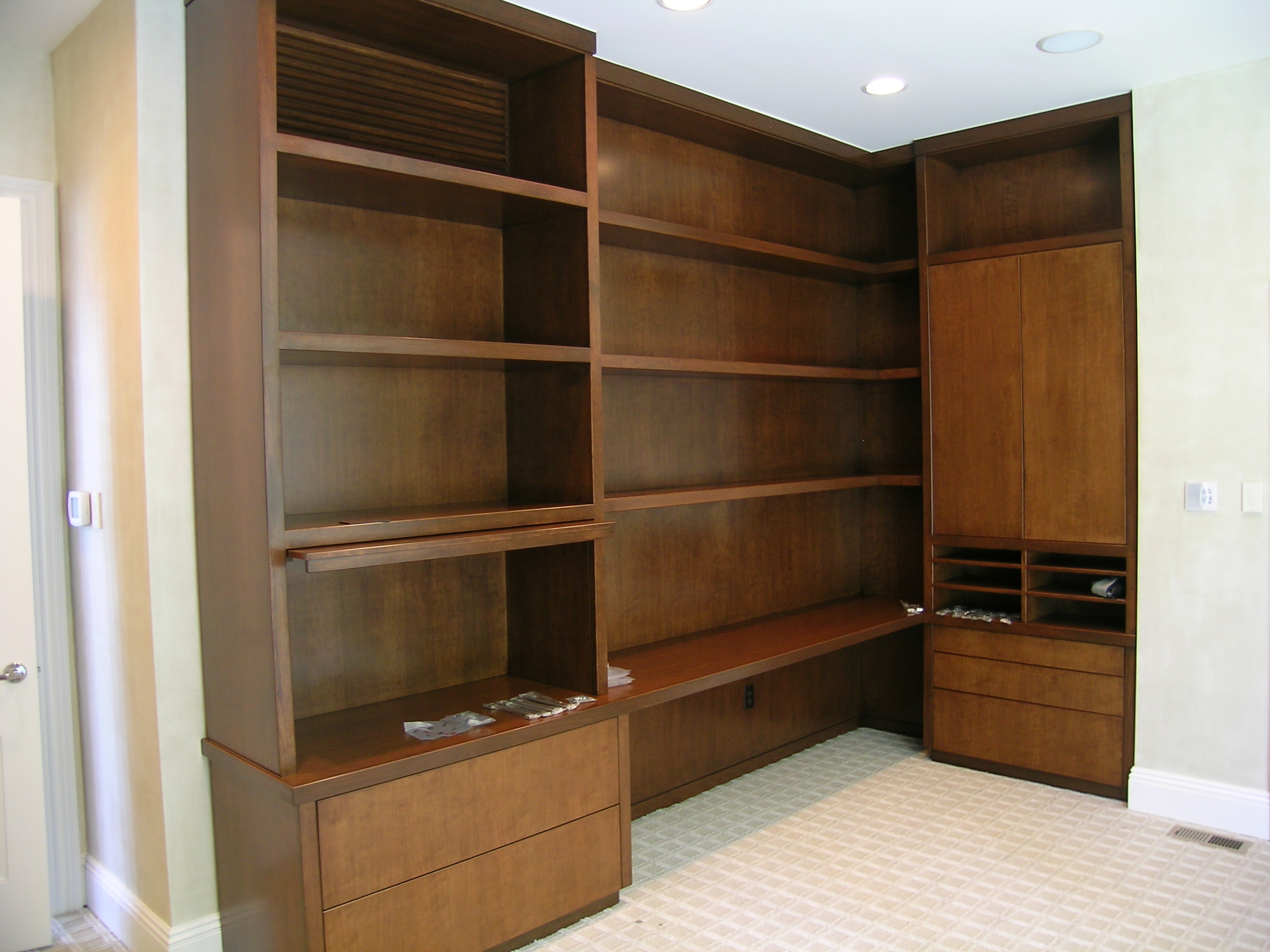

The cabinets in the photos are both torsion boxes of 1/4" MDF, ply 2 sides, with a solid rabbeted nose of solid wood and a solid spine down the center and one along the back. I think they were 1-1/2" or 1-3/4" thick. The back edge tongues out thru the backs and catch the 1/2" back panels, giving 100% support along the back. When I sat on one of the long shelves, my svelte 280 lbs deflected the shelf less than 1/8".
