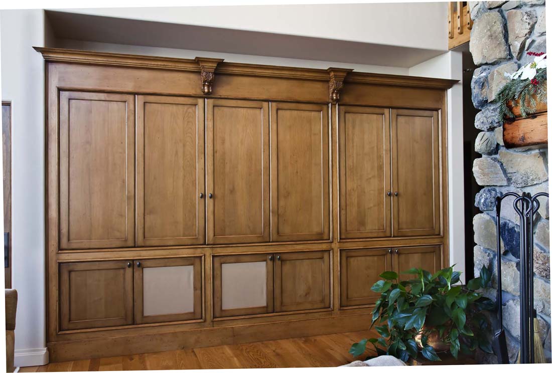

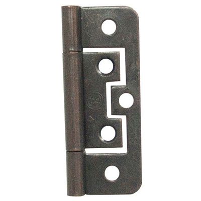

I've done this a lot with non mortise hinges for bi-folding pocket doors for TV cabinets. I mount them on the back sides of the doors with a 1/16" reveal between them. The doors will fold back completely with only the barrel showing.

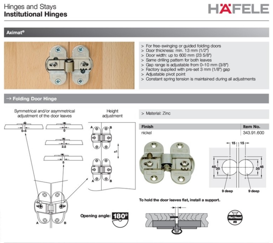

I'd use Hafele Aximat Institutional 270

I second the suggestion of the Häfele Aximat bifold hinge, though I would go with the bifold version, article number 343.91.600 found in the 2022 version of the "Complete Häfele Catalog" on page 9.7. This hinge will gives you quick vertical adjustment of the door and horizontal adjustment of the gap. Scott
