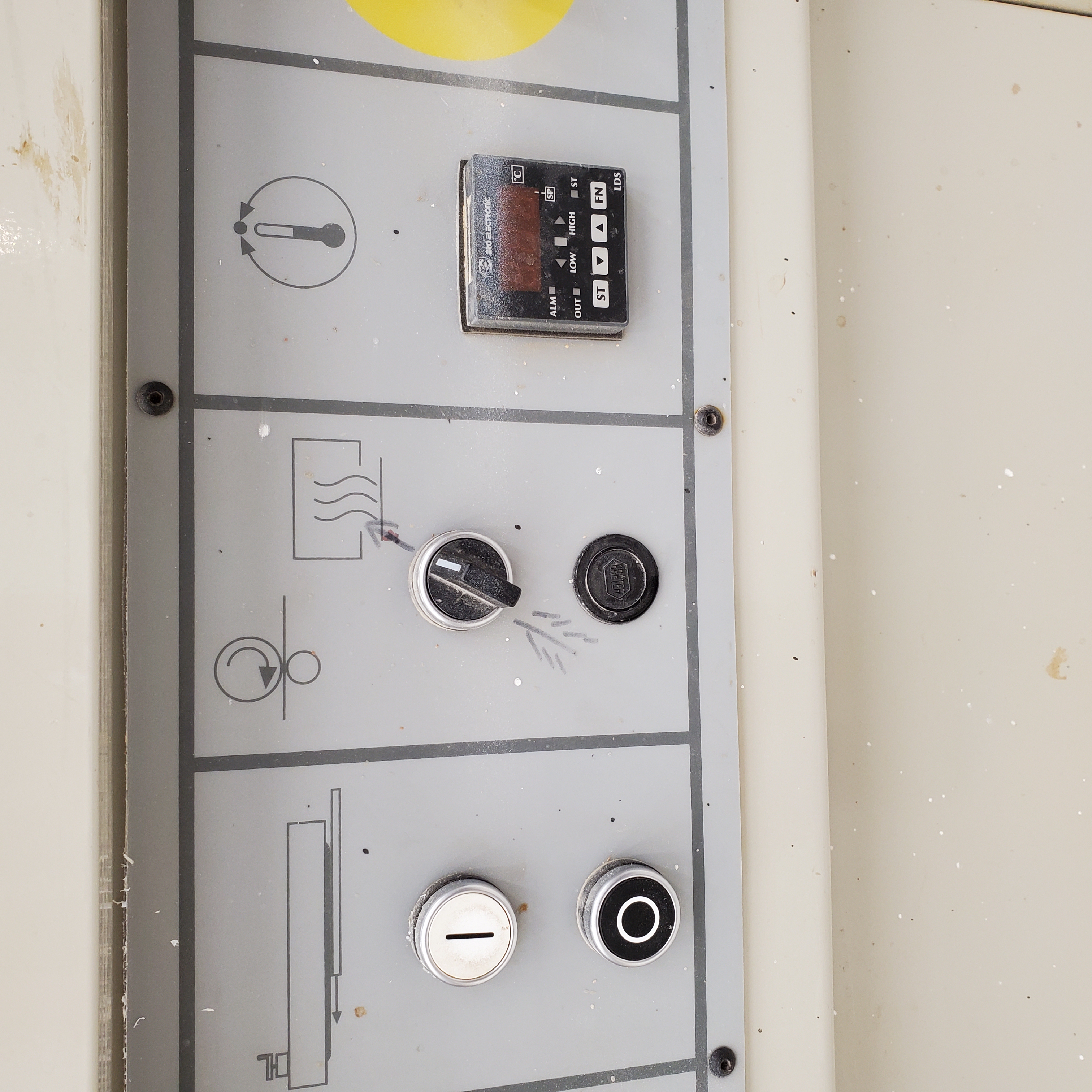

Also make sure this switch is turned to the right where I have the arrow drawn

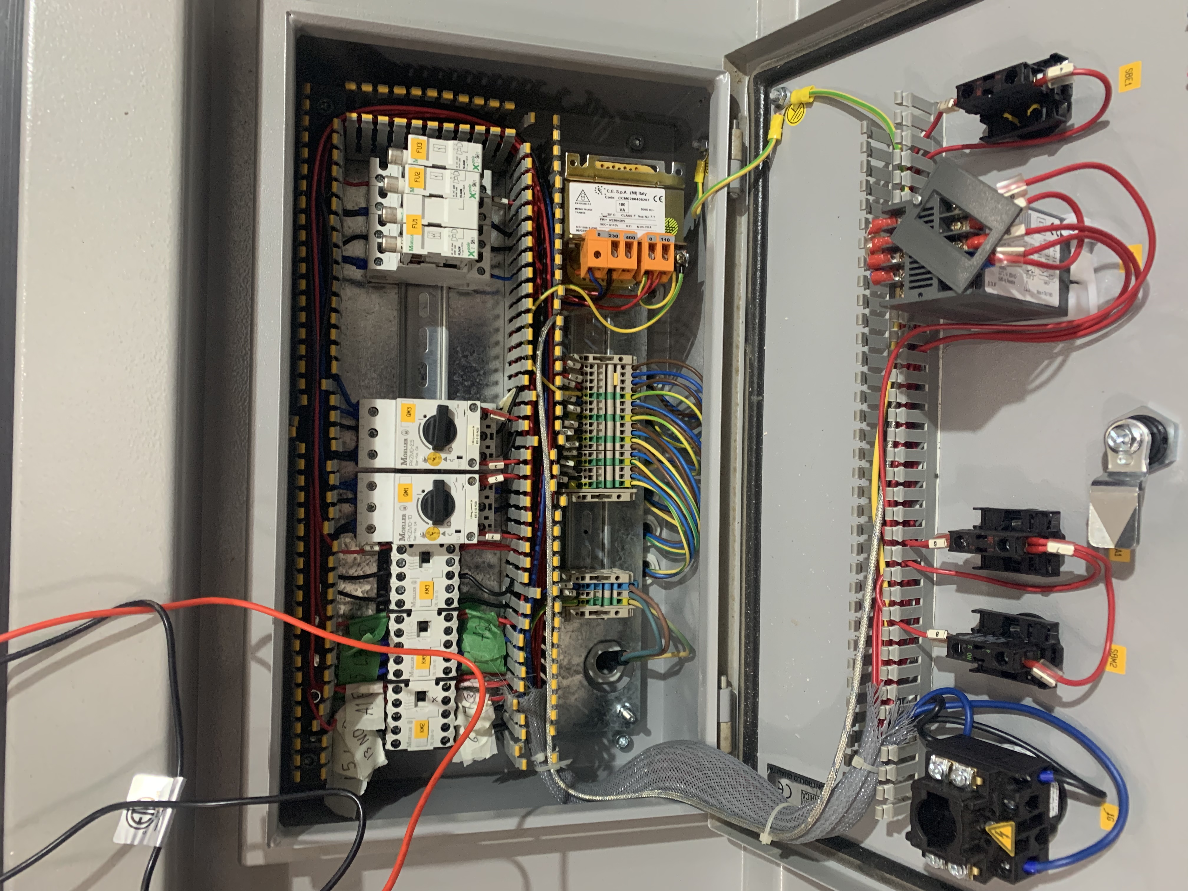

UPDATE: I have tested everything and the only unusual thing I have come across is the elements are only receiving 90V but I can’t determine if that’s right or not. I have included a photo, maybe some can give me an idea where to go next?
