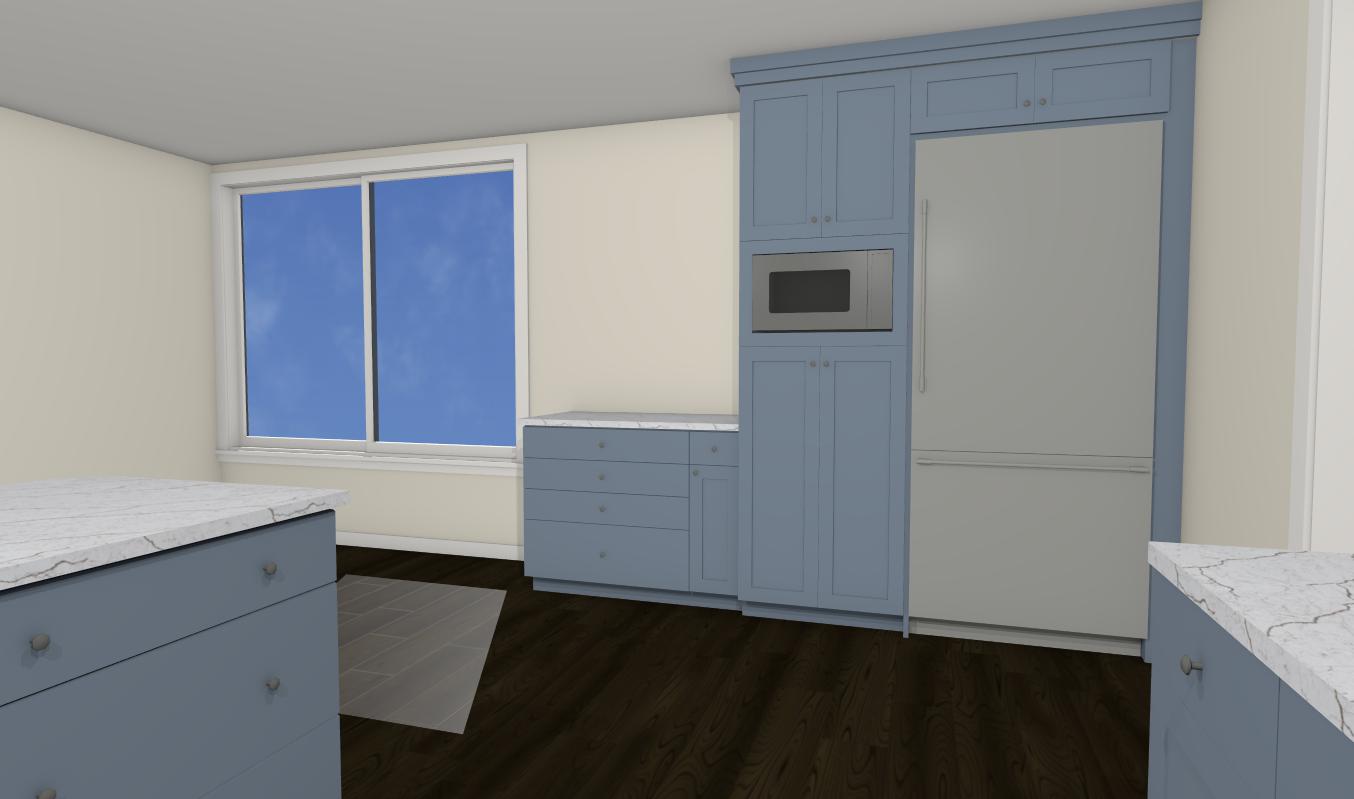

Got experience with these, as in how the customers view quality, use, and longevity?
The tall cab to the L of the built in fridge is planned to have two side-by-side units, the box being frameless, the carcase with no center divider, and when closed, the 3mm margin between doors is expected to stay same and parallel for years of service.
The alternate of course is roll-out trays, which means one has to open both doors to 90 or more, and pull a selected tray.

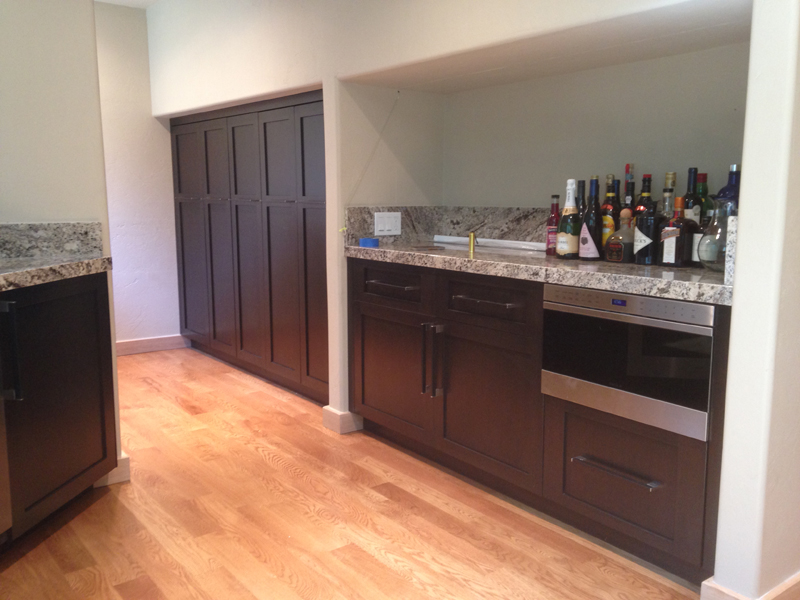

I installed 4 of those in this kitchen we built about 4 years ago. They have worked well with no call backs or complaints from the client.
However, to keep their alignment when opening and closing, these units rely on felt glides to keep the unit square as it opens and closes. You will need a center partition for the glides to rub against if you want to put 2 of these units in one cabinet.
We built a separate box for each pullout in this case. I've also used several of the shorter units for base cabinets lately and had no problems with them.
The customers seem to like them. I however question how useful they really are. A bank of drawers provides more storage then these units, and you don't have to pull out a 100 lb unit every time you want to grab a can of chili.
