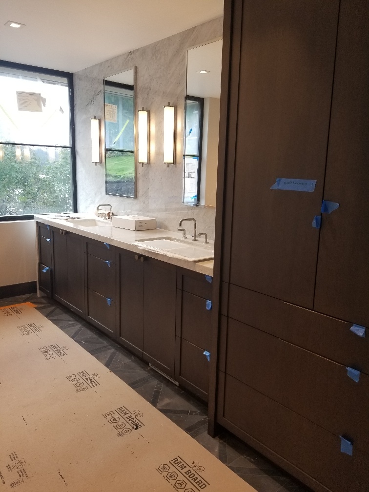

I've attached an image of a bathroom we built using the 1st method. We managed to get away with it in this room, but weren't so lucky in another area and had to replace all the fronts using method number 2.

Thanks a lot for your response. Your Cabinetry looks awesome. I had a feeling stability was going to be a huge issue with this design. Thanks for confirming it and sharing your work around. Totally explains why you don't see anyone else doing it that often!
