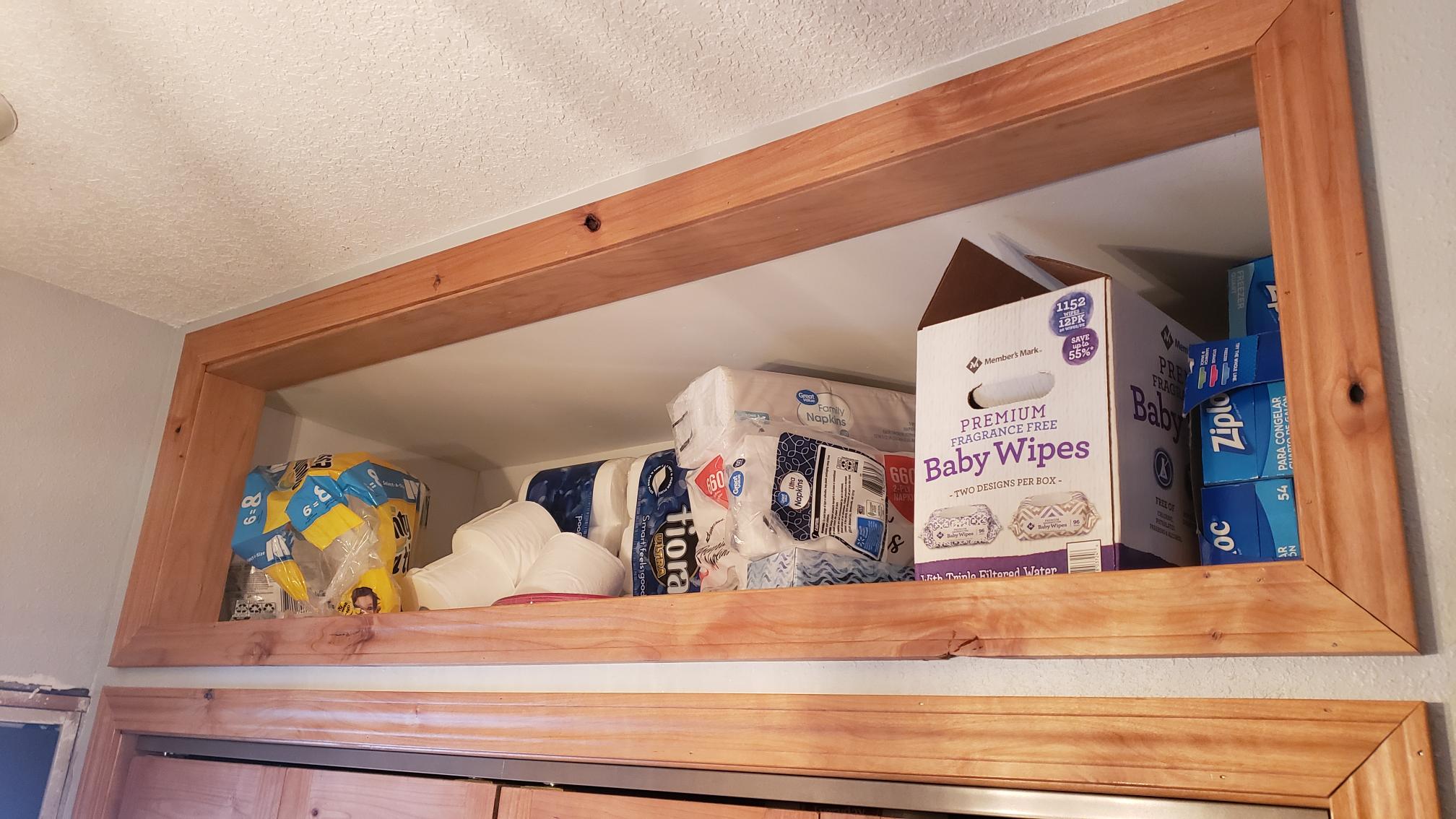

Thank you for chiming in Chris. I have included a pic of where this flip up panel is going. As you can see there is a jamb that will serve as the the connection point for the lift up panel. I am currently planning for the panel to be inset & flush with the front of the jamb. I am planning for an 1/8" reveal at both the top & bottom of the panel. I just want to make sure that I have enough clearance for the panel to flip up and not "bind" when lifted. Thoughts?

2/2/22       #4: Aventos HK Top lift mechanism ...
Tom Gafgen
It will clear . Ive done them with similar situations.
