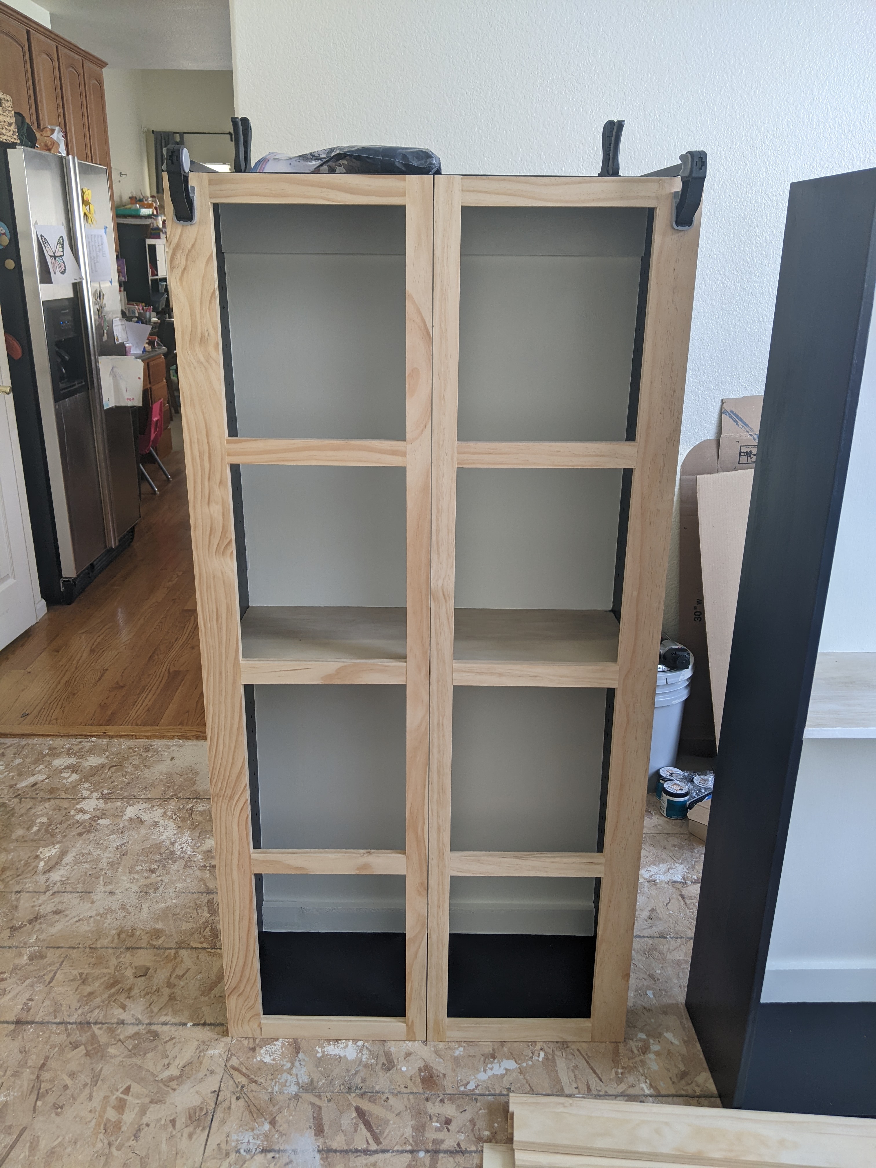

Sorry for the book... I am a newbie when it comes to cabinet making (first time) and just finished assembling 2 of the 4 cabinet doors for these 60x30 cabinets I built.

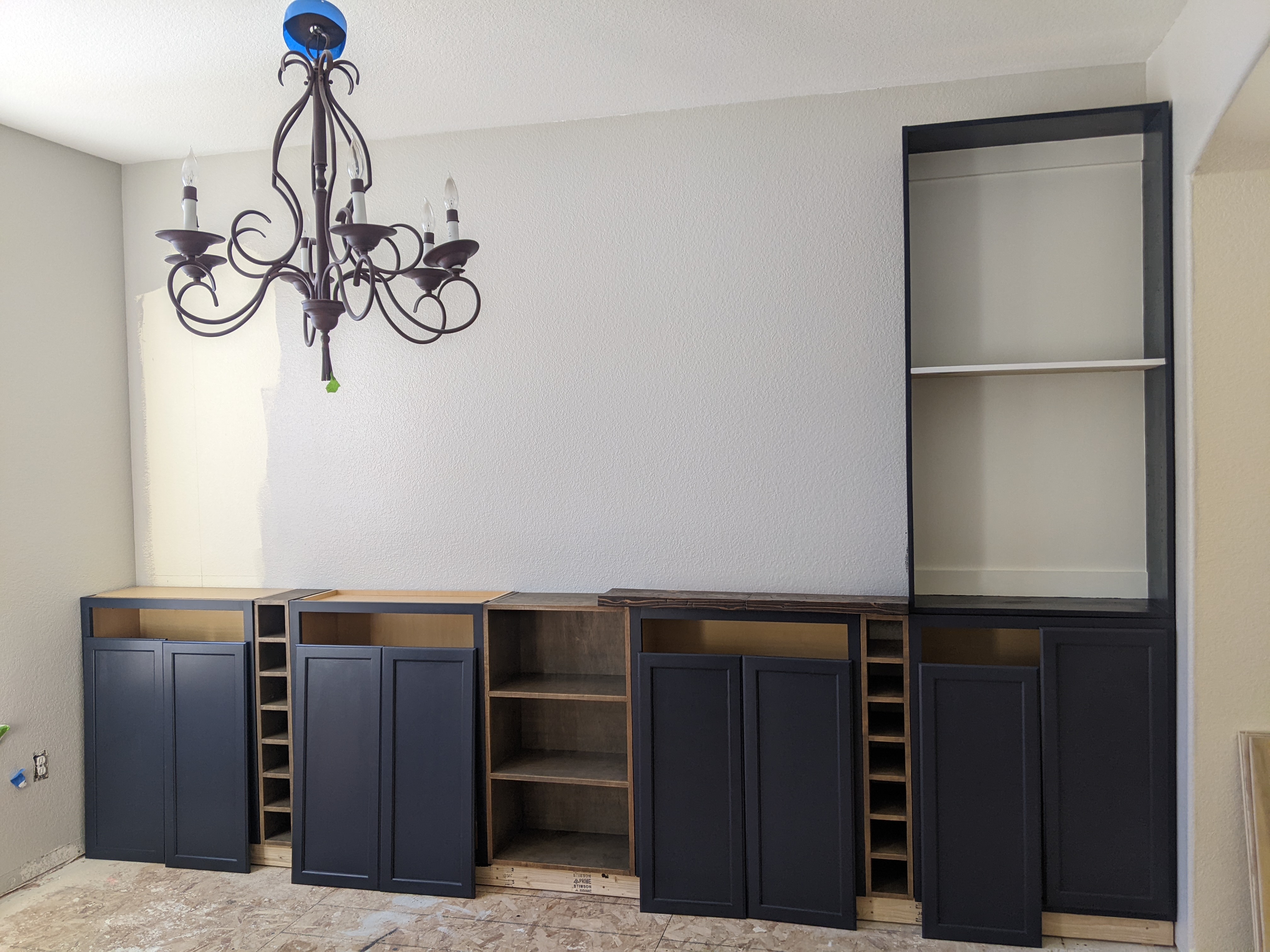

I have a few questions before I pull the trigger with purchasing and installing the hinges. I plan on using Full Overlay soft-close Euro-Style hinges. I didn't really allow much more than 1/4"-1/2” gap between the cabinets and the adjacent walls... Will I run into issues with the doors not opening with that style hinge if they are that close to the wall? Is there a different hinge I could use instead?

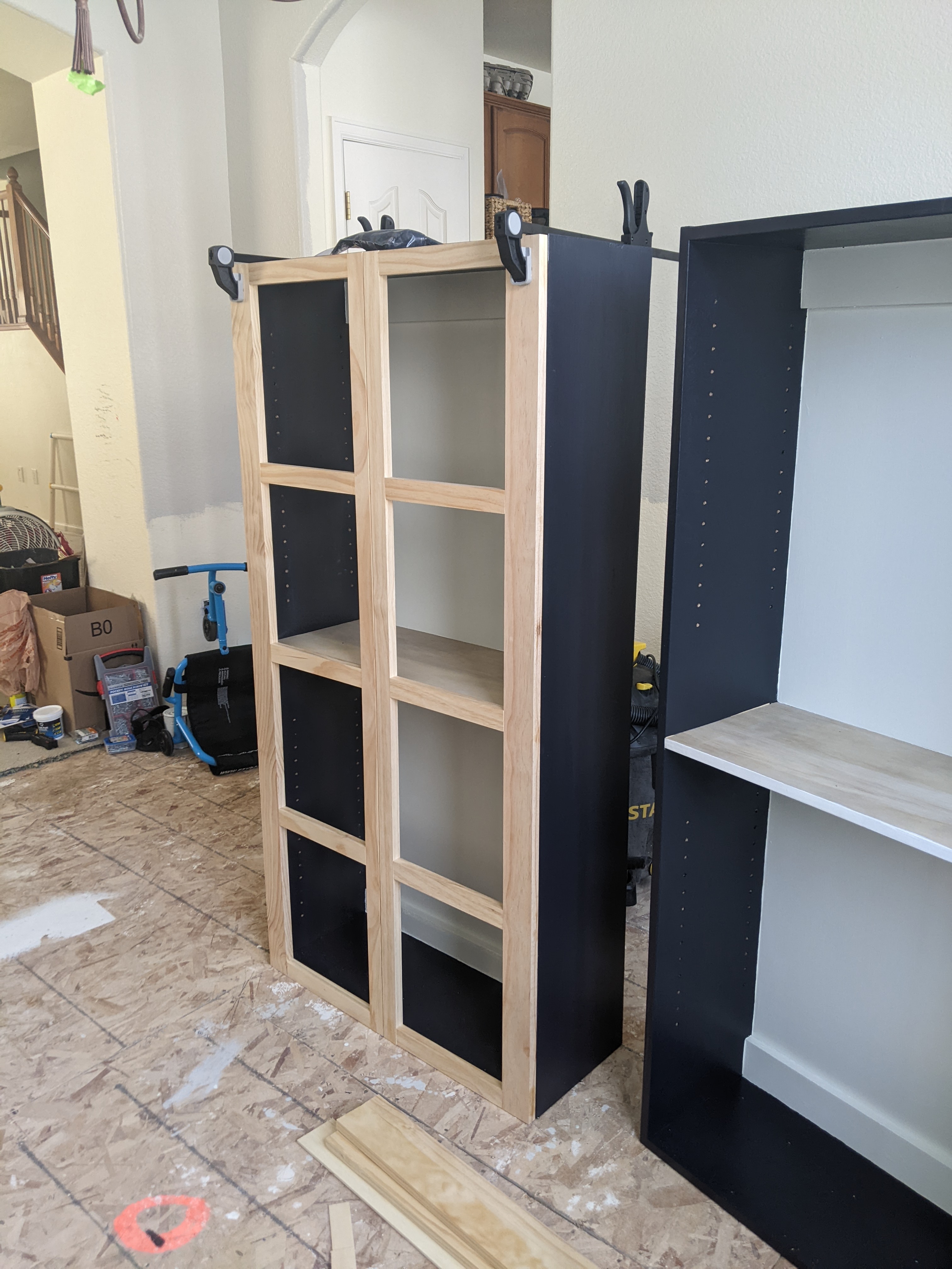

Second question... Being my first cabinet building experience, they aren't perfect. When I cut the dado for the center shelf and attached it with pocket screws to the cabinet (for additional stability), I apparently cut the center shelf a bit short and it squeezed the center of that cabinet in (like a belt). It's not really noticable but since the doors are actually square, the doors do go past the edge of the frame of the cabinet slightly towards the center... Since I'm doing full overlay doors and the frame won't really be seen, am I able to install hinges and perhaps offset the hinges a tiny bit in the middle to counter this difference in width? 🤦 This isn't exact, but say it's 30" wide top and bottom and 29 5/8" wide at the center...
Last question... Do I need 3 or 4 hinges per door? (Each door measures 14 7/8" x 60" pine and will have 4 glass panels per door... ).
Thank you in advance for your help (and patience).

The cabinets look good from the pictures. I use Blum and Salice all the time as those are the suppliers that are close to me.
They sell hinges based on the degree of opening. So for your situation as you are close to the wall you would only need a maximum opening of 110 degrees, and by the sounds of it would be less.
Like James mentioned use four hinges per door and all these hinges have up/down, in/out and side to side adjustments so you could take out the bow with the adjustment screws if it is minimal.

Were you going to get in a little trouble if not using a spacer on the left and right wall you need an inch.
Try opening a door jam tight to the wall it works but the 110-degree hinge wants to hit the wall when fully opened.
I see that a lot with big box store installs.
When I first started I use to make cabinets that tight wall to wall always had trouble.
Cut the open bookcase down, and stay away from pocket screws there is no reason you can't screw straight into the shelf. Add a nice cable on the side and make the doors on top look inlay on the top cabinet
See example there a spacer you can't notice
